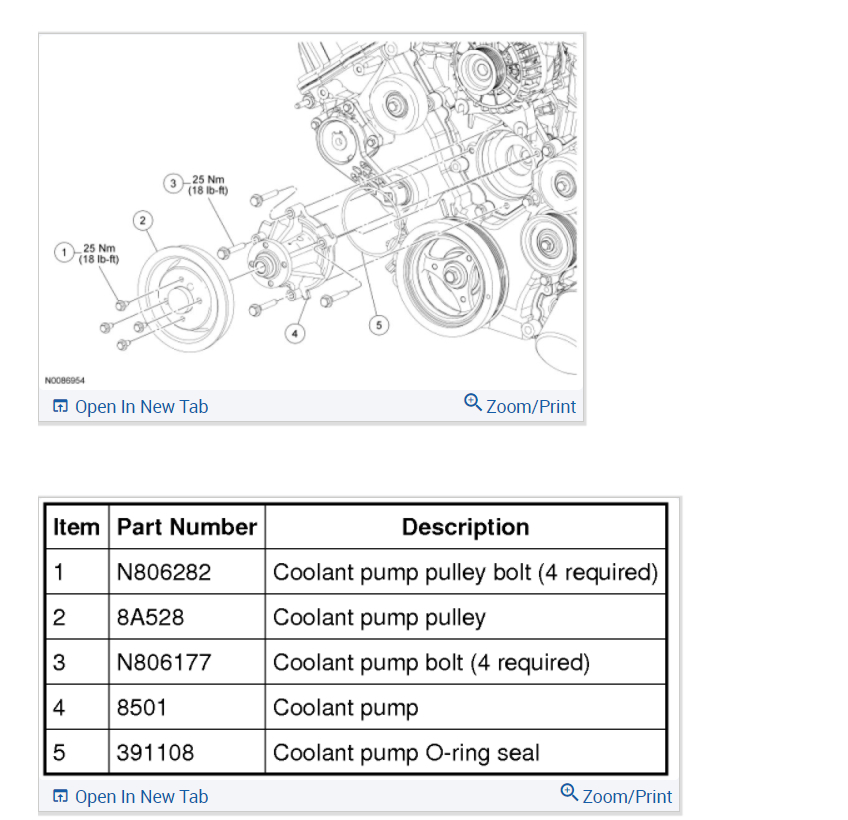

I would release the belt from the motor. I would spin the water pump, power steering pump, and A/C compressor. Check the tensioner and the idler pulleys as well.
https://www.2carpros.com/articles/engine-noises

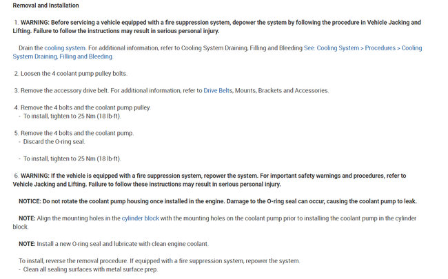

The most common is the water pump. The bearing fails from the tension.
https://www.2carpros.com/articles/water-pump-replacement

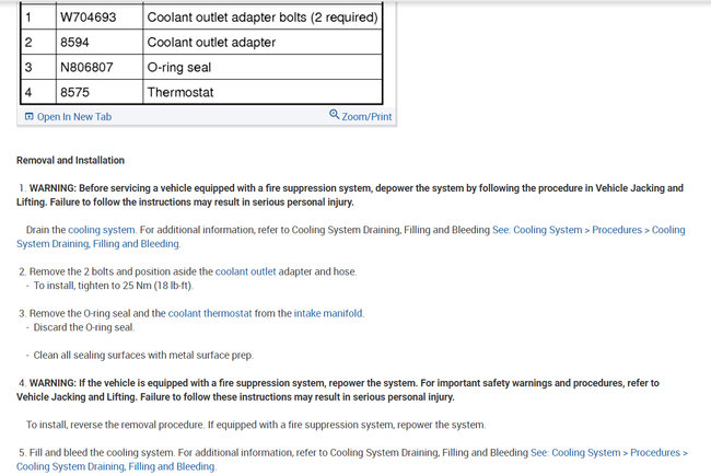

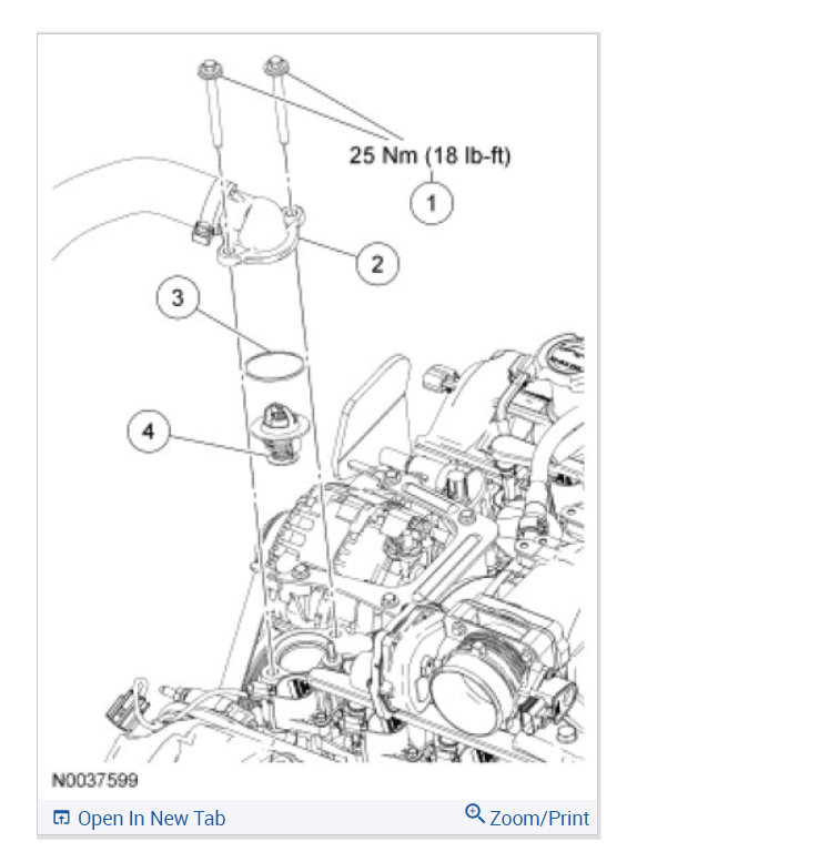

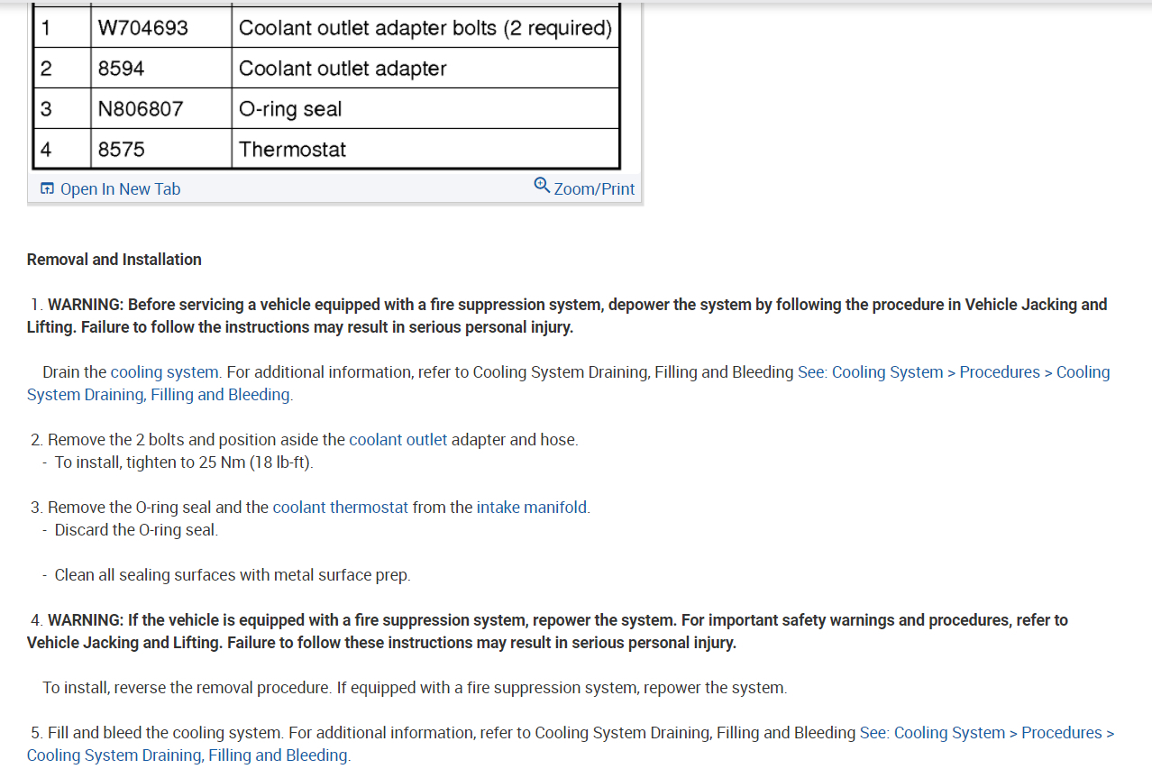

If it is the water pump, I would suggest replacing the thermostat as well since you have the system open. I attached the procedure below for you to view. It is an easy replacement.
