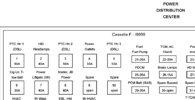

Truck won't start, turn key nothing , dash lights up battery strong, no noise no cranking.
Feb 20, 2019 at 1:30 AM
  • 110,244 POSTS
Welcome back:

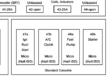

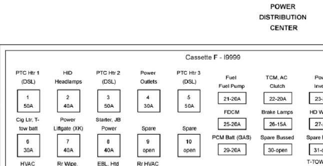

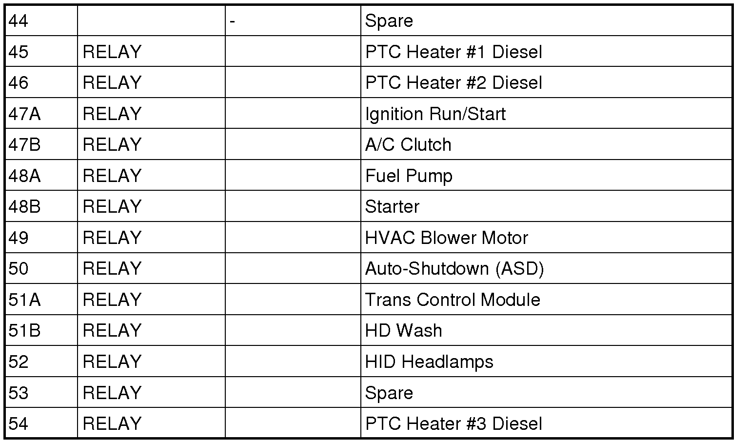

If the battery is good and nothing is happening, I would first check the basics. Check the starter fuse and relay. They are located in the power distribution box under the hood. I have attached a few pics. The relay can be switched with a different relay in the box that has the same part number. If you can't locate one, here is a link that shows how to check a relay:
Here are a few links that show how to use the tools needed to check the relay this way:
___________________
If the relay doesn't make a difference, check the starter fuse. See the attached pictures for location. It is also in the under hood fuse box.
__________________
If the fuse and relay are good, then I need you to check if there is power to the starter solenoid. Here is a link that shows how that is done:
Now, if you have power to the smaller wire on the solenoid as described in the aforementioned link and the starter has 12v direct from the battery at all times (the bigger wire on the starter), the starter is bad.

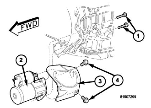

Here is a link that shows how in general to replace a starter:
Here are specific directions for replacement of the starter. The remaining pictures correlate with these directions.
___________________________
3.7/4.7L Starter Removal
Picture 6
1. Disconnect and isolate negative battery cable.
2. Raise and support vehicle.
3. Note: If equipped with 4WD, remove front drive shaft.
4. Note: If equipped with 4WD and certain transmissions, a support bracket is used between front axle and side of transmission. Remove 2 support bracket bolts at transmission. Pry support bracket slightly to gain access to lower starter mounting bolt.
5. Remove two bolts (3) if equipped with an automatic transmission.
6. Move starter motor (4) towards front of vehicle far enough for nose of starter pinion housing to clear housing. Always support starter motor during this process, do not let starter motor hang from wire harness.
7. Tilt nose downwards and lower starter motor far enough to access and remove nut (2) that secures battery positive cable wire harness connector eyelet (1) to solenoid battery terminal stud. Do not let starter motor hang from wire harness.
8. Remove battery positive cable wire harness connector eyelet (5) from solenoid battery terminal stud.
9. Disconnect battery positive cable wire harness connector from solenoid terminal connector receptacle.
10. Remove starter motor.

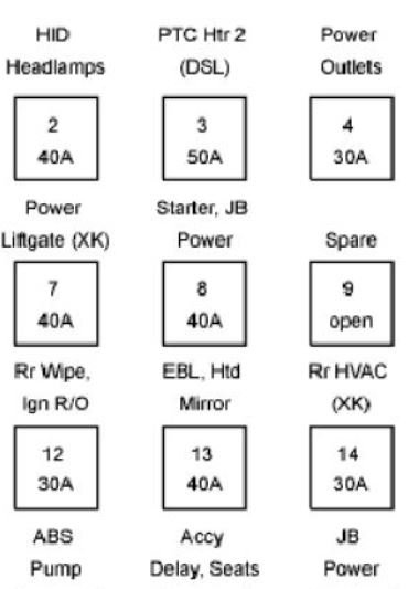

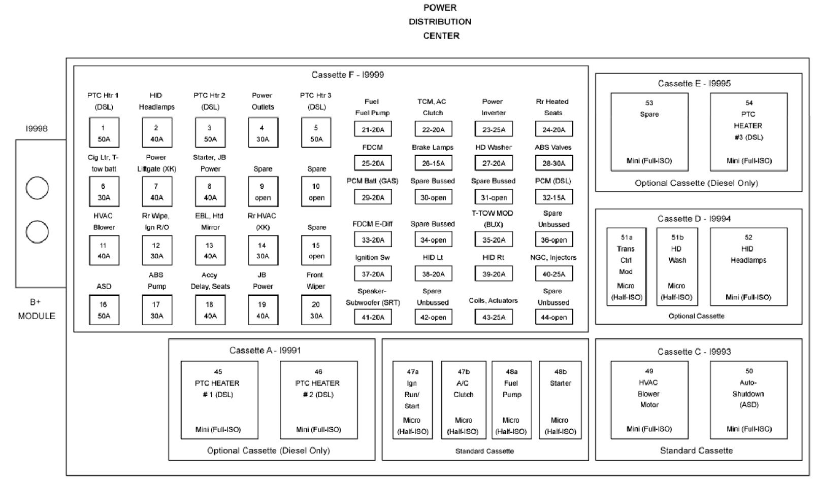

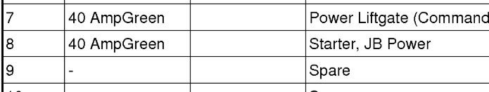

Great, thank you. only problem i have now is the cover doesn't show which relay is starter relay.

As far as what you said, do you mean the starter relay and not the solenoid? The solenoid is on the starter. That is where the wires connect to. The relay is located in the underhood power distribution box. It is relay number 8. I attached a picture for you to see.
