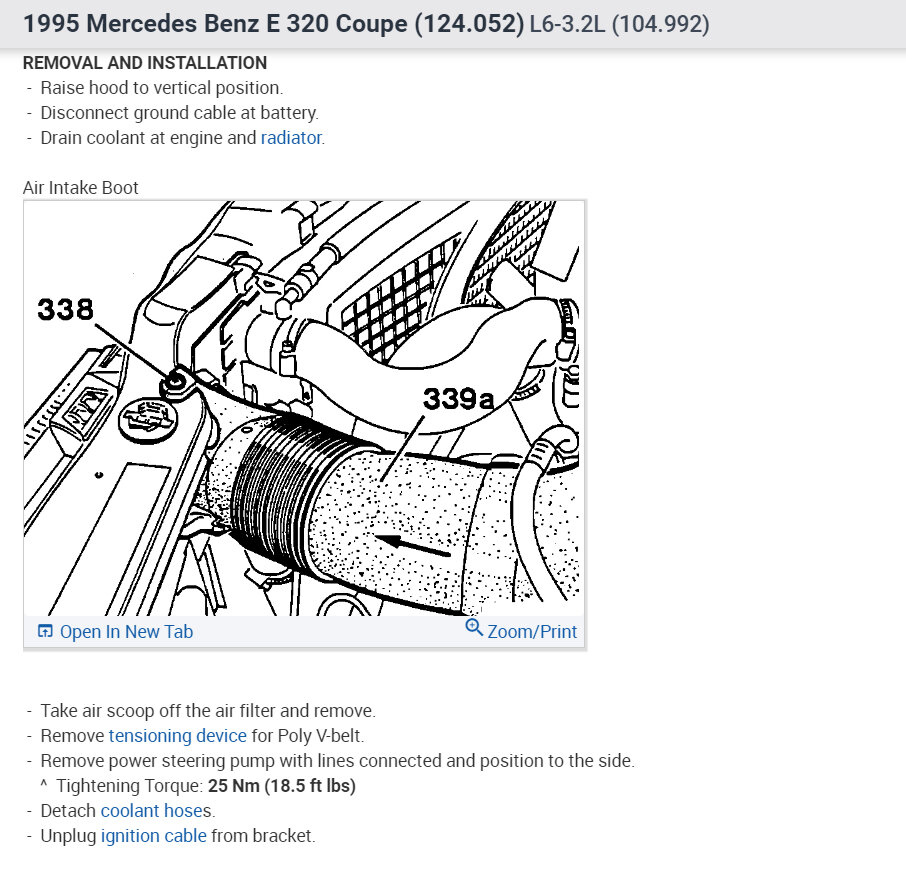

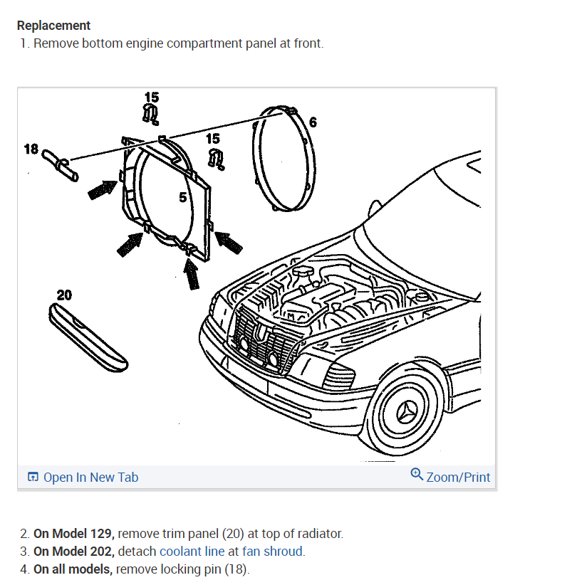

It would help if you uploaded a picture or a short video of what you are talking about but in the meantime, here are images and information on what I think you are talking about.
1. Remove engine compartment vertical cover.
2. Pull fan cover ring pins rearward, then turn ring to lefthand side to remove.
3. Install special tool No. 104 589 00 01 00, or equivalent, between fan clutch and pulley.
4. Remove fan clutch attaching screw, then remove fan assembly.
5. Reverse procedure to install. Torque fan clutch attaching screw to 33 ft. lbs.
Check out the images (below). Let us know what happens and please upload pictures or videos of the problem.

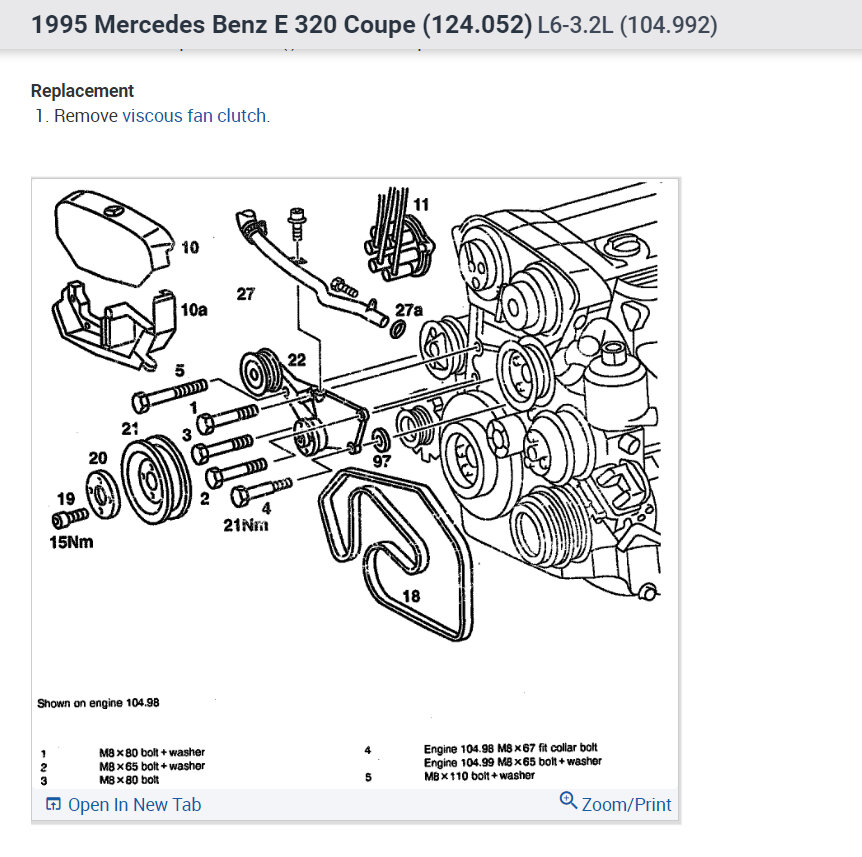

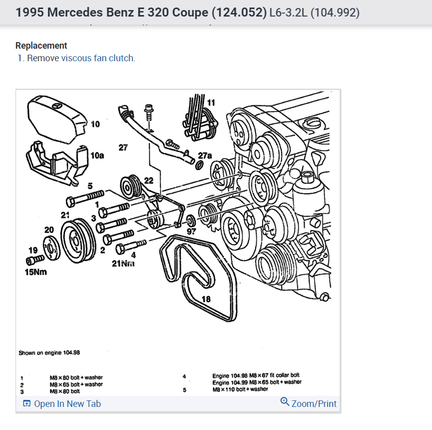

From the exploded view of the belt/pulley system, I think the pulley labeled #21 is the pulley the viscous fan assembly is mounted. It's my granddaughter's first car and I'm (Grandpa) trying to help her fix it. I have a video of the noise and me rocking the fan and pulley on my phone, but I'm not sure how to send it to anything but another mobile phone number. please advise.

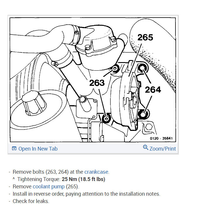

Thanks Ken. With the info you sent I was able to determine that the cooling fan threaded directly on to the belt driven water pump pulley. It must be worn pump bearing. I will replace water pump assembly.
oddly, i did not see any coolant leaking from front of pump bearing, just a wobbly shaft and pulley.
Thanks for your help....
Regards, Bob C.
Dec 27, 2022 at 8:31 PM
  • 54,840 POSTS

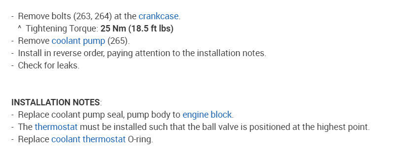

Yep, sometimes that happens, the bearing will go out but not leak. Here are the instructions on how to replace the water pump in case you need them. Please let us know if you need anything else to get the problem fixed.
