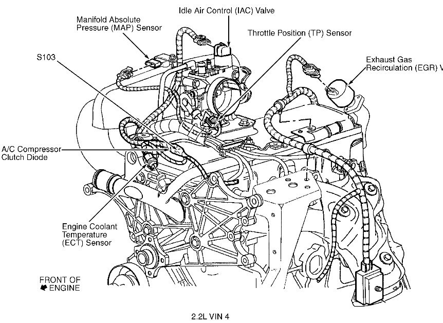

I came up with P0113 code for air intake temp sensor. Engine is running extremely loud with minimal power being acheived. Any thoughts or ideas?

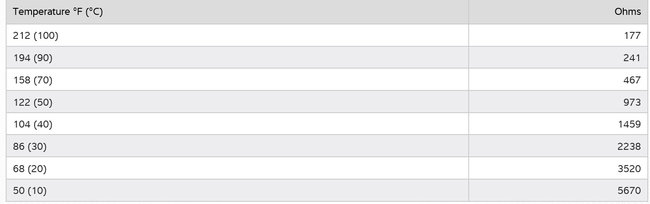

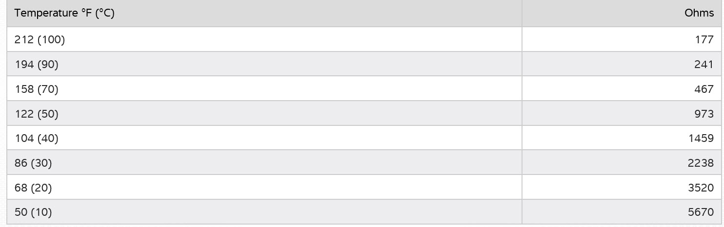

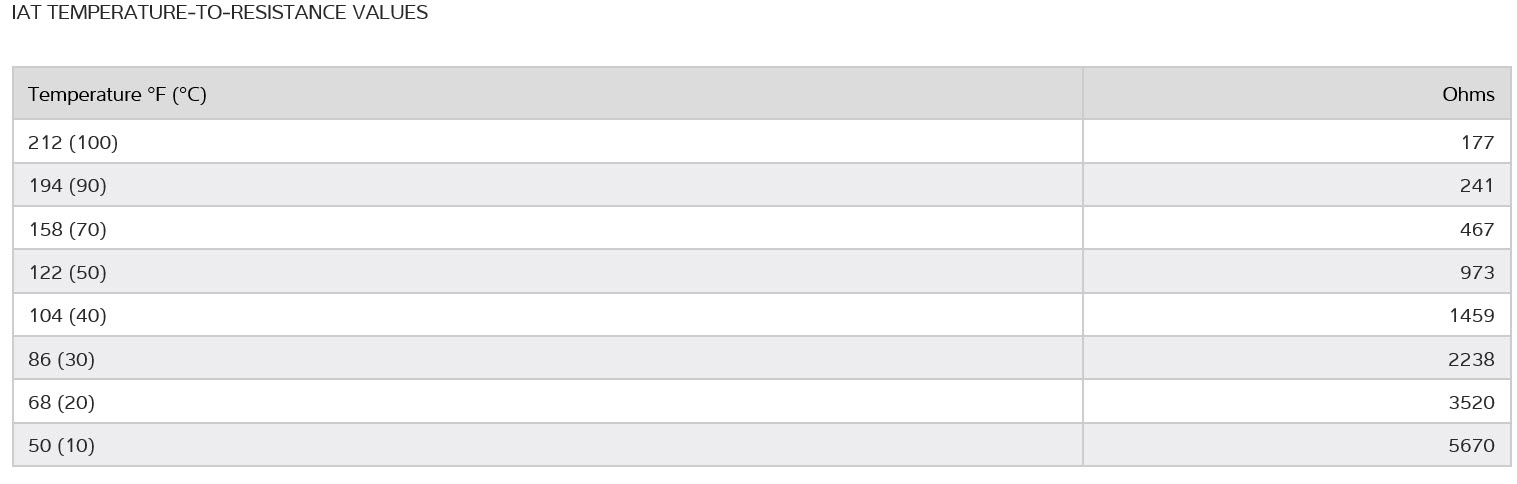

you can try replacing the sensor but it may not be the problem. check resistance of intake sensor and engine coolant temp sensor and see if they are matching if they aren't then replace iat sensor as they should be with in a few degrees of each other. see charts
