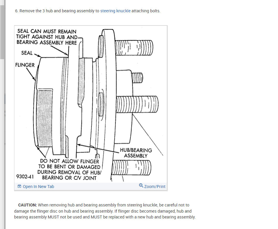

In the past year, driving my car has continually gotten louder with a vibration felt in the gas pedal and steering wheel. It has a kind of grinding rough ride now. I originally thought it was my studded snow tires but it is no different with the summer tires. I also noticed the car pulled to the left. Also when turning to my right on a long tight curve going 65 MPH the loud driving sound and vibration wasn't as noticeable. It's to the point of not being enjoyable to drive anymore. It almost seems like there is packed sand underneath my whole underside. Any ideas what I should check for first?
Aug 7, 2021 at 7:05 AM

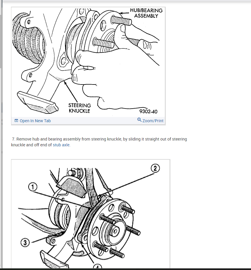

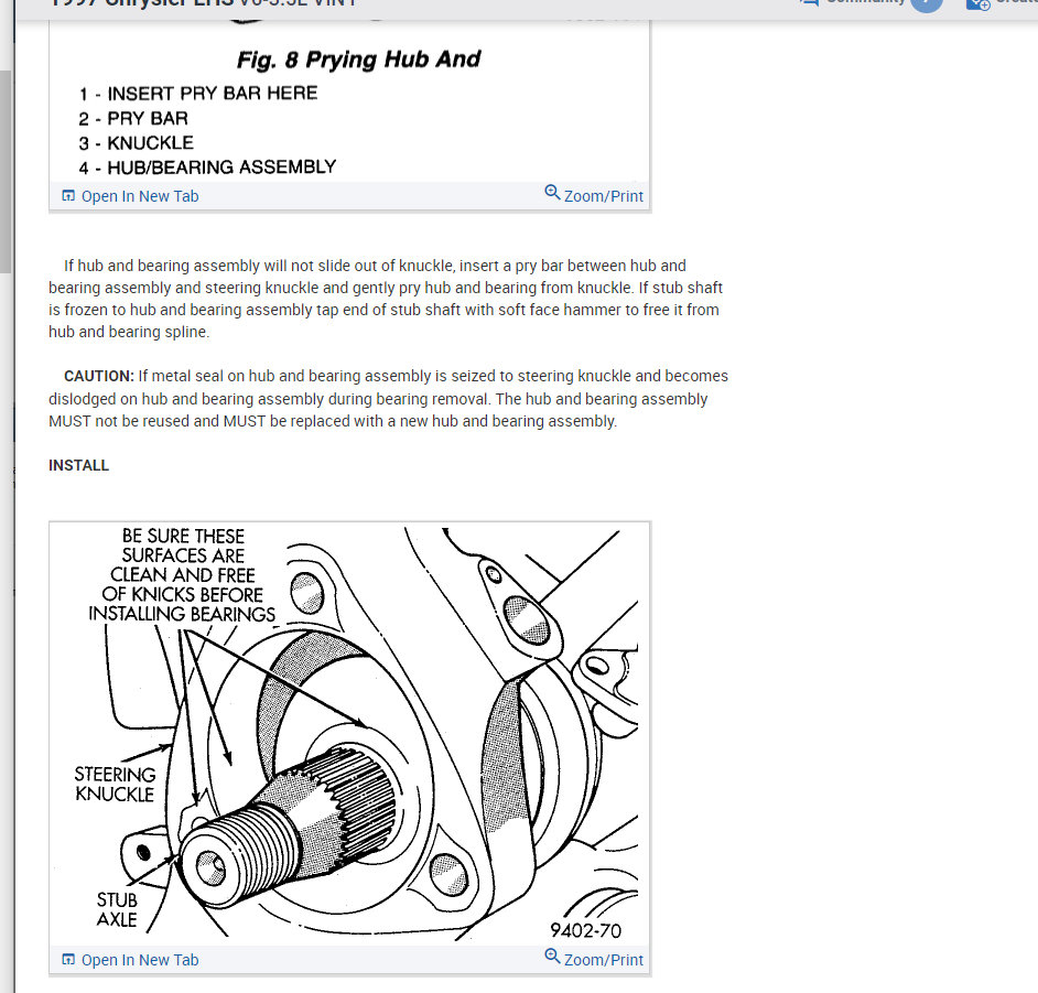

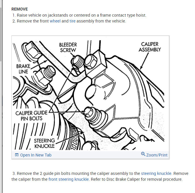

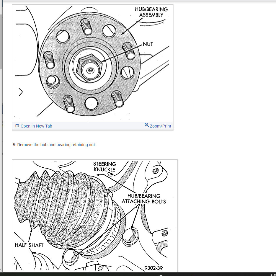

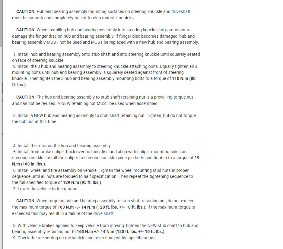

This is almost sure to be a wheel bearing noise.
I am posting a number of guides that will help with this but you stated a couple of telltale signs of wheel bearing issues.
https://www.2carpros.com/articles/vehicle-grinding-noise
https://www.2carpros.com/articles/bearing-hub-replacement
https://www.2carpros.com/articles/how-to-replace-front-wheel-bearings-and-seals

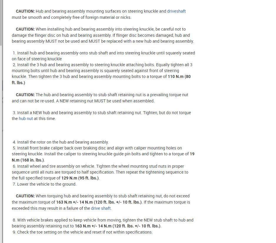

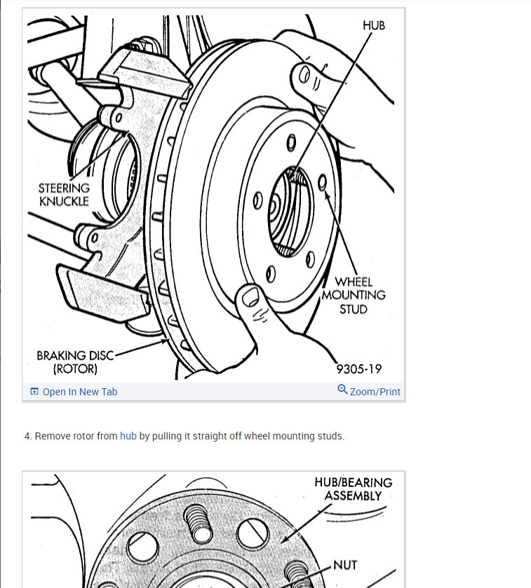

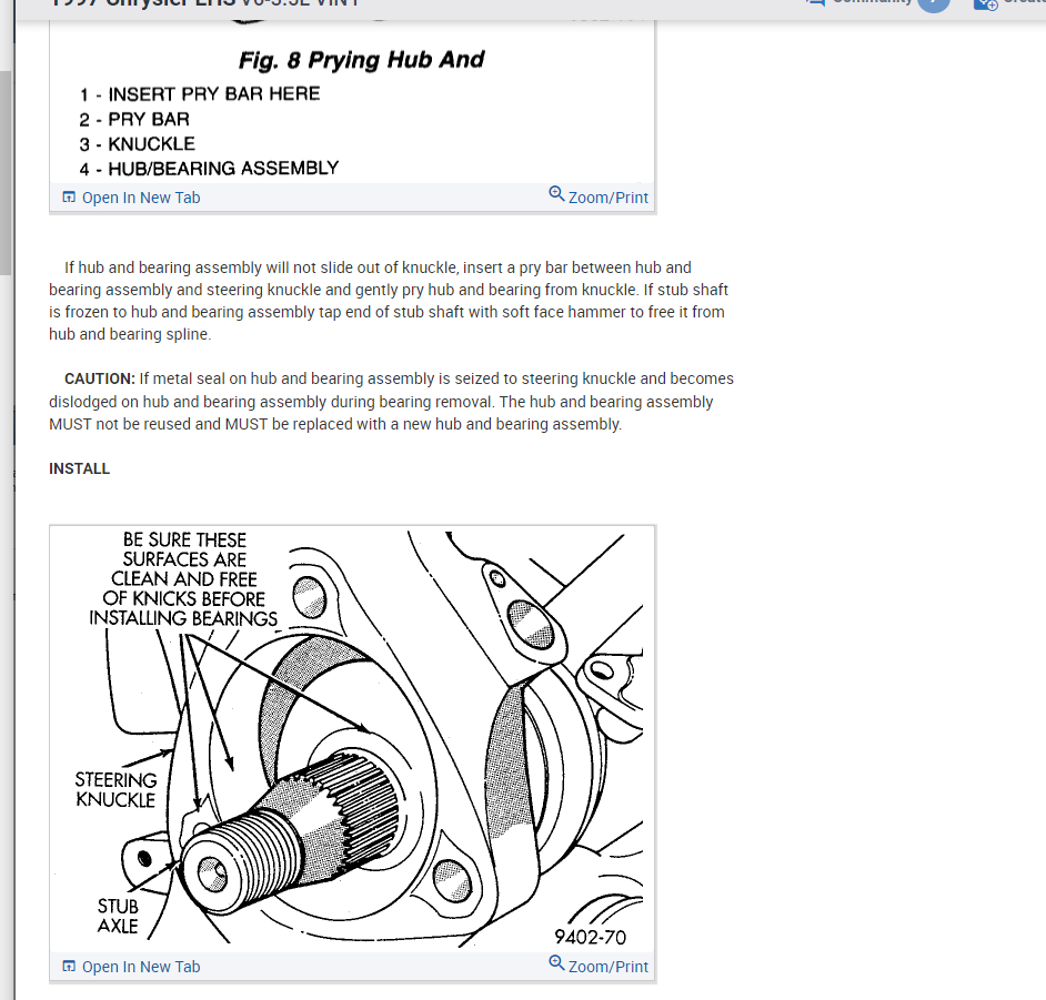

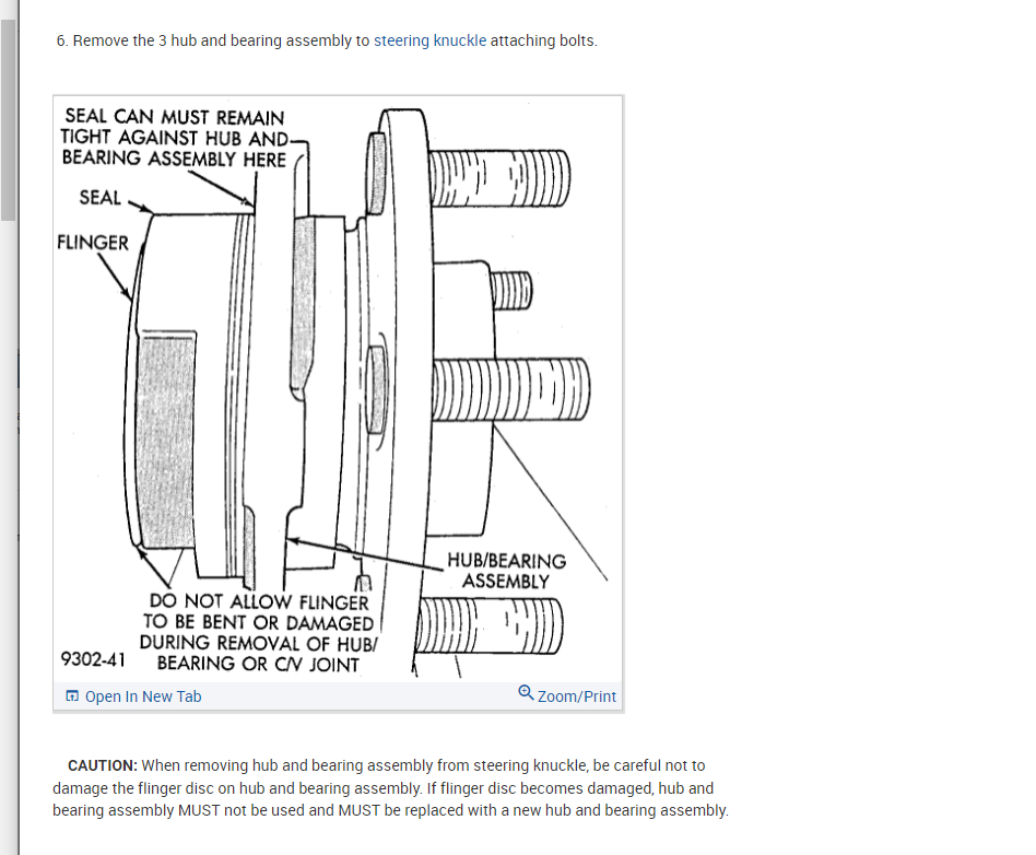

The first thing was that it makes noise/grinding when moving. Next is that you are starting to feel it. Last is that it seems to go away when you are in a turn. This is all signs of a wheel bearing issue. Basically when you turn and the noise stops then the wheel bearing on the side that you are loading is the issue. So if you are turn right, you are loading (putting the weight of the vehicle) on the left side and if the noise goes away then the left wheel bearing is the issue.
I am attaching the info below on the wheel bearing. Please let us know if you can get a recording of this noise and I am sure we can figure out what is happening if we hear it.
Please see the info below.
