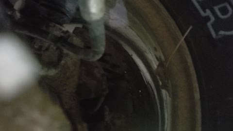

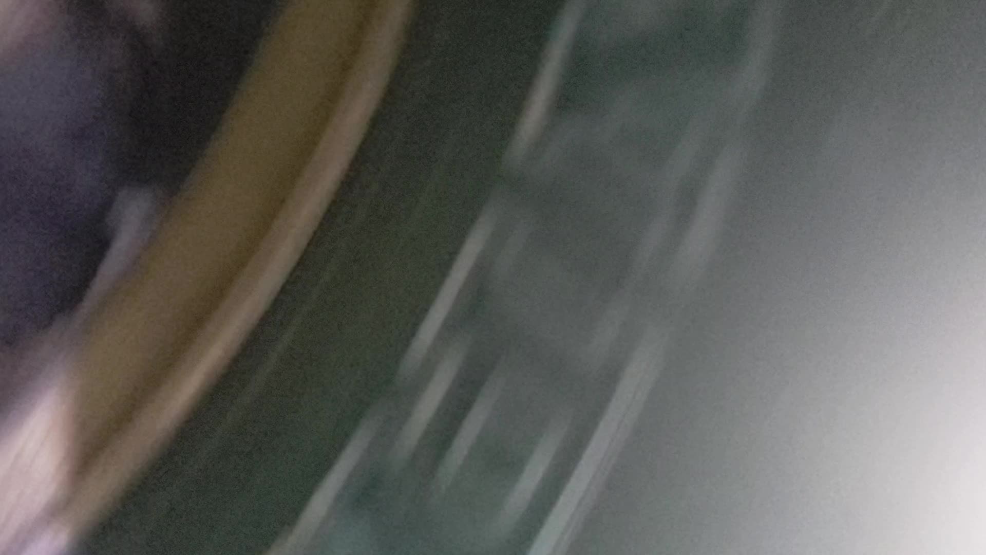

Thank you so much for your help. Yes, I can definitely take a video although I have no idea what I'm supposed to take a video of. I crawled under and tried to get both sides of the tire across. I might have to do it again I'm not sure if this would be any help.

Great job on the video. it looks like the bushes are okay, but I did see new suspension parts which I am wondering are tight. With the truck not moving can you bounce the front end up and down might need two people) to see if you can hear the noise? If so see if you can get an idea of the source. Let me know I want to get this fixed for you.
