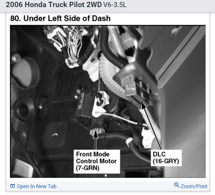

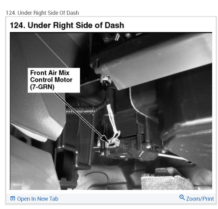

I just started having this issue about 2 weeks ago. Every time we turn the engine on, a loud clicking noice starts (sounds like it under the dash or between the center console) and then stops after 30-60 seconds.
Aug 9, 2015 at 7:42 AM
KHLOW2008
  • 41,812 POSTS

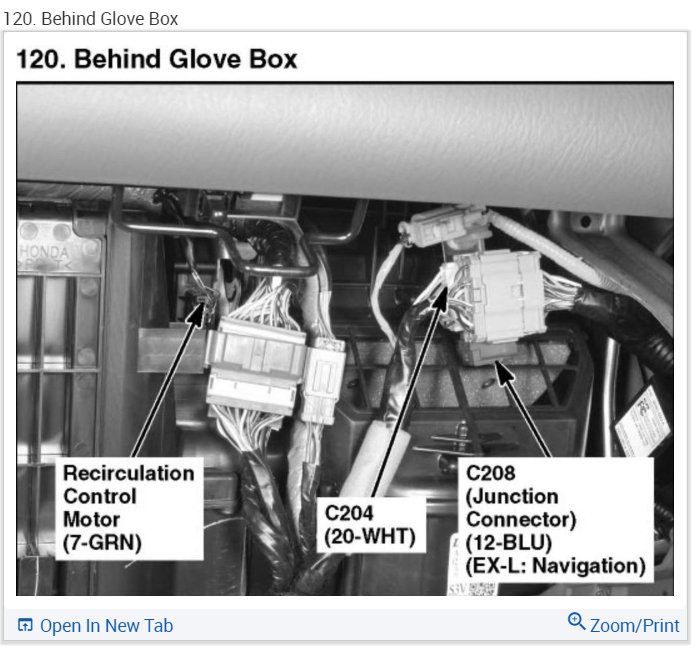

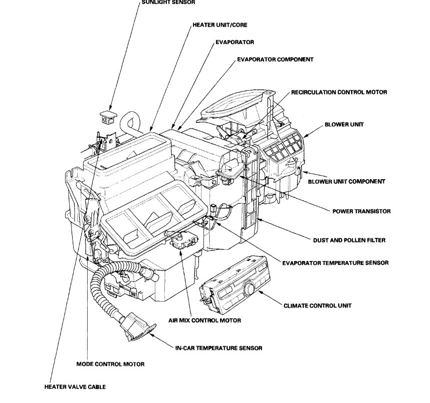

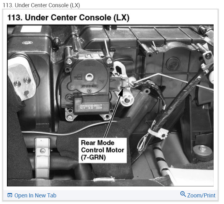

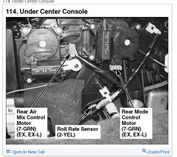

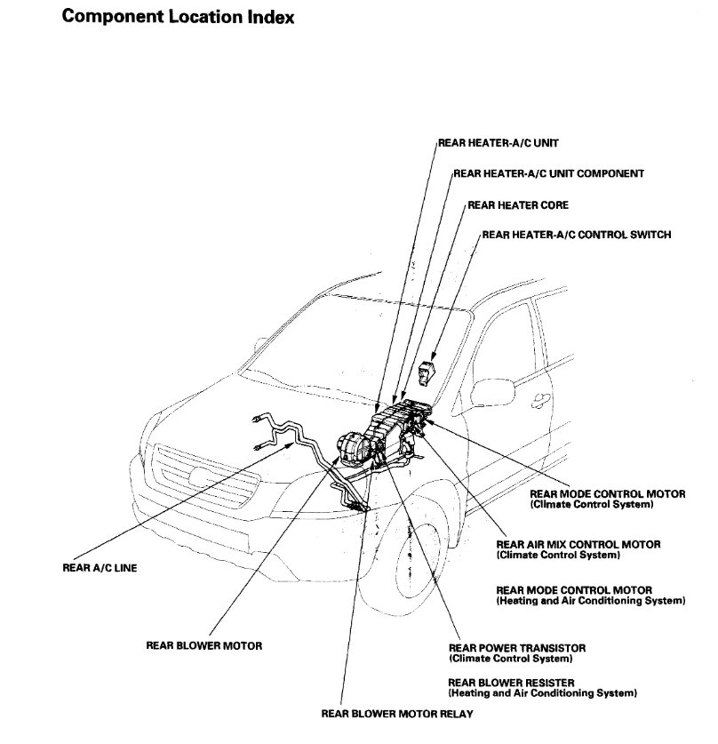

This happens when the blend door actuator goes bad here is a guide to walk you through the repair with diagrams below to show you the location in your car.
Check out the diagrams (Below). Please let us know what you find. We are interested to see what it is.

Thanks for this post I had this problem and had to get a new front mode actuator cost me $112.00. I love this site.
