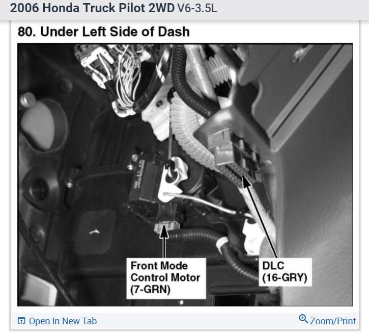

loud clicking noise under dash
2009 HONDA PILOT
118,000 MILES • 6 CYL • AWD • AUTOMATIC
CAROLEDAV

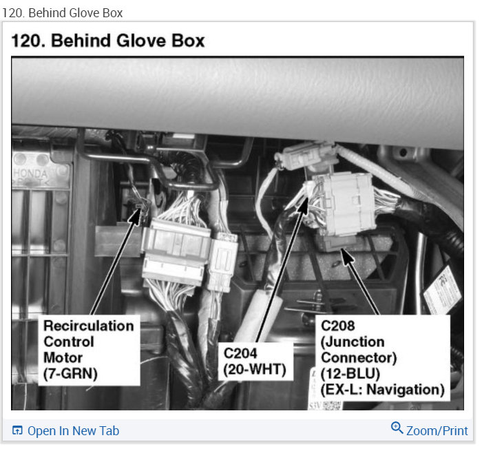

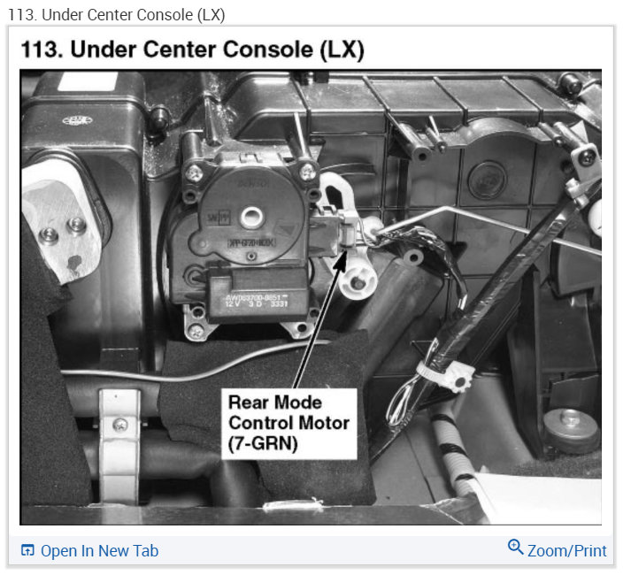

I just started having this issue about 2 weeks ago. Every time we turn the engine on, a loud clicking noice starts (sounds like it under the dash or between the center console) and then stops after 30-60 seconds.
Aug 9, 2015 at 2:42 PM
KHLOW2008
  • 41,814 POSTS

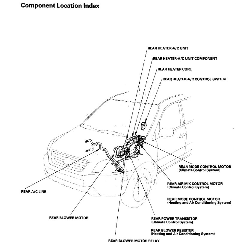

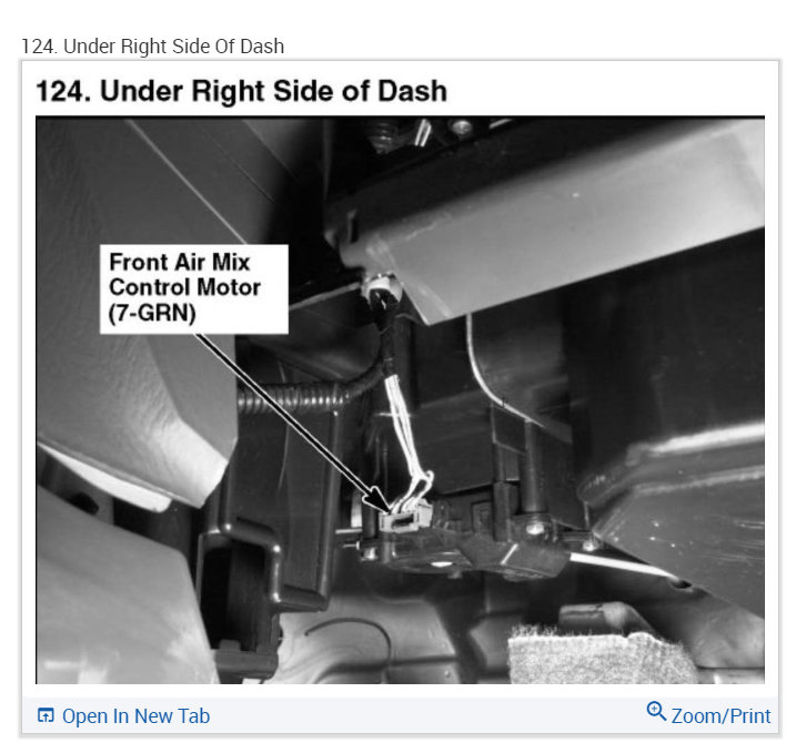

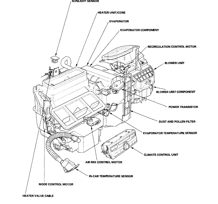

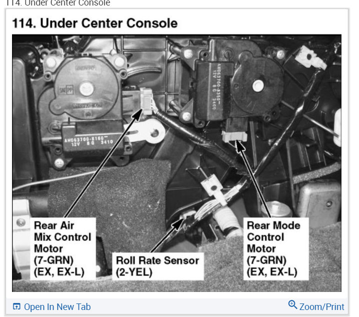

This happens when the blend door actuator goes bad here is a guide to walk you through the repair with diagrams below to show you the location in your car.
Check out the diagrams (Below). Please let us know what you find. We are interested to see what it is.
Aug 10, 2015 at 8:11 AM
ZANYJB
Thanks for this post I had this problem and had to get a new front mode actuator cost me $112.00. I love this site.
