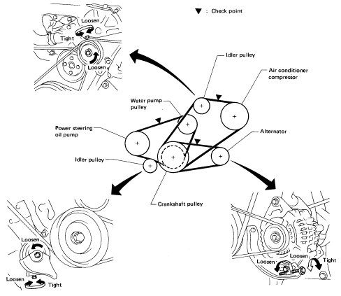

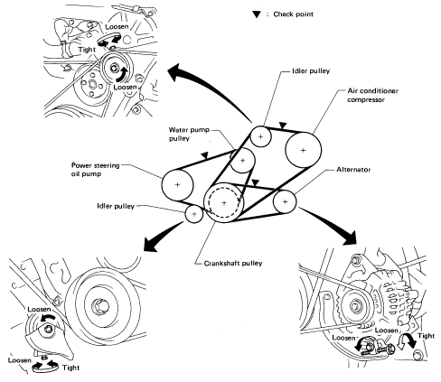

One last thought. If everything checks okay, remove the serpentine belt from the engine. Start the vehicle to see if the noise goes away or changes. It could be coming from one of the belt driven accessories. I have attached a belt routing diagram for you to reference.
