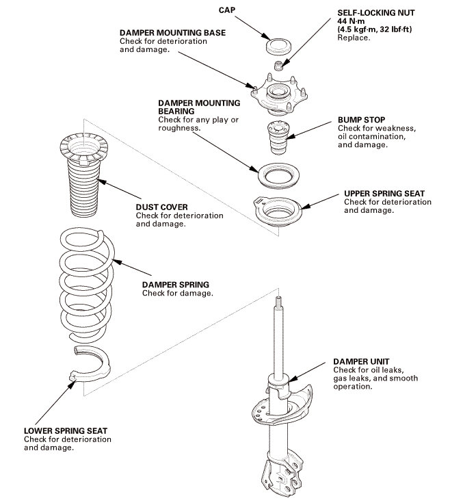

What you described sounds like bad struts. The strut assembly includes the shock. If the shock is bad, excessive bouncing will occur. A general rule that I follow is to this. Bounce the front of vehicle. When you stop, the vehicle should bounce no more than three times. If it does, the shock/damper need replaced.
Also, you can check if there are any excessive oil leaks from the shock which could indicate a problem. See the attached picture.
Check for oil leaks from the location indicated in the picture. You will be able to see the top of the strut assembly under the front fenders (behind the top of the tire).
Do this and let me know what you find. The only thing that is confusing me is when shocks/structs fail, it is usually all the time and not something that repairs itself.
Regardless, lets start with this.

Thanks for quick response and information.
I tried pushing front down four to five times and once I stopped, it immediately stopped. Then I remembered it does the dancing bounce when hitting multiple small bumps - so I bounced it twelve times - and once I stopped it immediately stopped.
