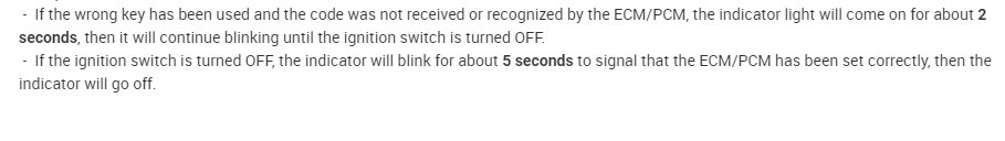

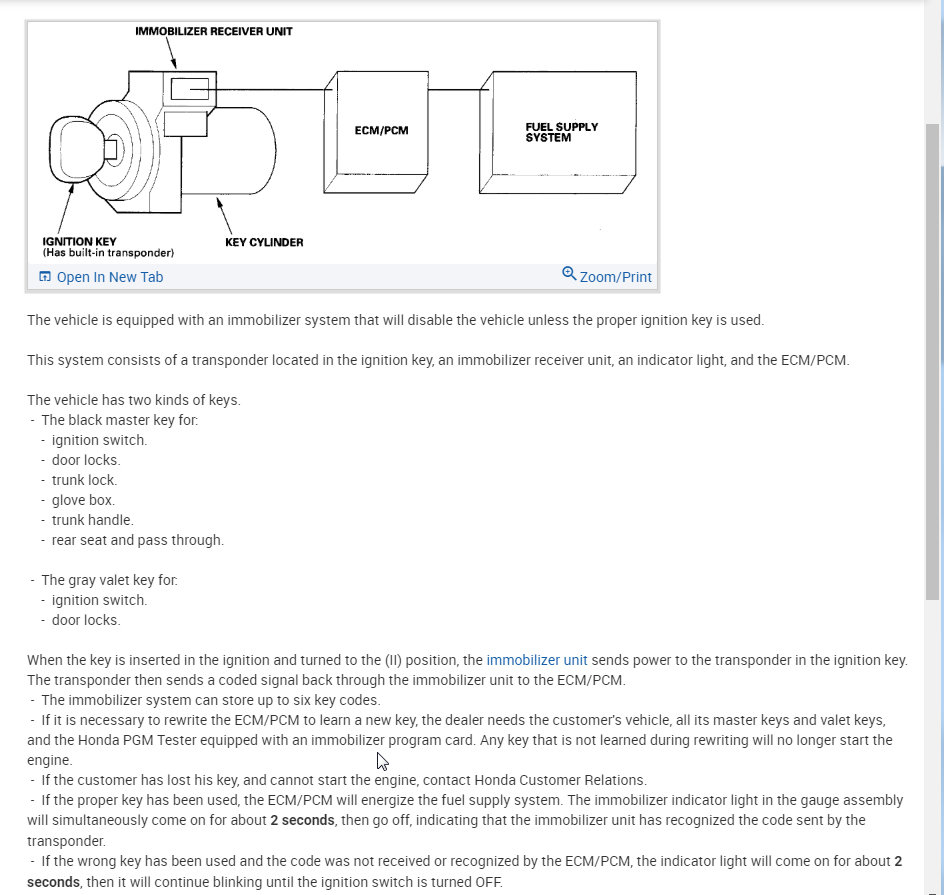

I have lost all copies of the key. can I take the ignition from a broke down Honda I have with the keys still and replace it with the ignition on my Honda I've lost the keys to?
Nov 23, 2019 at 10:49 AM
Unfortunately this will not work. If the ECM does not recognize the key and ignition then it will not start the engine. The key has a chip in it and that is programmed into the ECM. If you are going to change this, you have to program it to tell the ECM the new key.
