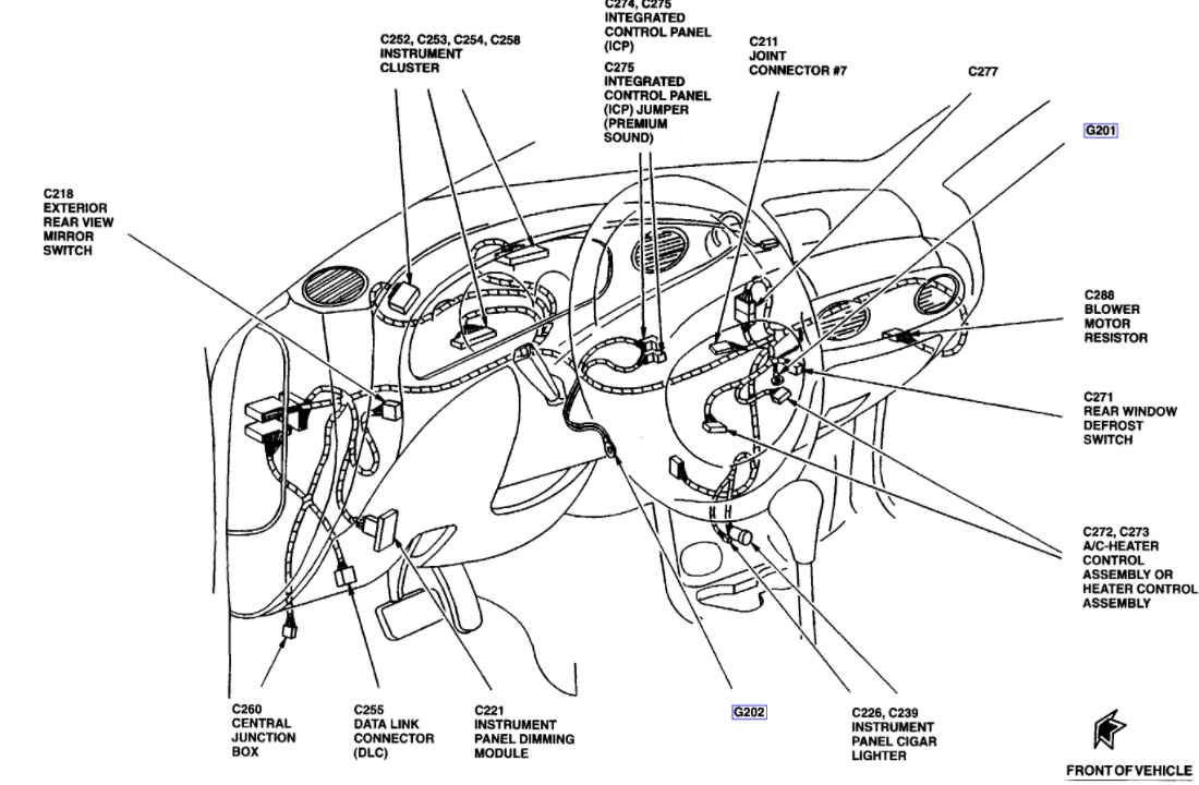

First the engine light came on. A few days later, lost the speedometer. Reader says you need to plug it into a car, but where is it?

the diagnostic ALDL connector is on the drivers side lower dash. This guide will help you get the codes.
Image (Click to enlarge)

The OBDII was not working until I changed the ALDL fuse
