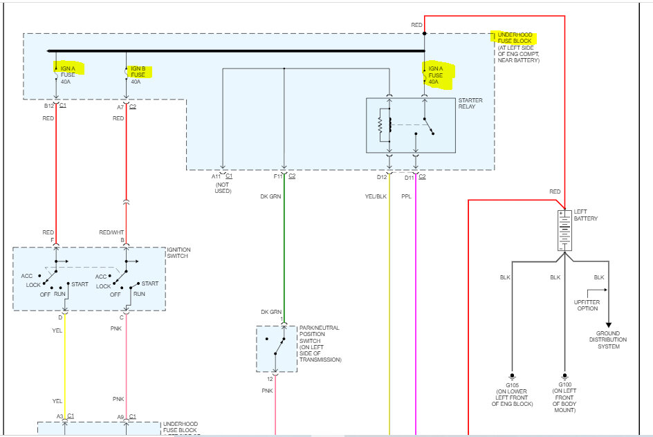

There are several fuses that are tied into the starting circuit. Ignition fuse A and B in the under-hood fuse box, and ignition E and the crank fuse in the interior fuse box. Have you checked all of them? Also, when you checked them, did you confirm there is power to and from them? If not, do that.

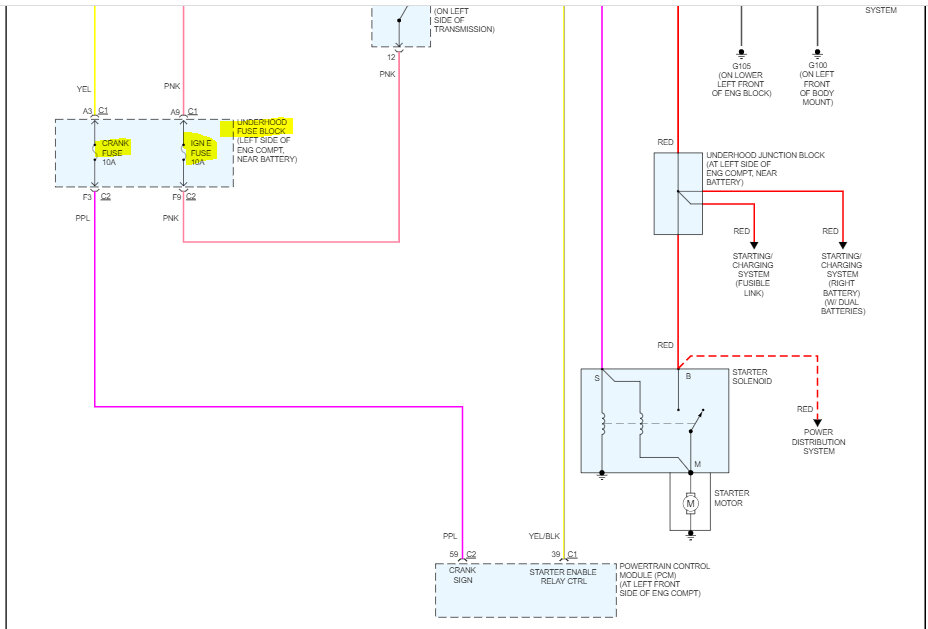

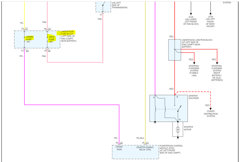

I attached the wiring schematic below, so you have a reference. Let me know as much as you can. For example, have you checked for power and ground at the starter relay?

If you have power and ground at the relay, then the only other things could be a weak connection or an open in the trigger wire between the relay and the starter. If you go to the starter, there is a purple wire. That wire should only have 12v when the key is in the start position. Have you checked for that?

If you have power to everything, there has to be an open between the relay and the trigger wire on the starter.
If you look at the pics I attached above for the starter circuit, it also provides the wiring to the neutral safety switch. If you need something more detailed, let me know and I'll see if I can dig anything up for you.

If you are getting 12v on the purple wire at the starter, the starter itself is having an issue.
The 12v at the purple wire should only exist when the key is in the start position. If it does and you have 12v direct from the battery to the other terminal, it should work.
