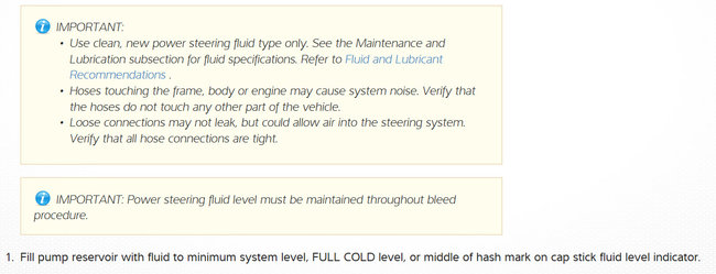

My power steering is not functioning the way is supposed to. Hard during making a turn and when parking. I have done diagnostic of power steering pump and it does send oil through the hoses without any blockage. The are no leaks to be found anywhere and the reservoir tank is at the proper level. The power steering oil is clean and with advice of friends, I have replaced the power steering pump just to see if it solves the problem of being hard during making a turn or parking. There is no difference. The belts are all in good condition and well tightened. I am at a lost and need help of advice on what to do next.

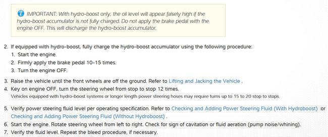

have pump checked for correct pressure. also, try this in picture.
