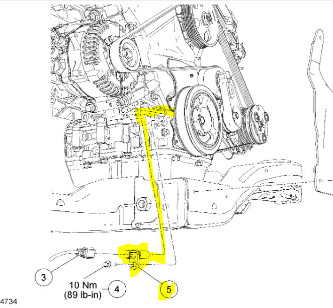

Loss of power with engine noise. Link to video below.

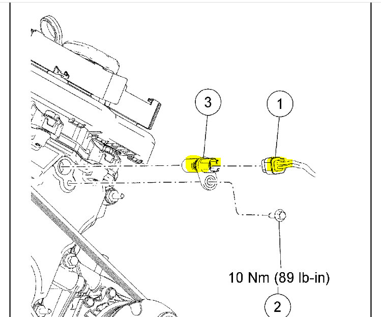

The code P1336 is related to a correlation issue between the crankshaft position sensor and the camshaft position sensor. Check the sensors first for evidence of damage. Also, check the timing chain cover at the crank and the trigger wheel on the outside of the timing chain cover.
The P0340 is specific to the camshaft sensor. It indicates there is no signal from it.
There is no code P135. It should be a four-digit number after the P. Let me know if that was written in error.
Listening to the engine, the noise seems to be most obvious at the top. The camshaft position sensor is at the front of the engine. See pic below. See if the connector to it is good and if that is where the majority of the noise is coming from.
If the noise is coming from lower, carefully check to see if the sound is near the crankshaft position sensor. See pic 2.
