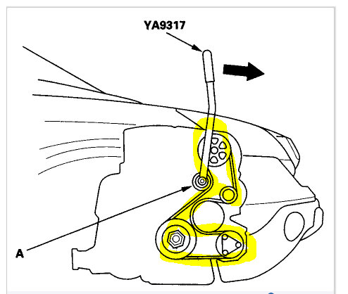

Based on your description, it sounds like a voltage issue that may be the result of a failing alternator. The two things I'm questioning is the loss of power steering and the brake issue. If the engine RPMs were low enough, we may have lost power brake assist and Power steering assist, but not throttle response.
Do me a favor. Take a look at pic 1 below. I need you to open the hood and inspect the serpentine belt. Make sure it is in good condition and tight. (Engine off).
Next, if that appears good, I need you to check the alternator. You will need a multimeter or voltmeter to do this.
Here is a link that explains how it's done:
Let me know what you find.,
