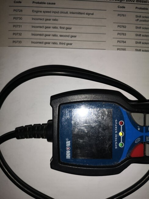

Ho yes forgot the code.
My code reader said,p0733 .
Which is incorrect gear ratio,third gear.nothing else.

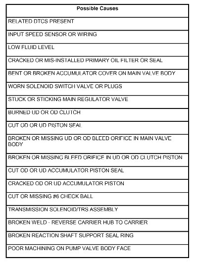

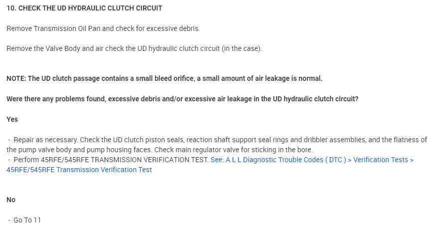

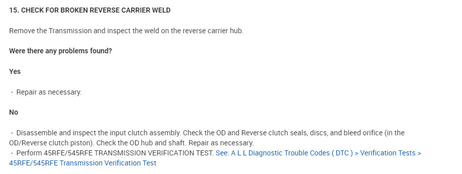

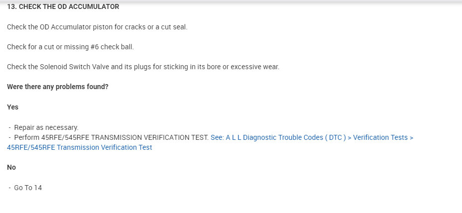

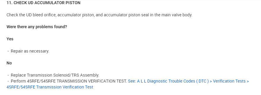

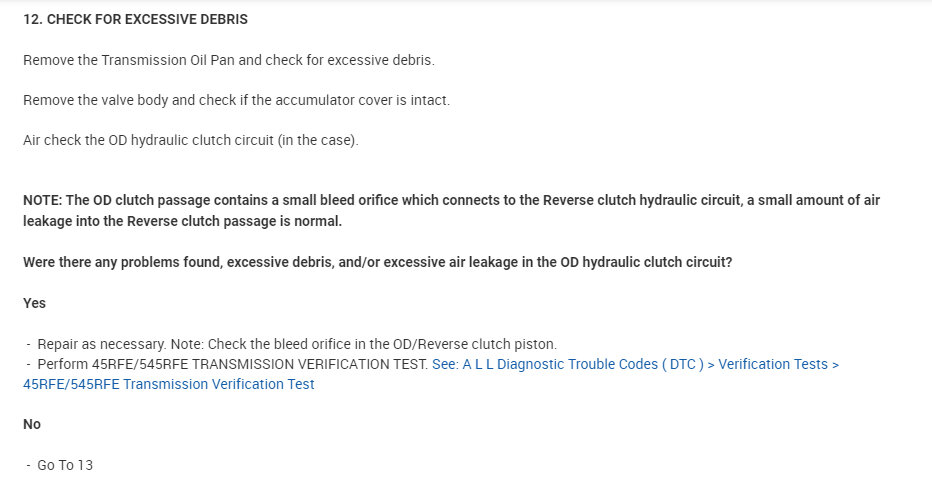

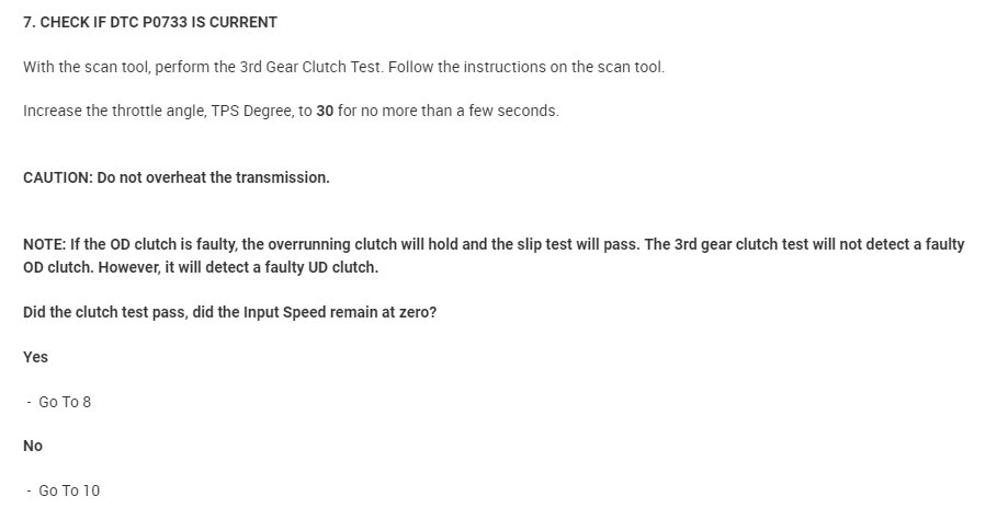

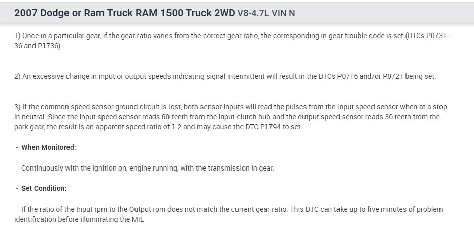

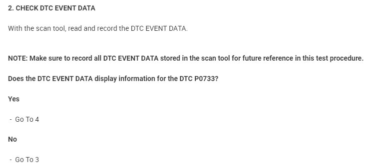

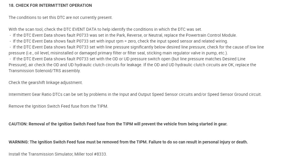

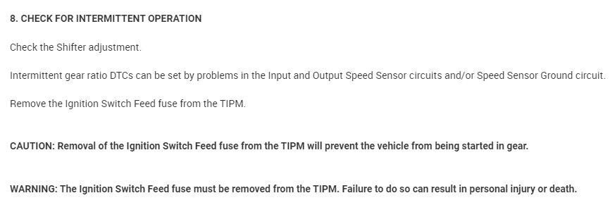

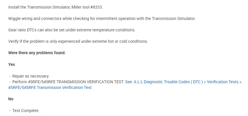

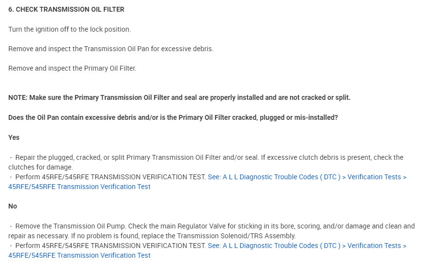

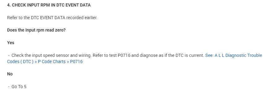

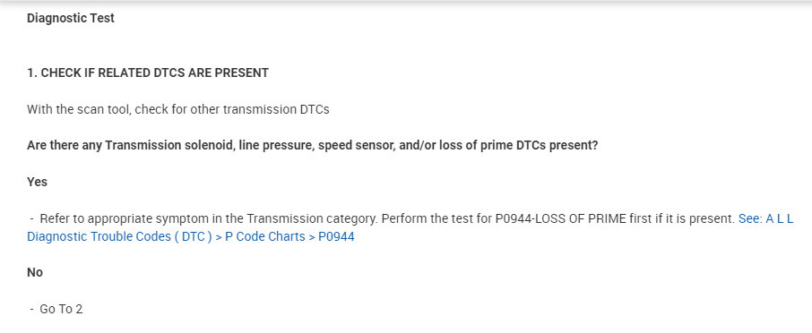

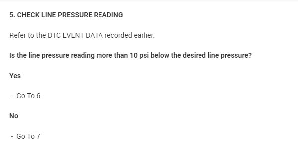

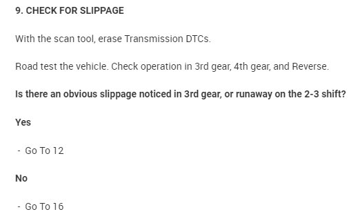

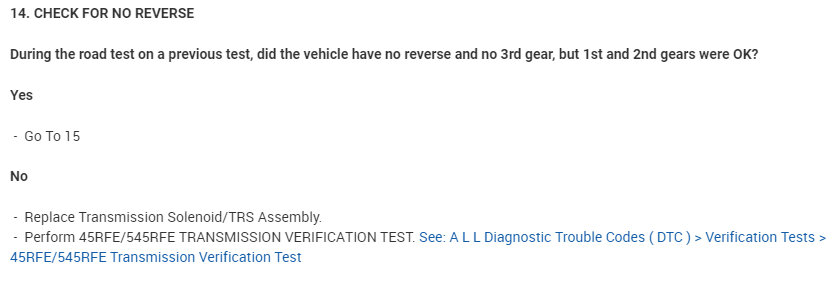

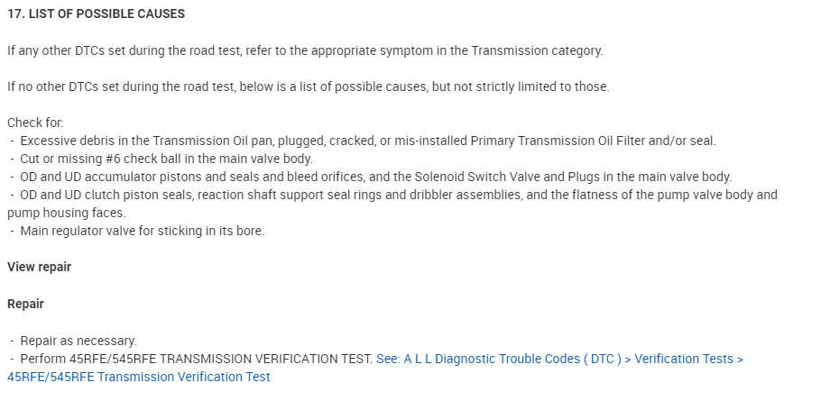

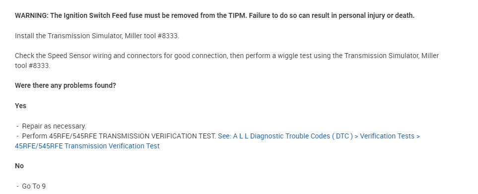

Okay, that helps. I have the diagnostics related, but I need to explain something.
The transmission system uses two speed sensors, one to measure input RPM and one to measure output rpm. These inputs are essential for proper transmission operation. Therefore, the integrity of this data is verified through the checks at the start of the diagnostics.
I attached everything related to the P0733. Take a look through them and let me know if you are comfortable performing the tests. If you need additional information, let me know.

I Looked through pics and i don't have the scan (code reader) powerful enough, the numbers, and the knowledge to perform any of these test and teardown...maybe i can check input and output speed sensor, but i don't have the numbers i need to compare with and need pics that show which wire is what and procedures.

I checked the input and output seep sensors, input tested 0.47 oms, power at 4.25v and ground continuity at 0.22oms...output tested at 0.46-47oms,power at 2.4v and ground continuity at 0.00 oms....could not do the magnet test because i couldn't take the sensors off w/o breaking the bolts.
