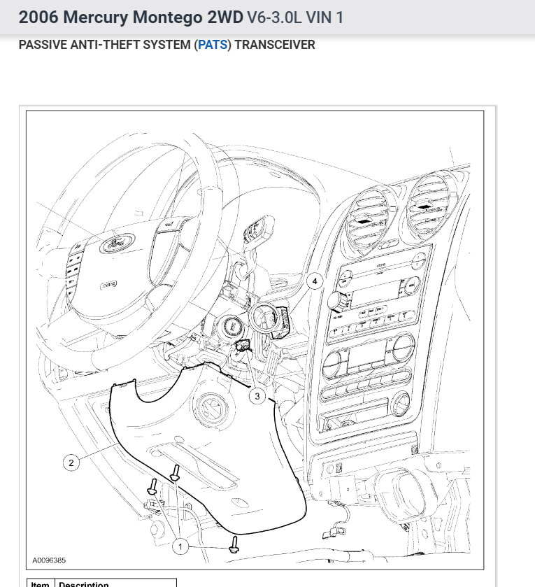

I lost my key fob for my car. I ordered a new one and programmed it to the car, but it still doesn’t shut off the alarm. I am still able to start the car, but the alarm just constantly sounds. Whether I lock, unlock, turn the key, or even open the trunk, the alarm goes off. What can I do?

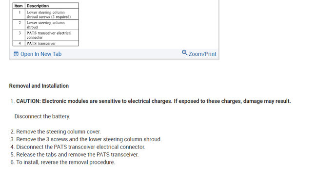

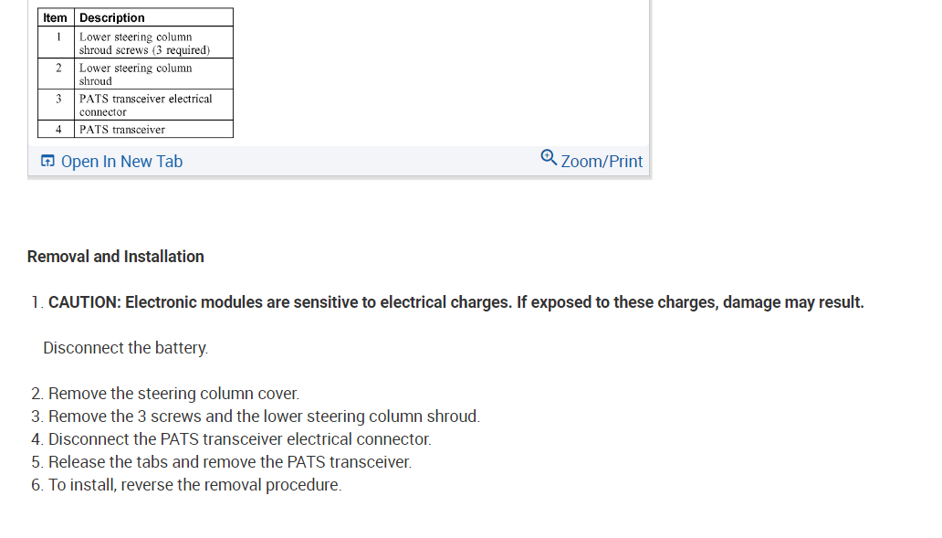

To me it sounds like the Alarm Transponder has gone out here is how you can change it out in the images below in case you need it. Check out the images (below). Let us know what happens and please upload pictures or videos of the problem.
