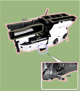

Loosen the heater & blower unit mounting bolt (A).
pic 20
Remove the heater and blower unit (A) from the crash pad (B) after loosening the mounting nuts.
pic 21
Separate the blower unit (A) from the heater unit (B) after loosening the screws.
pic 22
pic 23
Install in the reverse order of removal.
