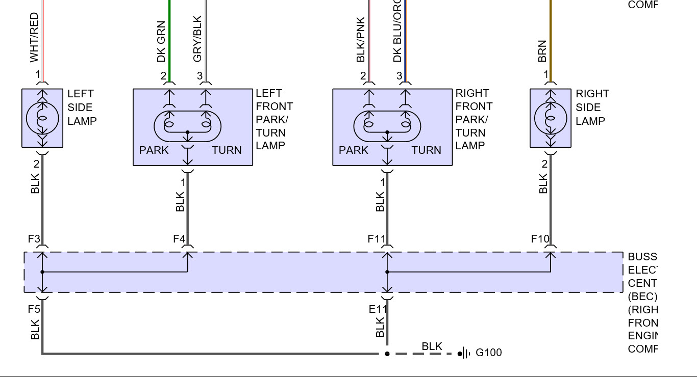

Yesterday when I went out to my car I noticed there was a hole in the bumper where the drivers side turn signal light used to be. When I looked closer I saw five exposed broken wires with the color coding on them. I went to the junkyard and paid for the front left blinker assemblage. But when I got home the color-coded wires did not seem to match up.
Also, I noticed that the rear signal light on the drivers side does not work only one of the three bulbs which I assume is the running light works.

see picture for turn signal there are four wires both black wires. if you have them are ground the rest are shown in picture. rear probably not working because front is missing.
