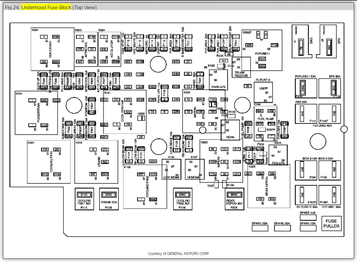

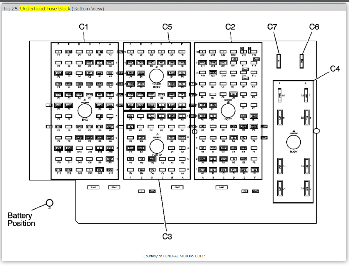

I hooked my car up to my scan tool and I have no communication to the ECM. what could be the reason I have no communication to it?
Aug 17, 2017 at 6:19 AM
Experienced Mechanic
55,594 POSTS

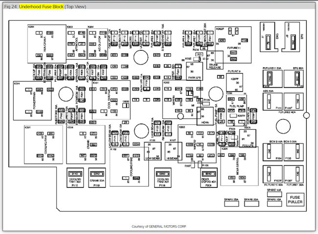

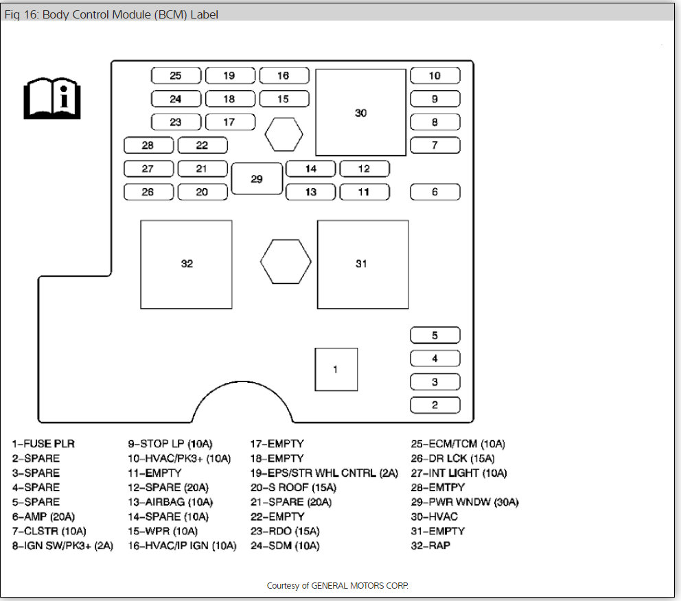

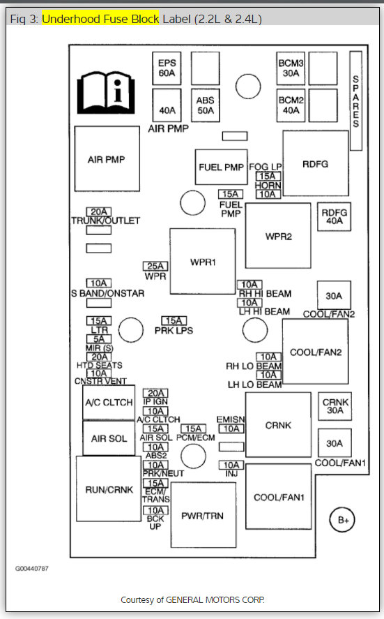

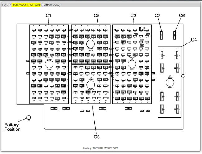

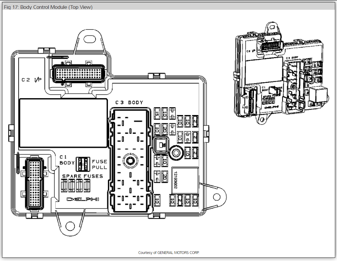

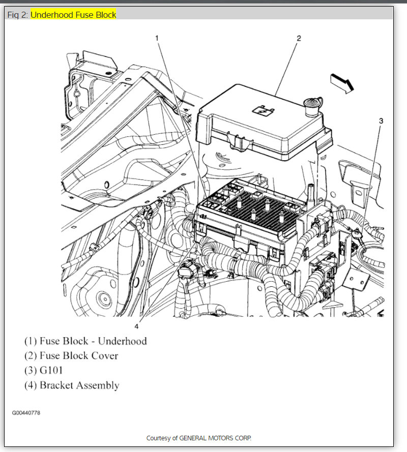

The main reason for no communication is a blown fuse to the ECM or BCM.
Here is the location of the fuse panel and a guide to help you check them:
If all fuses check out then I would suspect a bad ECM.
Please let us know what happens so we can keep helping you.
