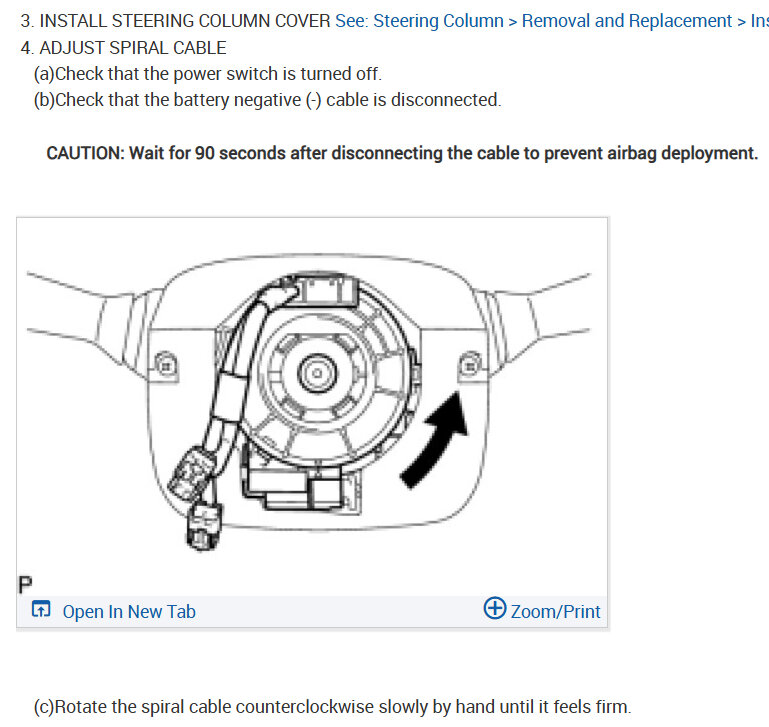

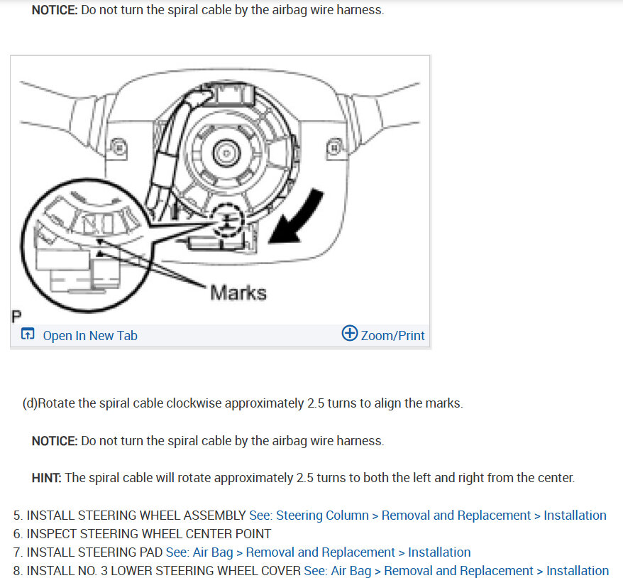

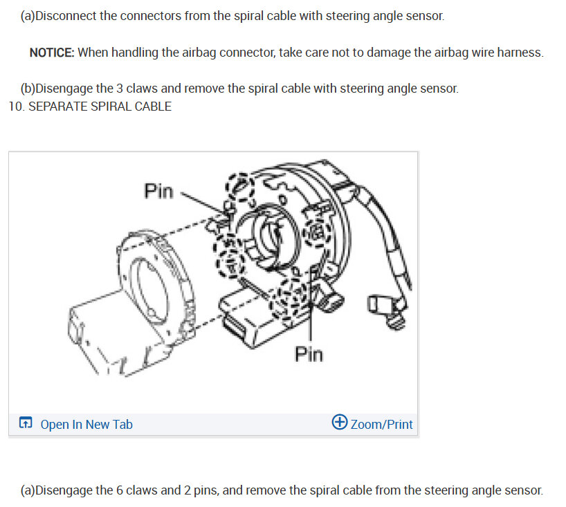

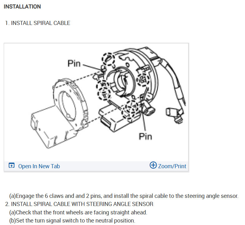

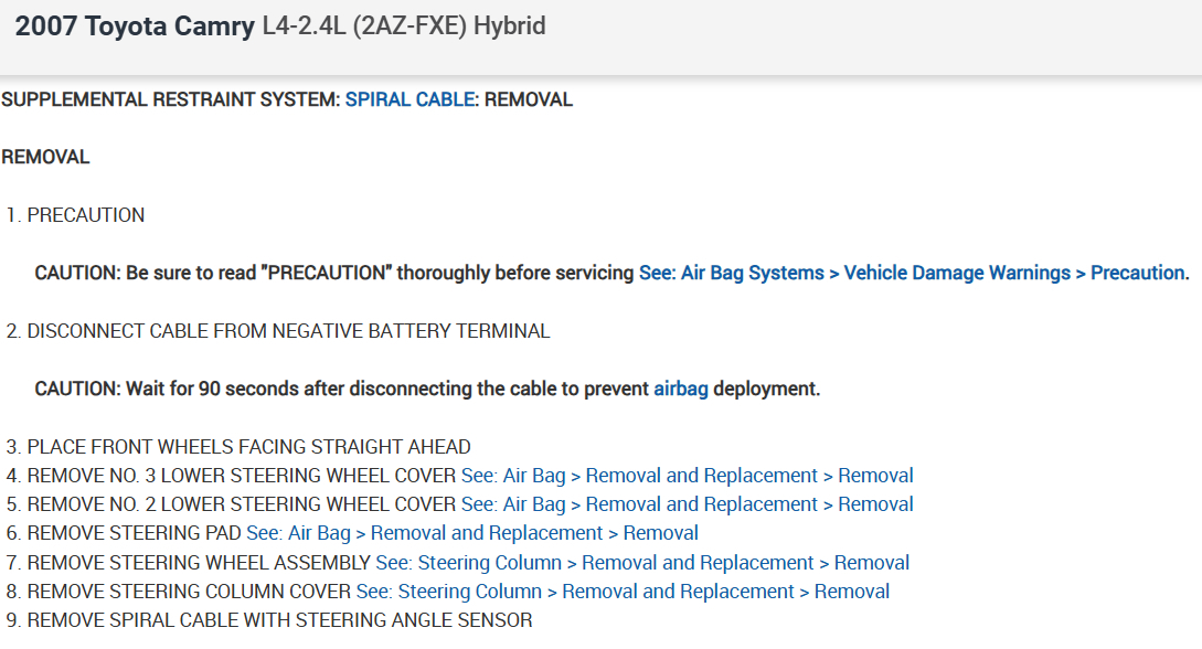

So 9 times out of 10 it will be the spiral wire (clock spring) that sits behind the steering wheel.
P3107 - loss of communication with the airbag system control module
B1000 - Airbag ECU Malfunction

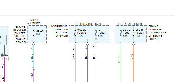

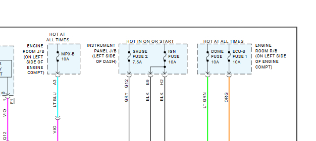

But we should check the airbag system fuses which are listed in the images below.
This guide can help:

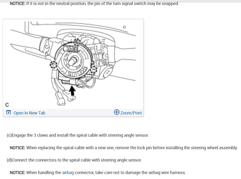

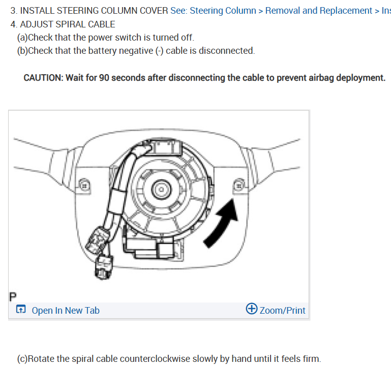

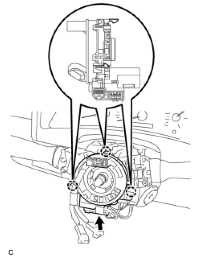

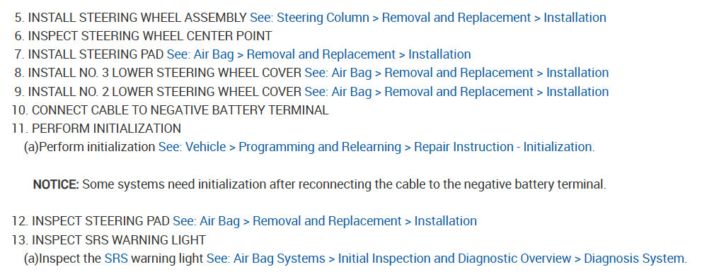

If the fuses are good, I would swap out the spiral wire, here is how, make sure to disconnect the 12-volt battery before you begin. Check out the images (below). Please upload pictures or videos in your response of any problems so we can see what to help you with.
