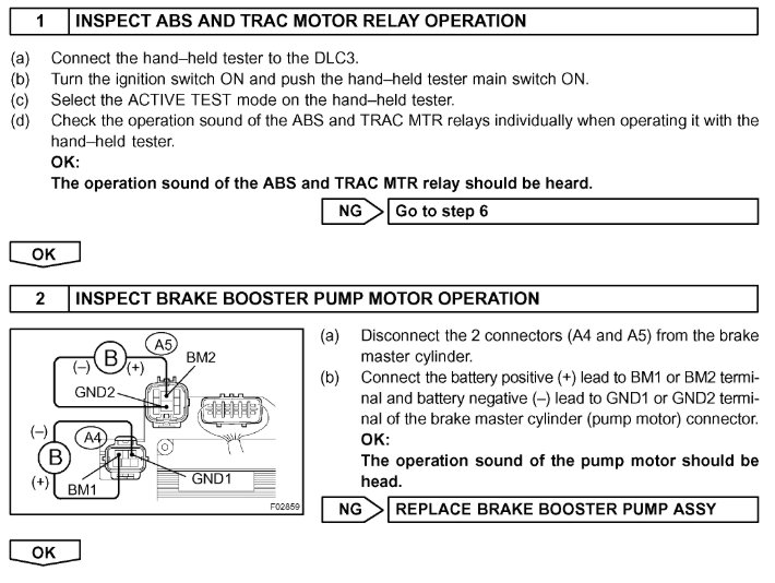

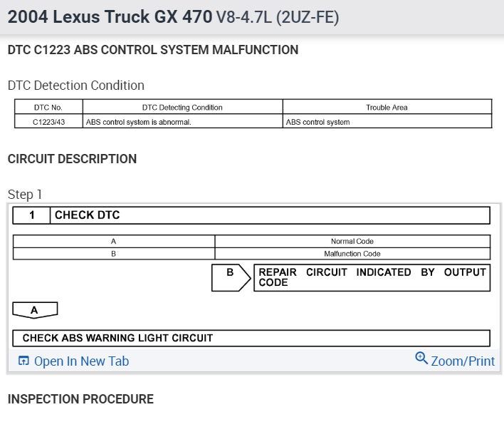

MWILSING
  • 36 POSTS

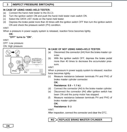

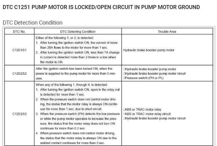

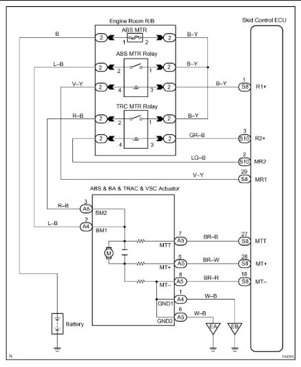

The bad news. C1223. C1251. C1256. My buddy pulled the codes. Had his Toyota tool on it. Tried to run the pump and it would not. Said there is no test to see if it's ECU related? Could it be short in junction box? Our thoughts are to maybe replace just the pump motor first. Any thoughts, ideas, tests ?

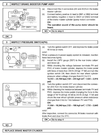

MWILSING
  • 36 POSTS
ECU stated it was sending signal to pump but it does not run.
Jun 22, 2020 at 4:38 PM
MWILSING
  • 36 POSTS
Commutator on motor is toast. Parts fell off it when we pulled it.

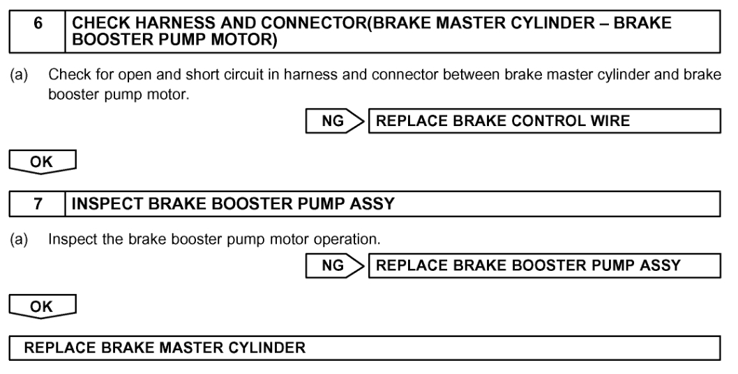

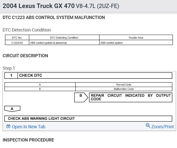

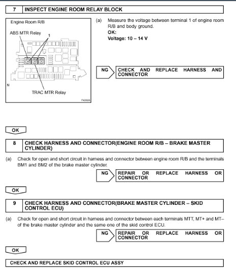

DANNY L
  • 5,648 POSTS

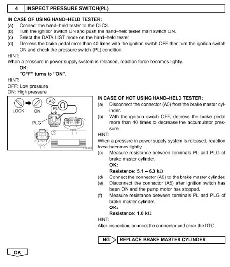

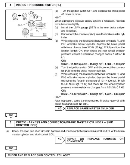

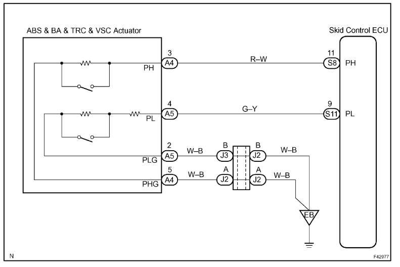

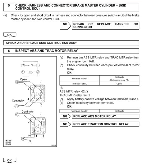

Hello again.

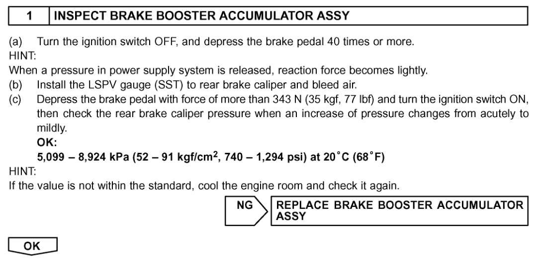

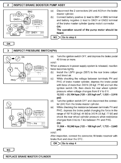

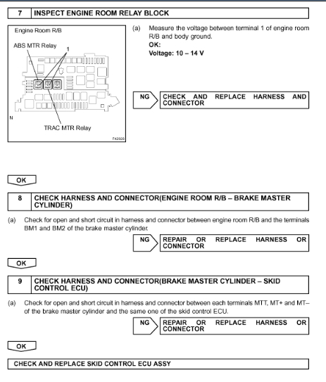

I've attached picture step diagnosis guides below for those particular codes for your Lexus.Hope this helps and let me know if you have any further questions on this.Keep us updated.Thanks again for using 2CarPros.
