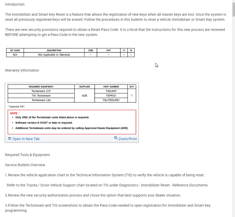

Lost all my keys and have no spare
2003 TOYOTA SEQUOIA
200,435 MILES • 4.7L • V8
XHINO FLORES

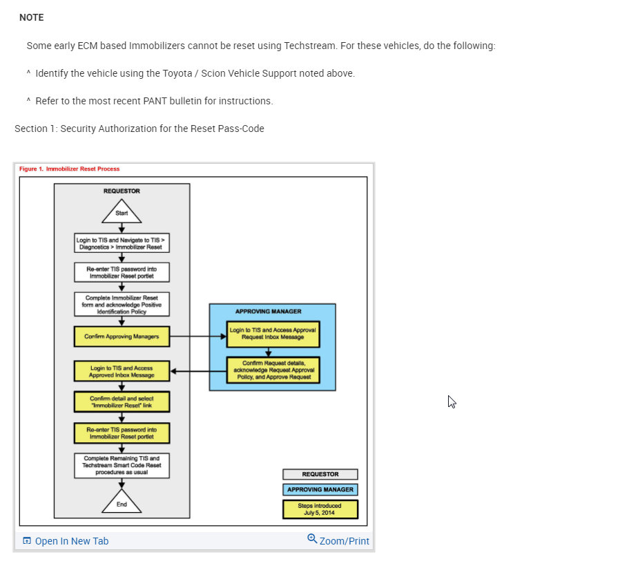

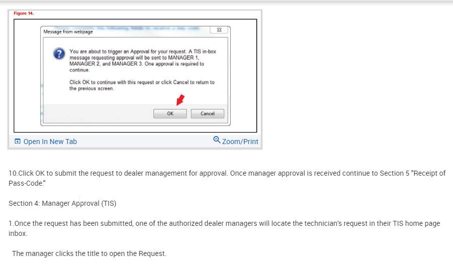

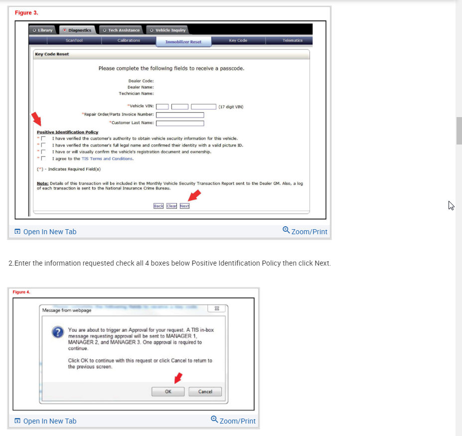

I have the SUV listed above 4 door, SR5 . I lost all my keys no spare. i bought a key smart and didn't work. i bought a plug and play master key didn't work. pretty much i bought anything that i though will solve the problem. know lock smith cant do it so my last thing is to take it to the dealer and pay $700.00. i tried resetting the computer nothing works. or can it be reset and what is the right way? Or can you give me some advise on what to do.
Oct 8, 2019 at 5:40 PM

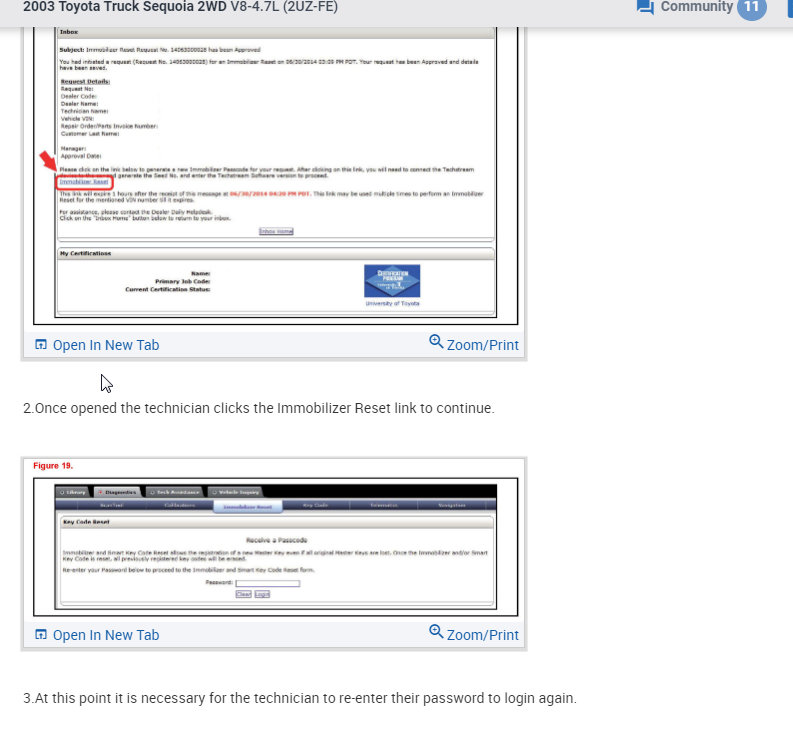

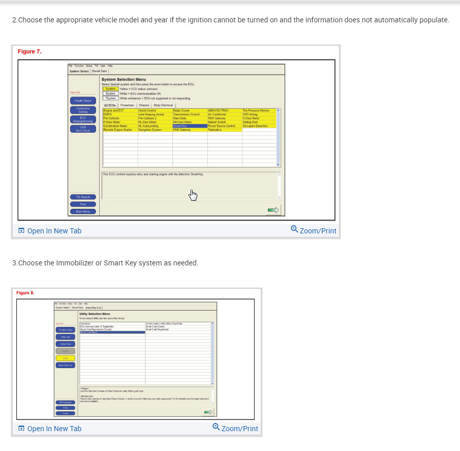

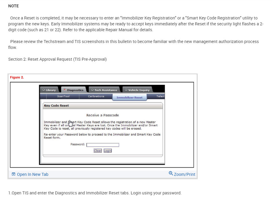

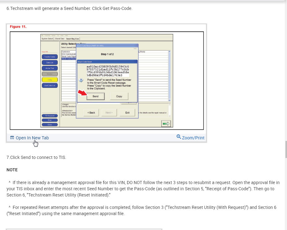

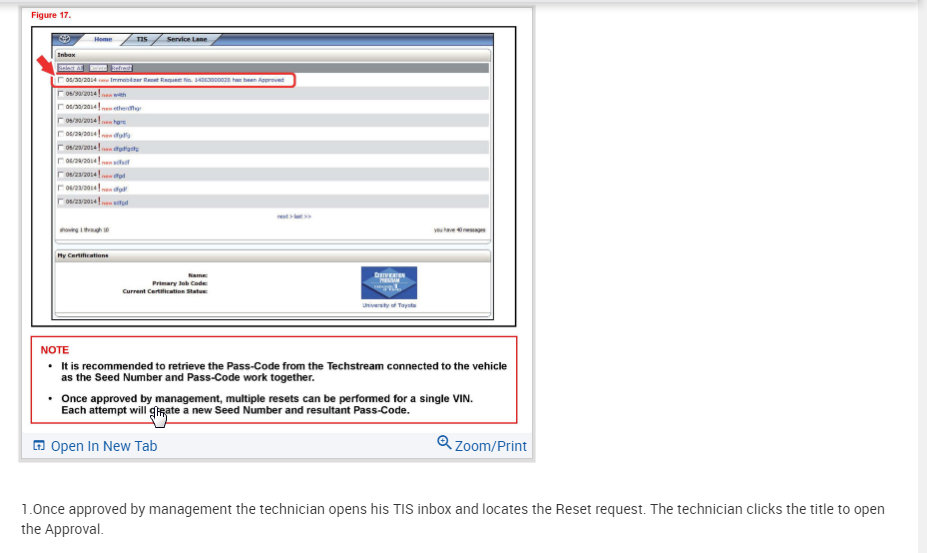

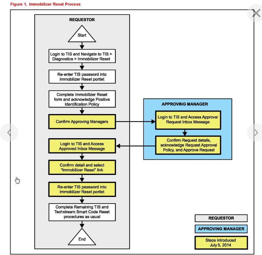

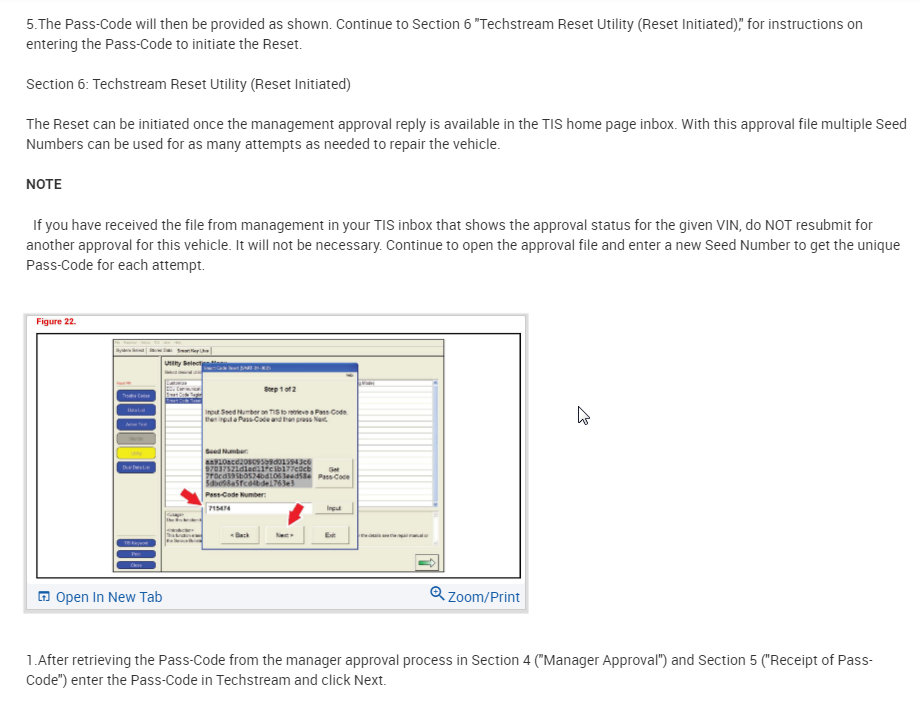

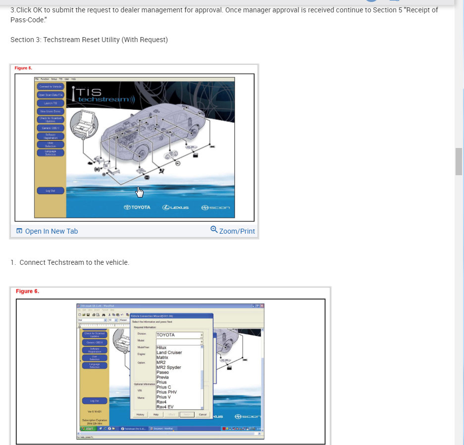

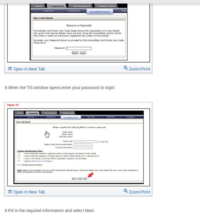

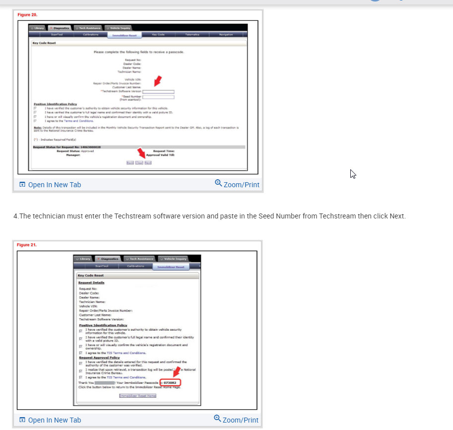

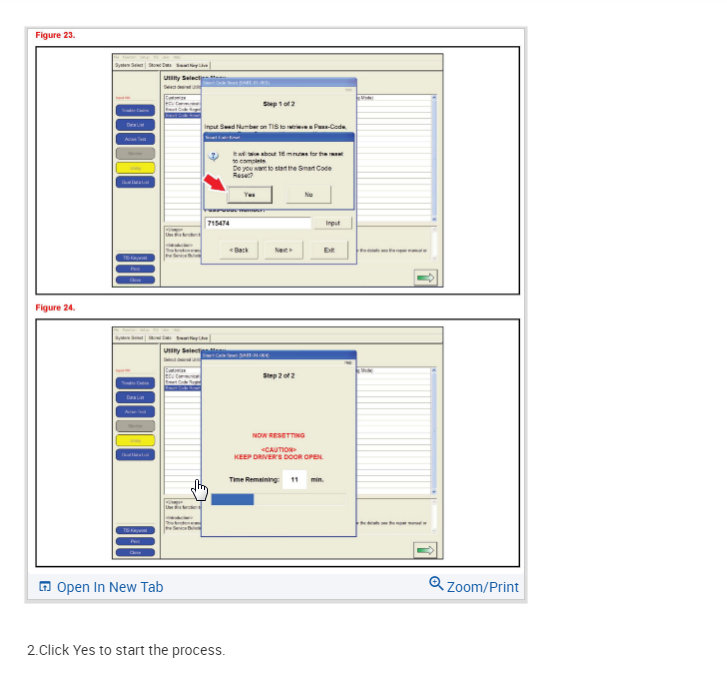

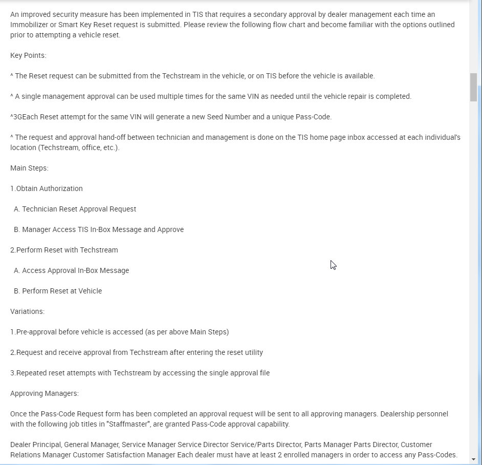

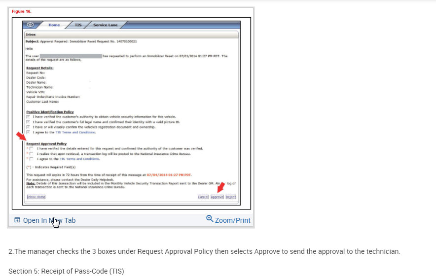

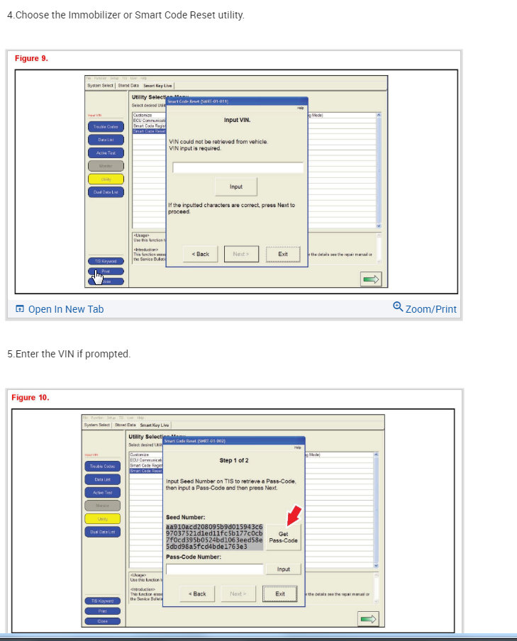

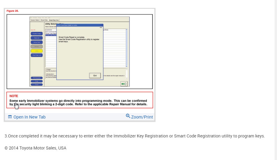

Unfortunately, it appears the only option is to use the scan tool that the dealer has or an aftermarket shop that has one. Take a look at the attached TSB that addresses this issue when registering a new key when all master keys are lost.
I am sorry I don't have better news but this appears to be the only option.
