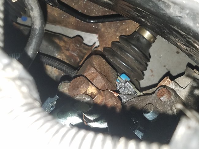

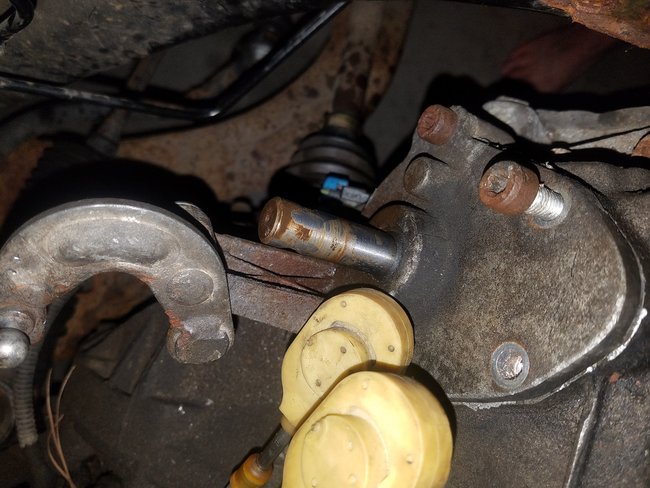

I took apart the shift fork and found the bolt that runs thru it into the shaft going into the tranny Is broke in 3 pieces so when it moves forward and backwards the shaft doesn't move with it
Aug 28, 2016 at 12:58 AM
TRAVIS JONES
  • 24 POSTS
This bolt is broke. I'm having issues removing the part lodged in there
Aug 28, 2016 at 1:01 AM
SATURNTECH9
  • 30,869 POSTS
I had a feeling it was the linkage that's a bolt snapped off?If so you can try to use s punch to spin it out or a reverse drill bit to spin it out.

Just drilled the bolt out that was in there. Now just trying to find a roll pin to put in its place.
Aug 28, 2016 at 7:50 AM
SATURNTECH9
  • 30,869 POSTS
You drilled the threads out also?If so why?A reverse drill bit usually bites the bolt and spins it out.
Aug 28, 2016 at 8:33 AM
TRAVIS JONES
  • 24 POSTS
The threads were pretty mangled. If the pin doesn't hold I may drill it out slightly bigger and tap it for a new bolt. Do you not think a roll pin will hold?
Aug 28, 2016 at 8:35 AM
SATURNTECH9
  • 30,869 POSTS
No I wouldn't use a roll pin there not designed to do that.Get a helicoil kit and put new threads in there make sure you get the one that comes with the drill bit and tap.That's how I would fix it the right way.

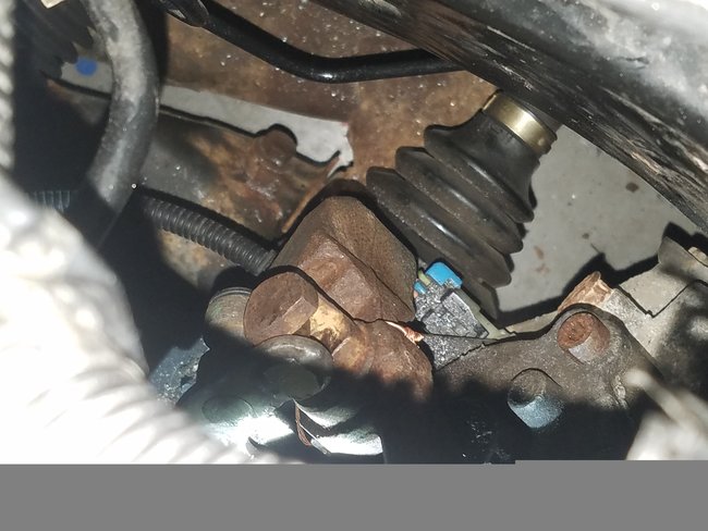

Got it replaced. 2nd 4th and reverse don't shift into well and they work if I kind of slam it into gear. any idea what might be causing that? 1 3 and 5 work great and slide in as expected.
Aug 28, 2016 at 12:12 PM
SATURNTECH9
  • 30,869 POSTS
Sounds like something is binding up it's hard to say I can't see see what's going on.Make sure nothing is too tight and binding.With all that rust try lubing up everything up with some deep creep made by sea foam.
Aug 28, 2016 at 12:19 PM
TRAVIS JONES
  • 24 POSTS

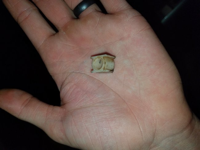

There was a plastic piece for when you move left and right that broke off on the transmission end. Likely that would cause this big of an issue? It's basically like it doesn't quite go all the way into gear unless it gets rammed in
Aug 28, 2016 at 12:21 PM
SATURNTECH9
  • 30,869 POSTS
Can you post some pictures that would really help.
Aug 28, 2016 at 12:24 PM
TRAVIS JONES
  • 24 POSTS
I can tomorrow yes
Aug 28, 2016 at 12:28 PM
TRAVIS JONES
  • 24 POSTS
This piece
Aug 28, 2016 at 12:36 PM
TRAVIS JONES
  • 24 POSTS
Where the notch is where it goes
TRAVIS JONES
  • 24 POSTS
Another

We need to replace that piece and lube everything up with deep creep.
Aug 28, 2016 at 12:48 PM
TRAVIS JONES
  • 24 POSTS
Think you could find a PN for that?
Aug 28, 2016 at 7:19 PM
SATURNTECH9
  • 30,869 POSTS
Can you try to take a nice picture of the assembly all bolted up and post it?Iam having trouble finding that part Iam still looking.I would call it the shift tower.
