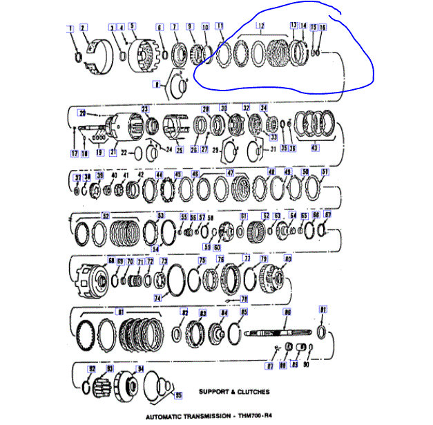

Departed freeway. Pulled away from exit ramp and lost all forward gears in about 10-20 yards. No forward gears but strong reverse gear. Check engine light had been on since I bought it and have driven it a few thousand miles and the only code is P1680.
Sep 16, 2020 at 7:26 PM
Good morning,
The forward is controlled by the forward clutch pack inside the transmission. Chances are that these clutches have failed and will not allow forward movement.
I would drop the pan and see if there is any metal in the pan or on the magnet.
This sounds like either a rebuilt or used transmission will be needed.
