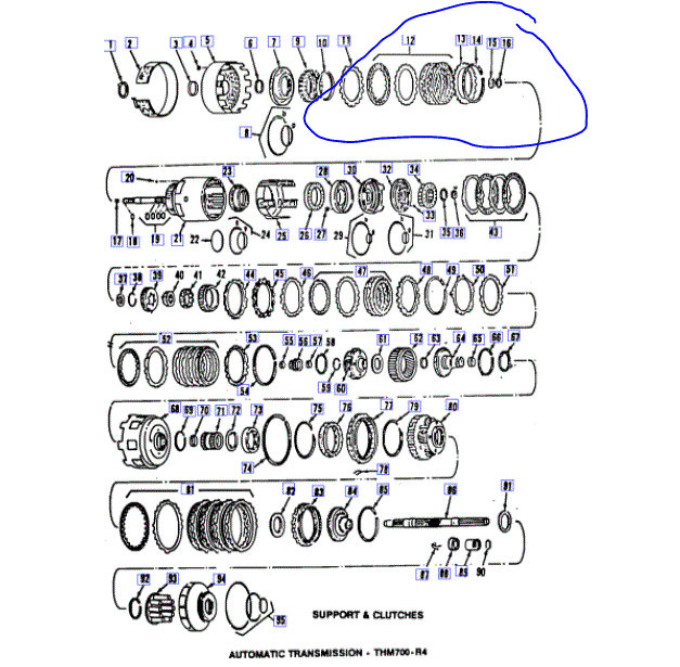

Departed freeway. Pulled away from exit ramp and lost all forward gears in about 10-20 yards. No forward gears but strong reverse gear. Check engine light had been on since I bought it and have driven it a few thousand miles and the only code is P1680.

The forward is controlled by the forward clutch pack inside the transmission. Chances are that these clutches have failed and will not allow forward movement.
I would drop the pan and see if there is any metal in the pan or on the magnet.
This sounds like either a rebuilt or used transmission will be needed.
