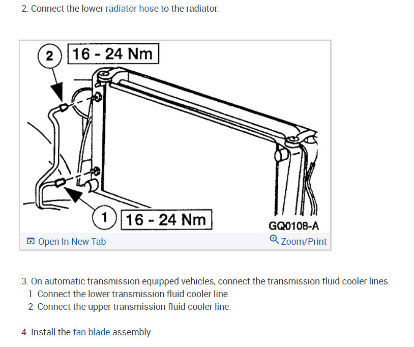

My truck started getting overheated and I realized I had a radiator leak and then noticed transmission fluid in radiator.

Transmission fluid in the radiator tells me the cooler has failed.
You need to replace the radiator, flush the cooling system completely and flush the transmission as well.

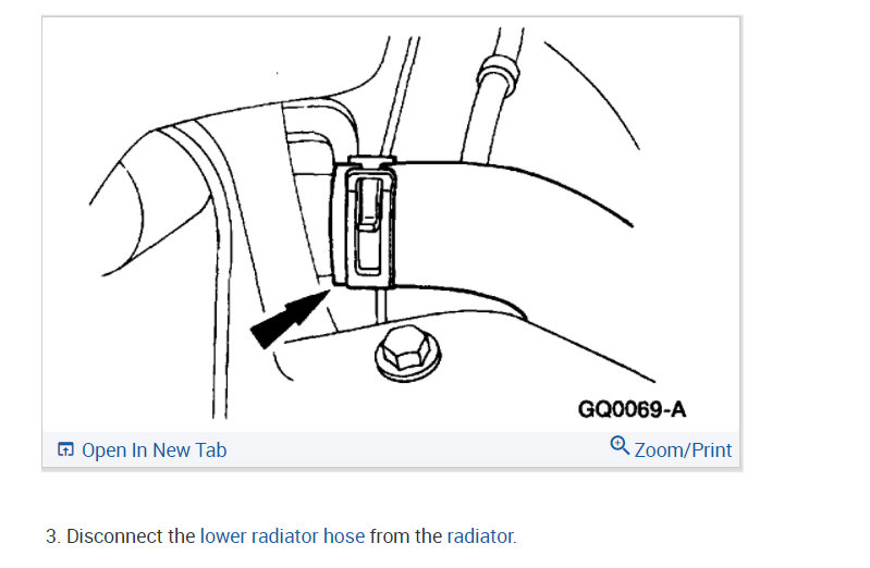

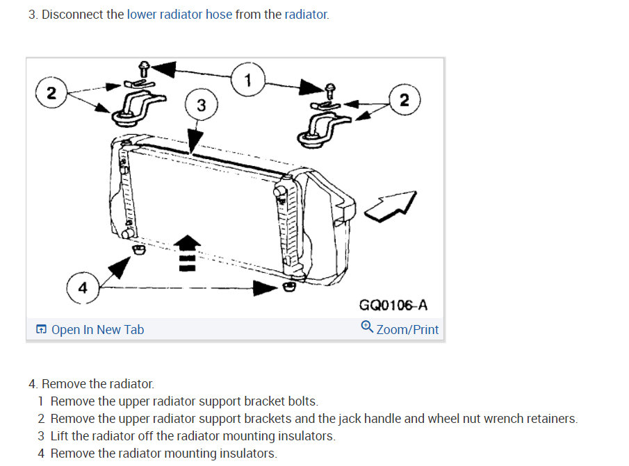

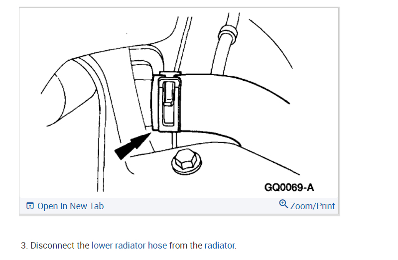

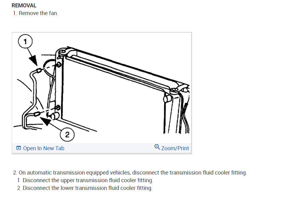

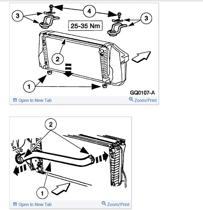

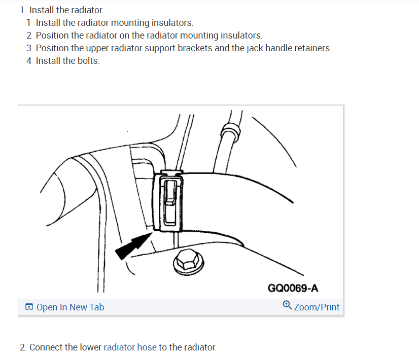

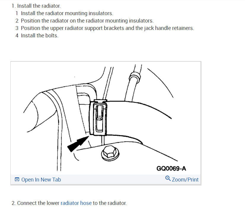

Roy I attached the procedure for replacing the radiator for you below.
https://www.2carpros.com/articles/how-to-replace-a-car-radiator
