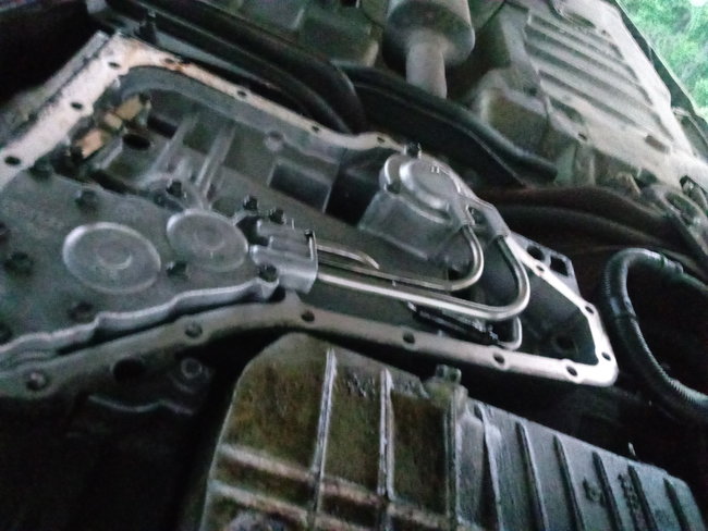

So my car has been losing power when turning left. It wasn't a big problem but is has gotten worse it feels like it is slipping out of gear. And it has no power when at a complete stop sometimes when I press the gas the car doesn't want to move. It drives fine once it is done being sluggish. Sometimes when. I put my car in reverse it doesn't want to do anything. I have to hit the gas a few times to get it to move. When I put it in reverse also sometimes it cuts off on me and I have to put it in park and turn it back on it turns on no problem. I have been smelling gas every now and then. The car doesn't take a long time to turn over it starts right up when I crank it. It is leaking transmission fluid from the front transmission hoses (the rubber/metal hoses). I just did a oil change not to long ago. Doesn't have bad gas. I was thinking do a transmission flush and see how that does? I'm really hoping it isn't the torque converter. And ideas??? Please help!!

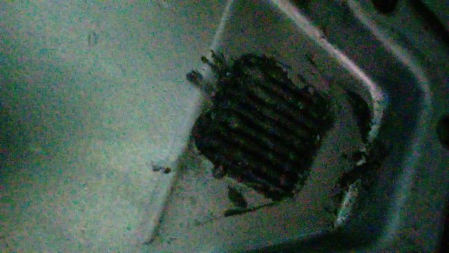

Transmission fluid level looks good there is no check engine light on at all. I haven't ran an obd1 on it. The transmission fluid does have residue in it like metal shavings.

Yes, the transmission fluid has metal shavings. I went to O'Riley's and bought a transmission filter and a seal and transmission fluid . the magnet in the transmission pan had metal shavings all over it. And one of the lines inside of the transmission was disconnected.

Got the transmission put back together. Started storming so didn't get a chance to do transmission fluid. I checked all the vacuums and sensors. Found a broken vacuum line as well. So lets hope tomorrow when we take her off the jack stands and full her up she runs good. (I reconnected the hose and tightened the bolts on that part where the hose had come disconnected) fingers crossed for tomorrow!

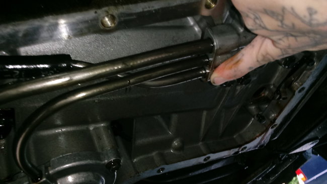

As to the line that was disconnected it was the one I am pointing to in the picture (the 3rd line that goes into the top of the transmission filter housing) I made sure it was in there nice and snug even pulled on it after I put in in to make sure it wasn't coming back out . my dad is a master mechanic so he has taught me a lot thank god. He said that was my problem for loss of power and everything. Transmission was losing pressure and slipping and now functioning correctly.

That's great news. So it is working properly now? And yes, if line pressure gets low, it will cause it to slip.

Yes it's driving like it used to. No slippage or loss of power any more and my brakes stopped acting weird they were shaking when I hit the brakes but that stopped. So I'm happy now she's back to her old self!!
