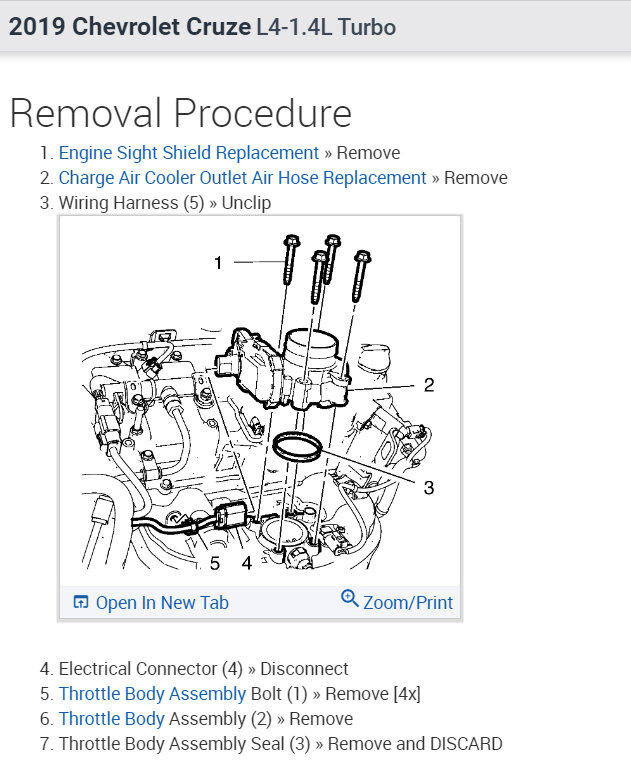

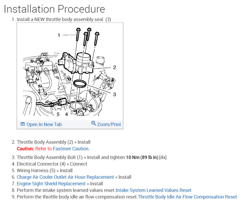

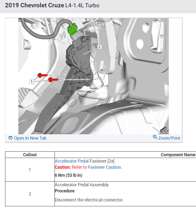

It sounds like the throttle bore is dirty or the throttle pedal position sensor needs to be replaced. We should run the codes first to see if any comes are present.
Here is a generic guide to help you step by step with instructions in the diagrams below to show you how on your car.
Here is how to remove the throttle body in your car and the throttle pedal position sensor in case you need it. Check out the images (below). Let us know what happens and please upload pictures or videos of the problem so we can see what's going on.

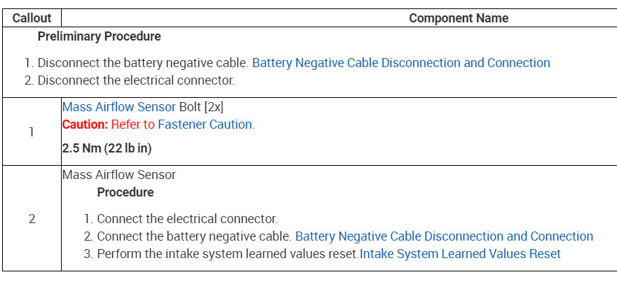

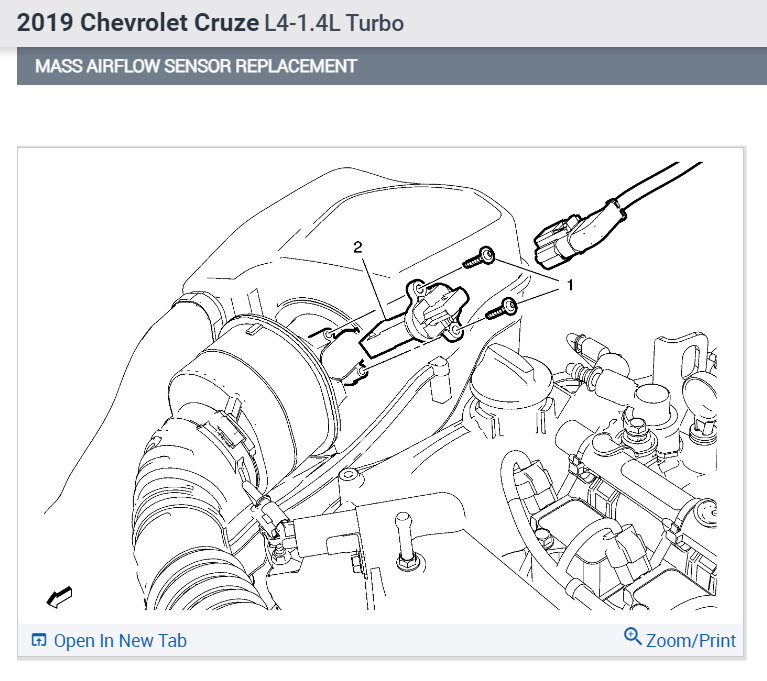

P1101: Mass Airflow Sensor Out of Self-Test Range
P06DD: Engine Oil Pressure Control Circuit Stuck Off
So, the codes that jump out at me are the MAF sensor and the oil pressure circuit. Please make sure the engine is full of clean oil with a new filter, also I would swap out the MAF sensor and then clear the codes.
