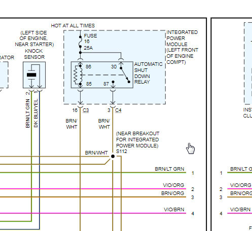

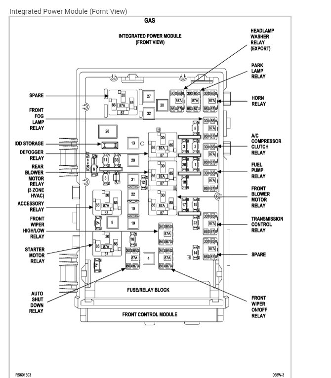

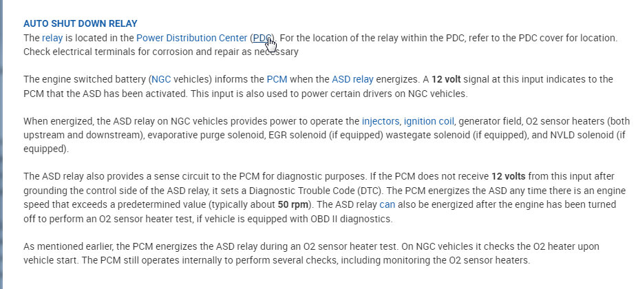

When this happens does the vehicle restart with no issue or does it take a while? One common thing that happens with these vans was the ASD relay would fail when hot and cause the PCM to just shut the vehicle off and no codes would set.
Not only could the ASD relay cause this but the integrated power module has been known to do it as well. If it were me, I would go ahead and replace the ASD relay and then see if it reoccurs.
Let me know if you have questions. Thanks
