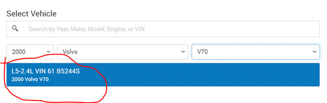

Can you provide me with the short term fuel trims? I didn't realize you had the scanner. Also, take a look at the picture below. This is the only option my manual is giving for a V70. Is this correct? Also, let me know the results.
Mar 28, 2020 at 8:45 AM
PROTONSNOW
  • 5 POSTS
Hi Joe,
No, that car is not correct. Mine is as listed above, Volvo V70 T5, 2,3 Litre Petrol, Turbo (184KW - 250HP).

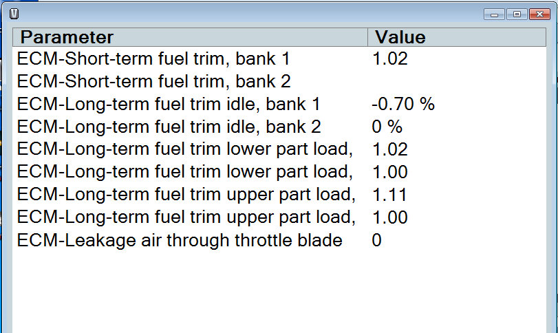

Mar 28, 2020 at 11:22 PM
PROTONSNOW
  • 5 POSTS
Here's the Info I just scanned at idle and car warmed up to normal operating temperature (see attached picture).
The first value oscillates between 0.99 and 1.02, all the others seem to remain the same.
Not sure why short bank 2 does not give a reading... Do I not have a bank 2 or does this indicate something wrong? (I had to google short term fuel trims, had never heard of this before).
Thanks Joe.
Mar 29, 2020 at 3:20 AM
  • 110,194 POSTS
The STFT in a perfect world would be 0. The idea that this shows a 1.02 indicates the computer is adding fuel to maintain the idle. If it was a negative number, the opposite would happen. So, are you certain there are no vacuum leaks? Fuel pressure is good and so on? Anything that can cause the computer to be adding more than normal fuel to the mixture?
