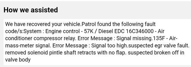

About a month ago my car lost power on the motorway from around 70 mph down to around 25 mph. i had to stop and restart again and that worked. but recently it has started happening more often. The power just drops, i put it in second gear put my foot too the floor and after about ten to fifteen seconds the power comes right back up.
Any ideas?

Just to add also, has the check engine light come as well? If it has can you have the codes retrieved. If you have codes indicating a behavior fault then a software update for the ECM should take care of the issue you have.

Hi guy's, this was the problem.

Glad you could get it fixed, that kind of problem can be tough. Please use 2CarPros anytime we are here to help.
