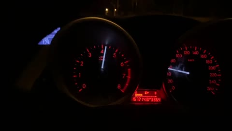

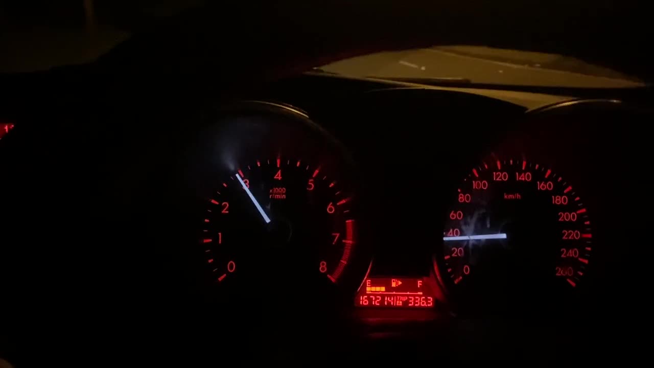

When I accelerate at full throttle, there is power, but when I hit a certain rpm, the power drops significantly. Between 4,000 rpm's and 5,500 rpm's, it feels like the car only has half its power, then at 5,500 rpm's, the power is back to full. Any idea what this could be? Video below.

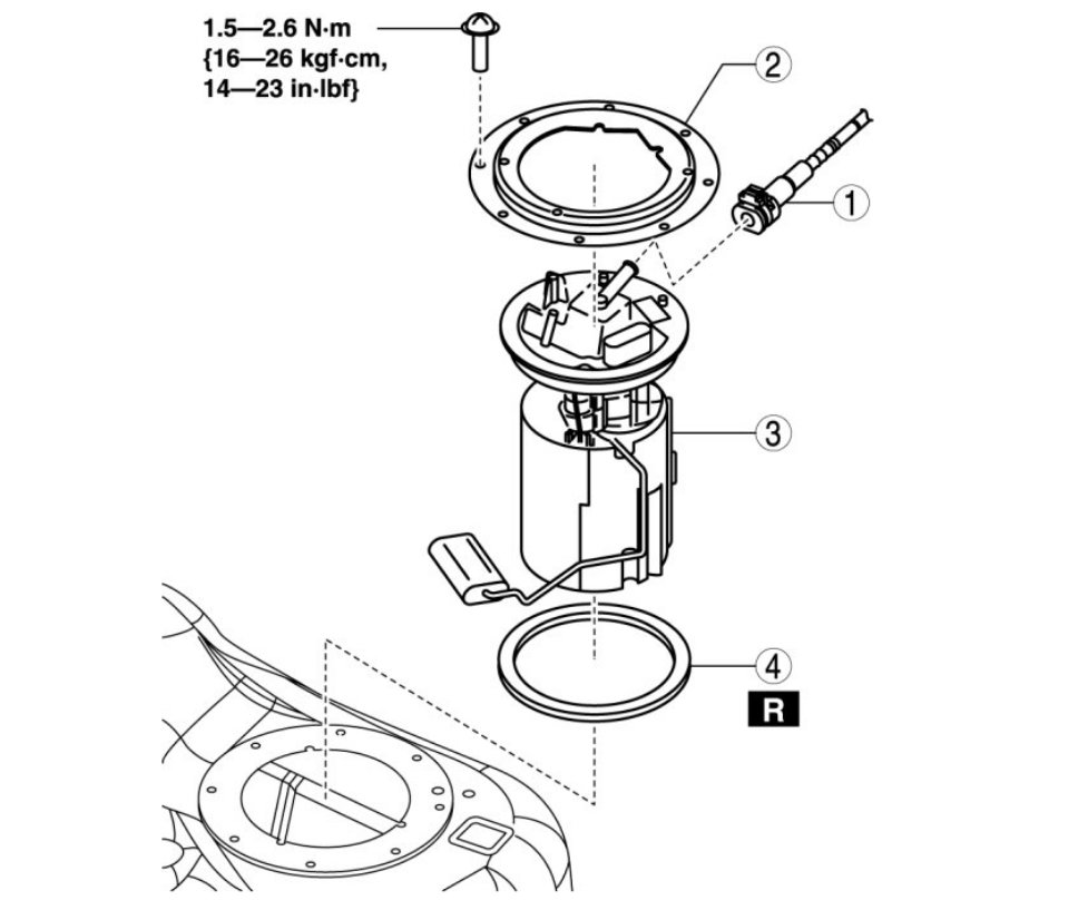

It could be a restricted fuel filter. The issue is the filter id part of the fuel pump.
No External Fuel Filter For Service, High Pressure Filter Part of Fuel Pump Unit
https://www.2carpros.com/articles/how-a-fuel-pump-works
https://www.2carpros.com/articles/how-to-replace-an-electric-fuel-pump
Another possibility is injectors. They may need to be professionally cleaned. Additives have no effect on cleaning the pindles.
FUEL PUMP UNIT REMOVAL/INSTALLATION [LF, L5]

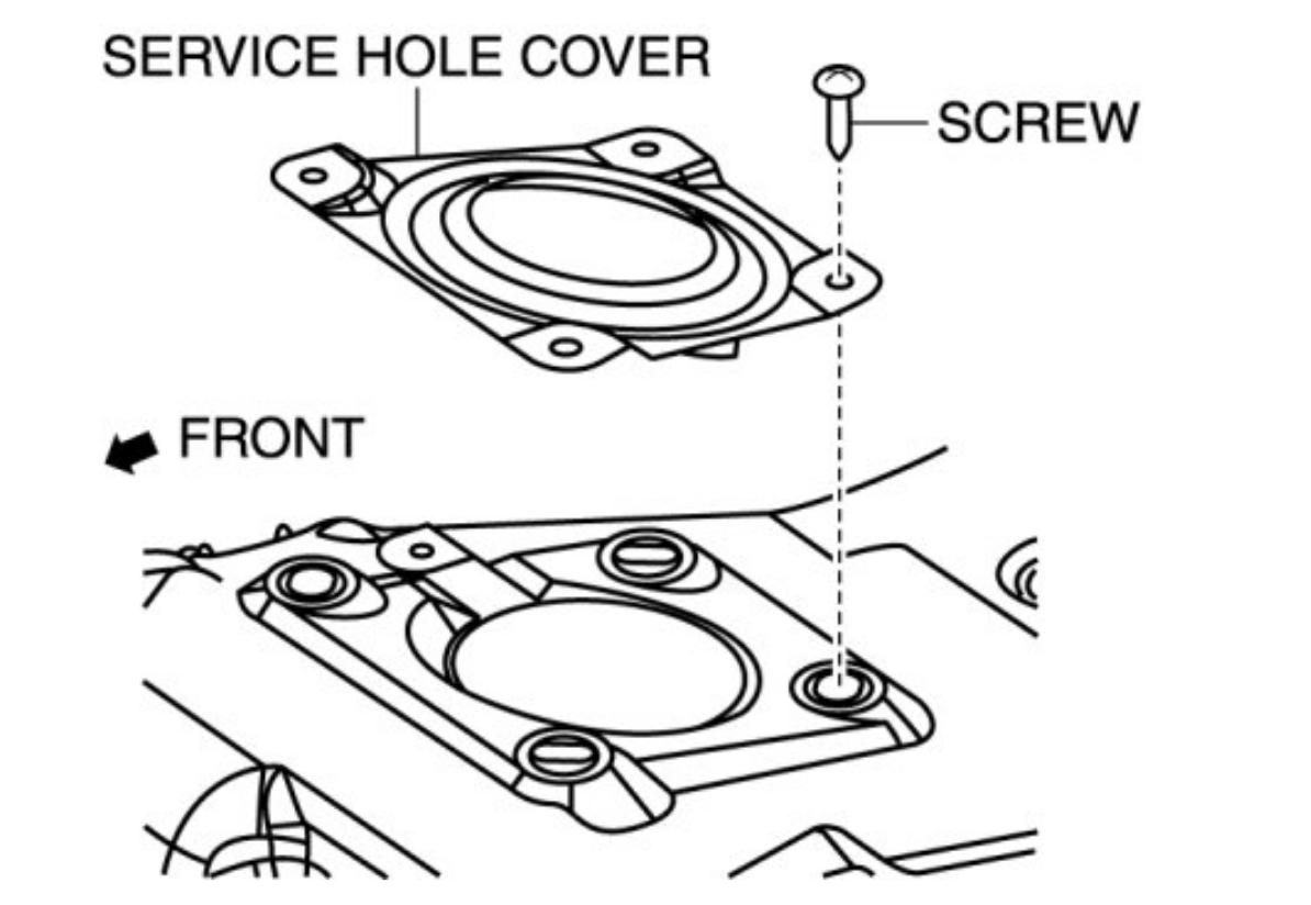

5. Remove the service hole cover.
