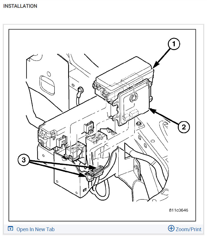

Loss of key fob, security, windows and door locks only work with key in the ignition and on?
180,000 MILES • 5.7L • V8 • 4WD • AUTOMATIC
AFREE2005HEMI
Replaced stereo and loss security no key fob and like stated above. windows and door locks only work if truck is turned on or running.
Please help!

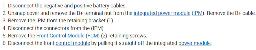

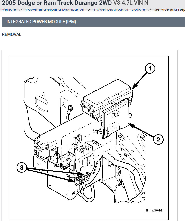

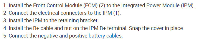

Since this post I have seen the IPM (integrated power module) have problems and cause this issue. We should do a CAN scan to confirm the issue. You can get a CAN scanner (Controller Area Network) which will work on most cars from Amazon.
https://youtu.be/u-4syLc-ifQ
Here is how to change the IPM out which is easy because the unit self learns. Check out the images (below). Please let us know what happens.
