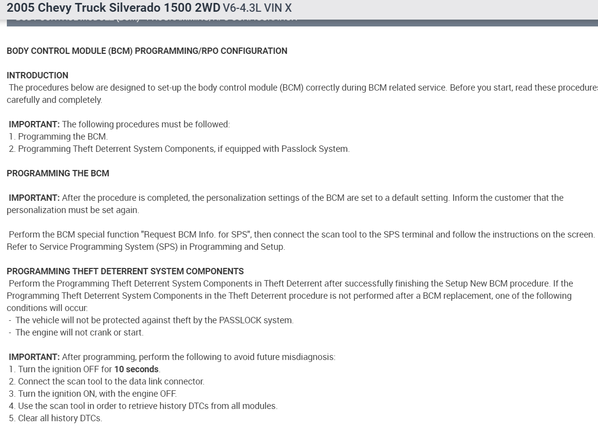

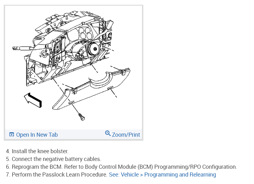

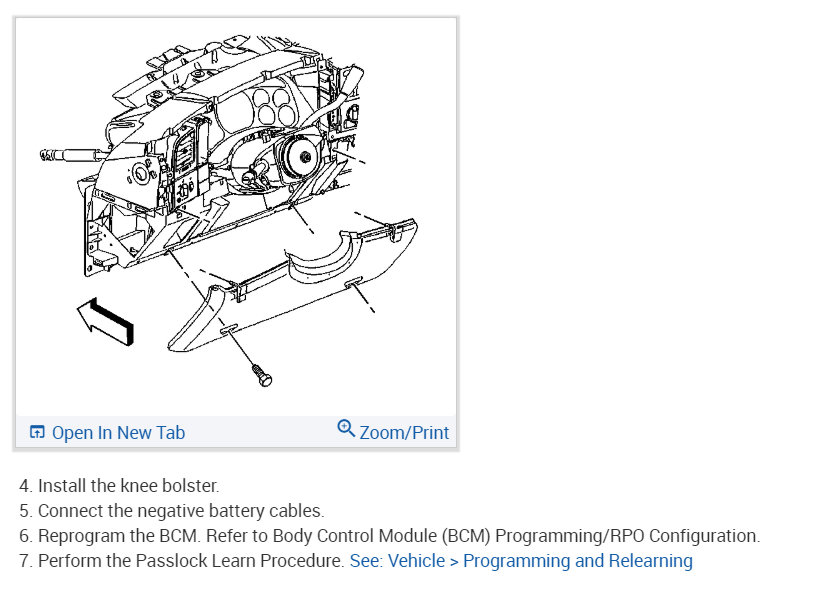

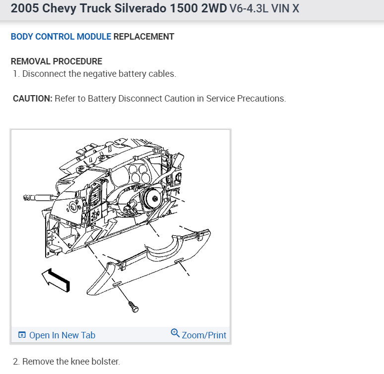

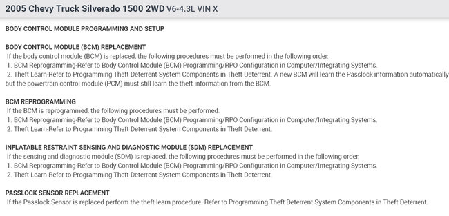

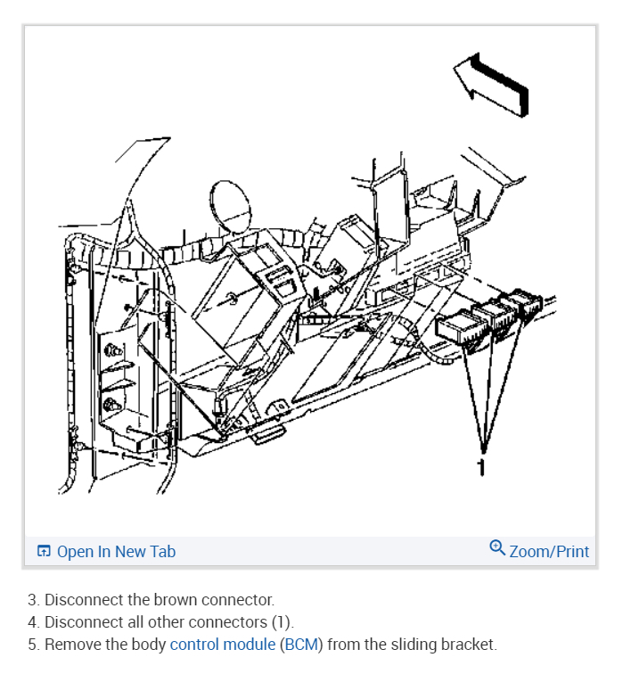

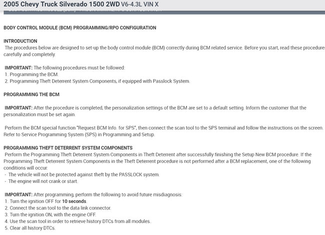

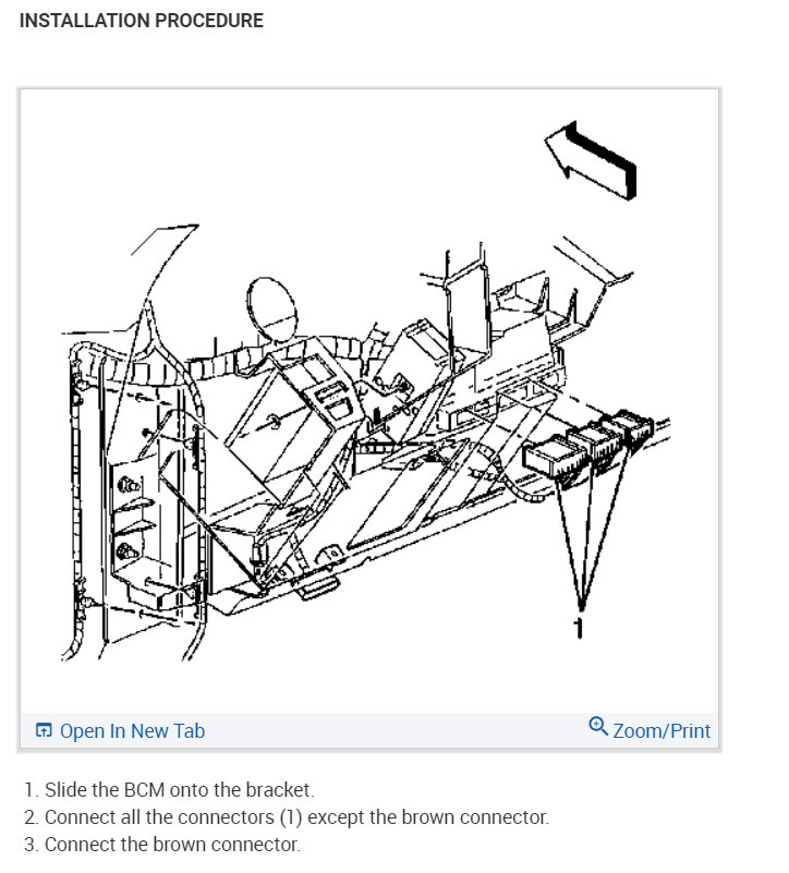

This sounds like a classic BCM going out, but to be sure you can get a CAN scanner from Amazon for about $30.00. here is a video to show you how:
https://youtu.be/u-4syLc-ifQ
Here is a scanner link:
https://amzn.to/3o41KcZ

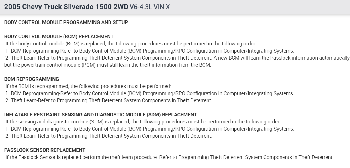

This guide can help as well also I have included the BCM replacement instructions in the diagrams below just in case:
Sunday, July 17th, 2022 AT 11:29 AM

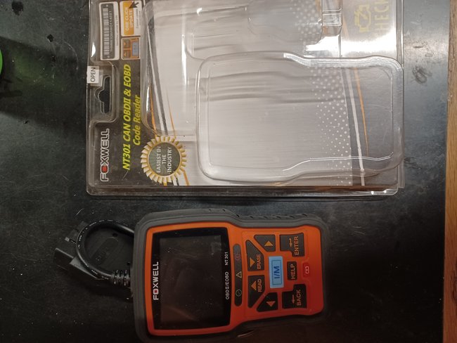

Okay, this is the scanner I got. Is this capable of doing what I need or would I need to buy the one you put the link to? Just wanted to make sure before I order it. Sorry I had a little bit of a hectic day just now am getting a chance to reply back. Going to take a video in a minute.

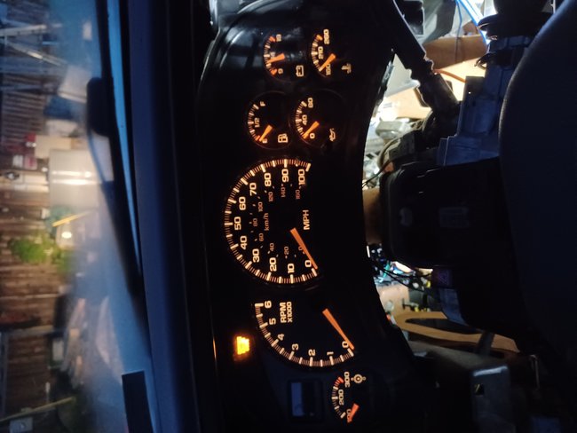

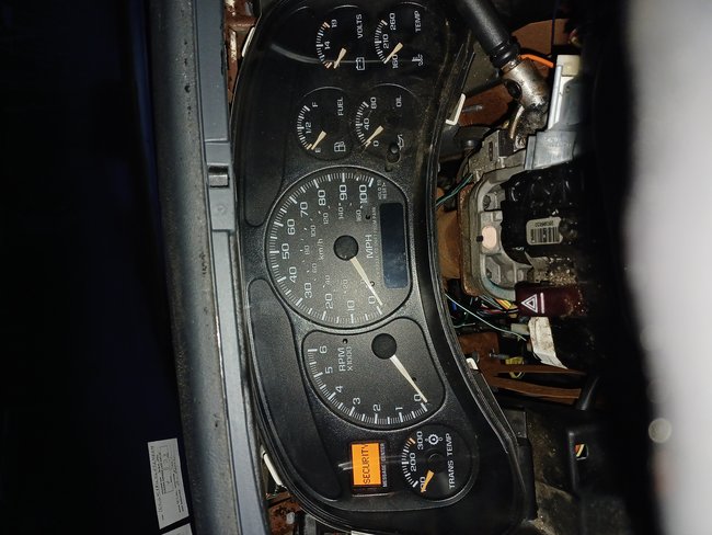

Well, I tried to put a video, but it won't work it says not enough memory or something so I'm going try and clear out my phone tonight. As it turns out anyway, I tried to start it and I guess it's not working now. So, I'm going to charge it for tomorrow and trying post a video then. I will post another picture though soon as this loads. But the first picture is key in the off position second will be with it turned to on.
Tuesday, July 19th, 2022 AT 6:06 PM
DYLANRL420
  • 7 POSTS
This is key turned. Everything looks just like this when it's running except the oil pressure works when its running.

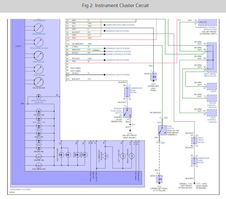

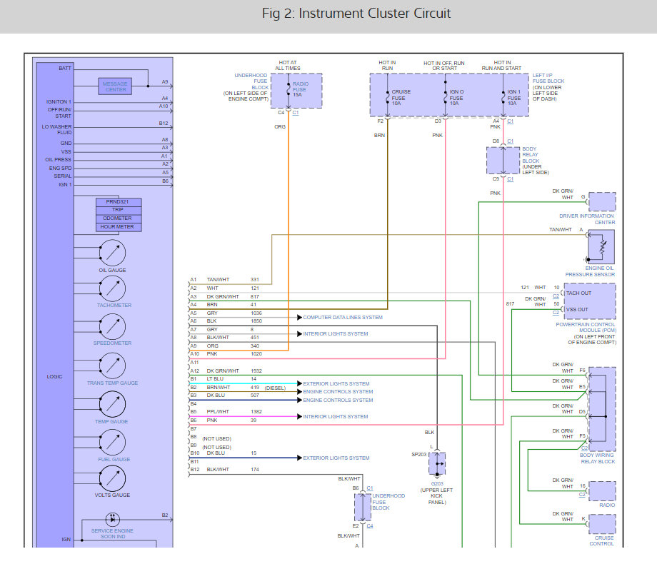

I was looking at the cluster wiring diagrams, and it looks like there is a ground by the upper left kick panel we should check. Also, let's recheck the fuses that run the clusters. Below are the wiring diagrams so you can see which fuses and how the system works. Check out the diagrams (below). Please let us know what you find.
