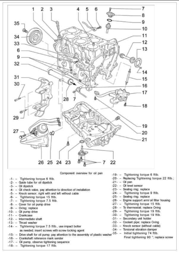

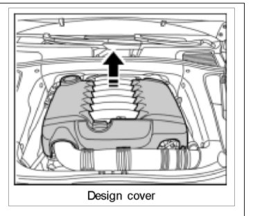

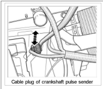

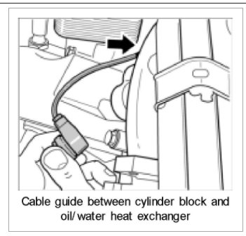

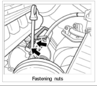

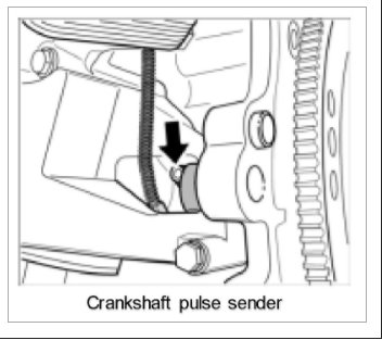

This sounds like you have a problem with the crankshaft angle sensor which is common with theses cars. When this sensor goes out it may not set a code. This is where I would start. Here is a guide to help you see what you are in for when doing the repair. Also did you replace the fuel filter?
Here is what the job will be like for your car.
Cheers
