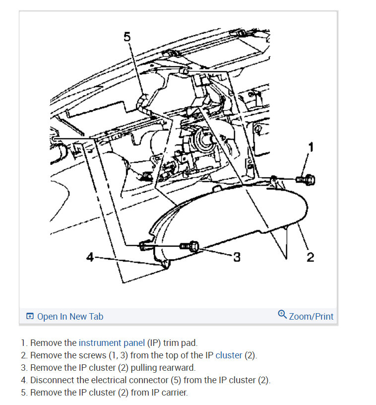

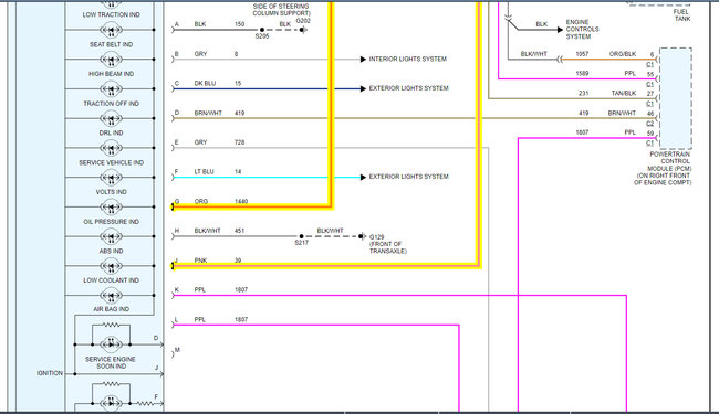

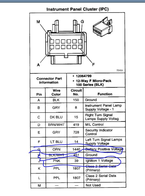

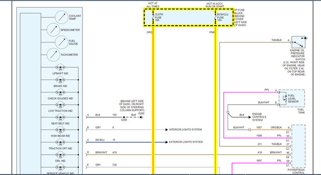

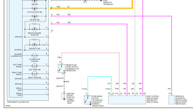

Good afternoon,
I attached the diagram of the cluster for you. There are 2 fuses that control the cluster. Check them and the wires at the cluster for power. The orange and pink wires should have battery voltage.
