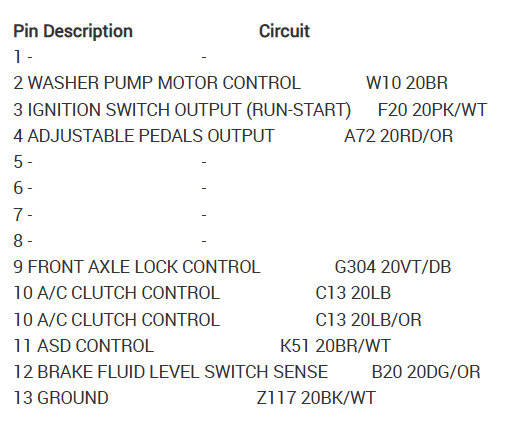

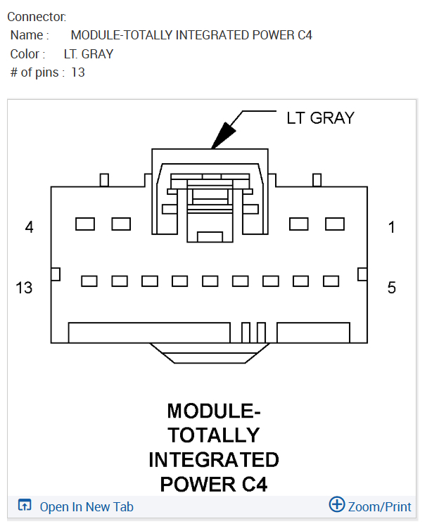

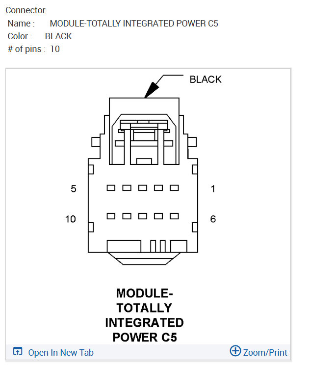

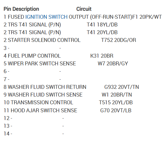

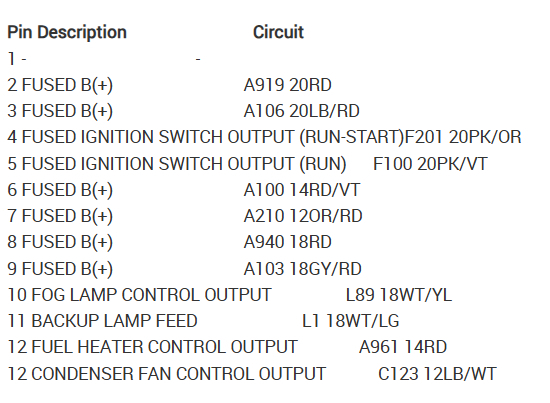

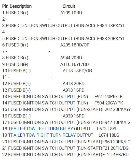

pinout diagram for the TIPM?
2007 DODGE RAM
155,000 MILES • 5.7L • V8 • 4WD • AUTOMATIC

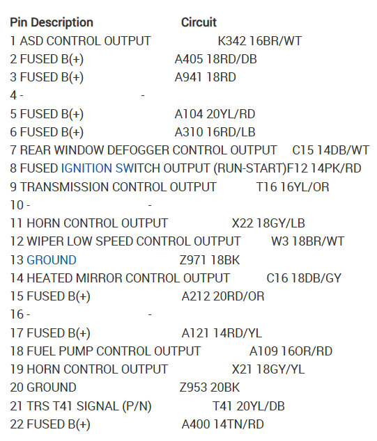

FIREMEDIC541

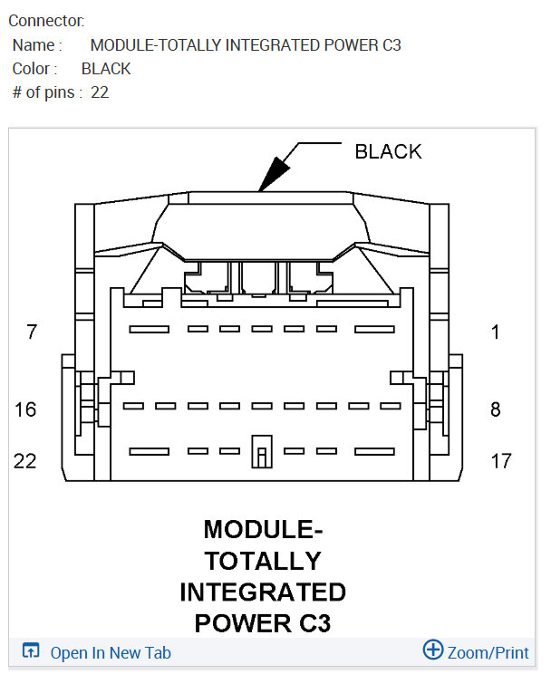

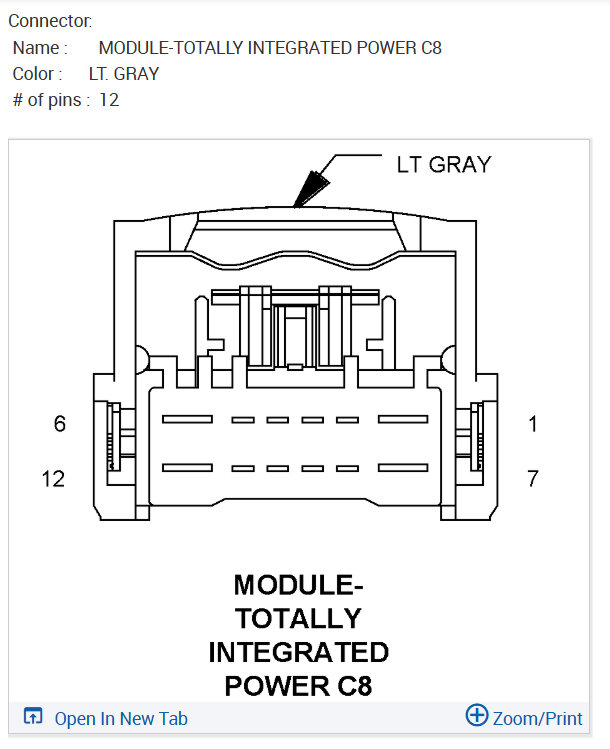

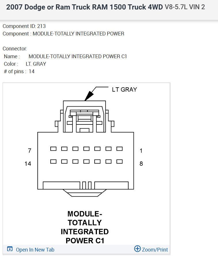

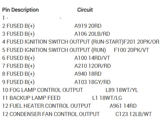

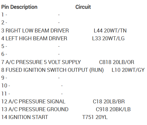

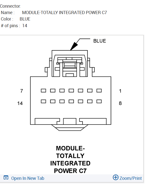

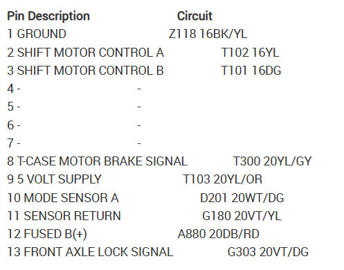

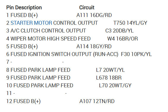

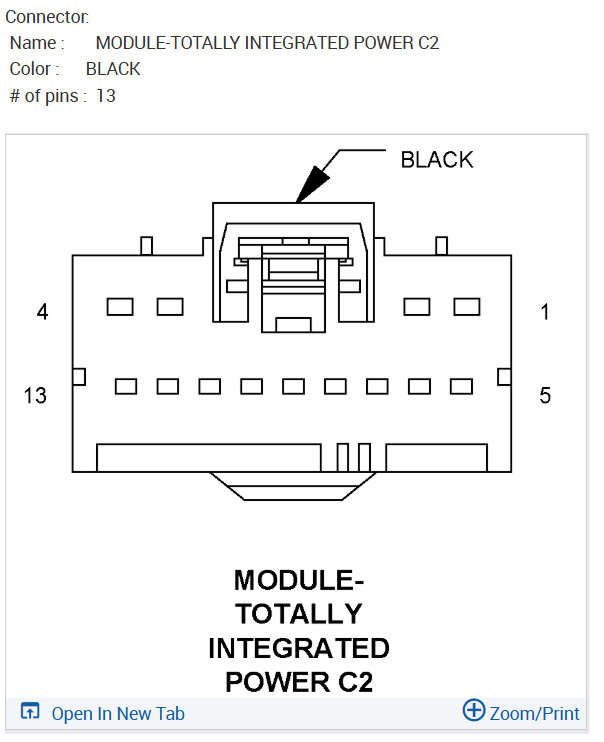

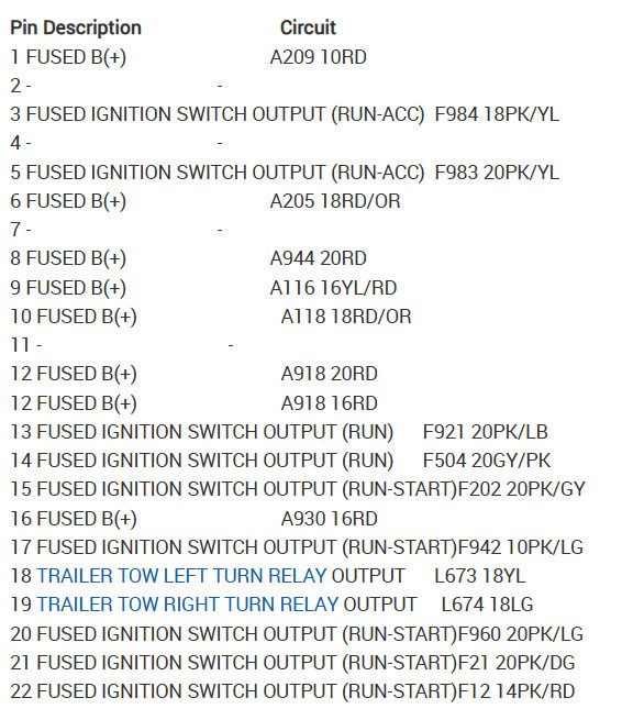

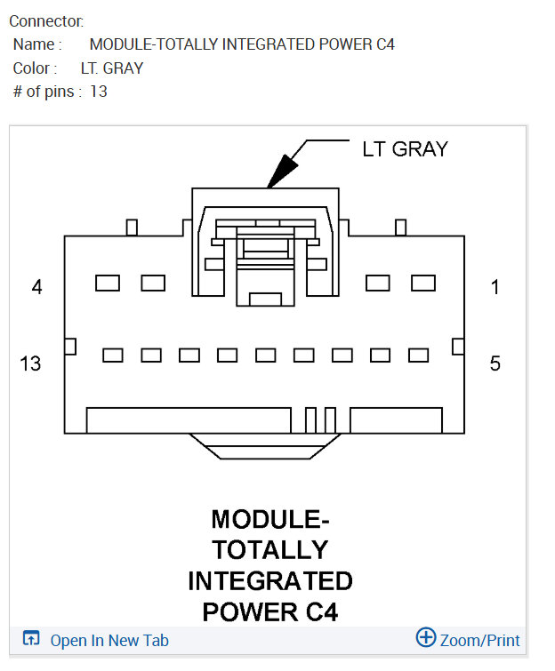

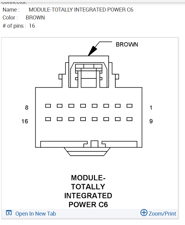

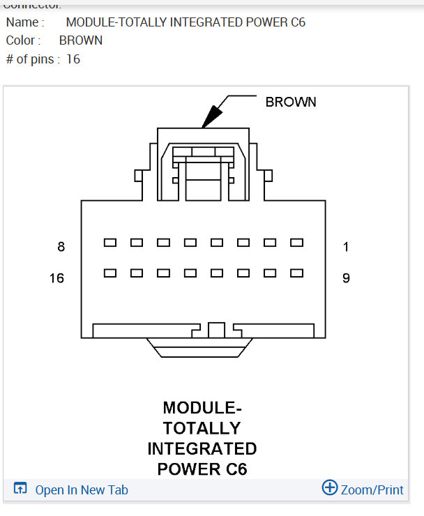

I’ve narrowed down my issues to the TIPM and fractured pins due to corrosion. Replacing the TIPM is outside of my financial capabilities at the present moment. I will need to place jumpers for the short-term solution. There is also a broken connector from the original tech/person when they are in it they broke the bail on the “brown” (I think) connector and need to address that also, long story short, I need a pinout diagram for the TIPM to an 07 Ram 1500 5.7 Laramie. Thank you very much.
May 18, 2025 at 1:49 AM
  • 55,443 POSTS

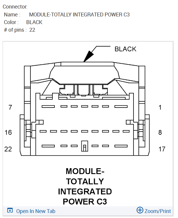

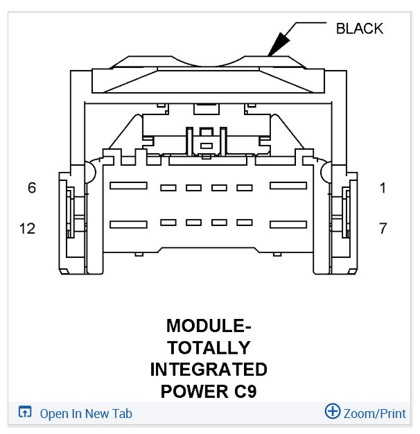

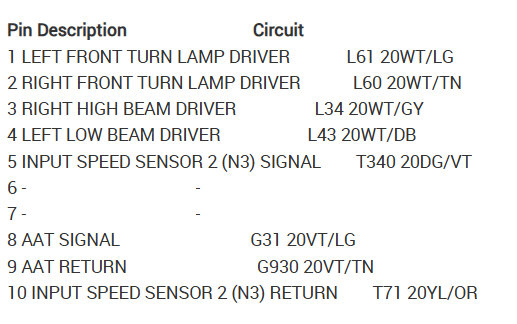

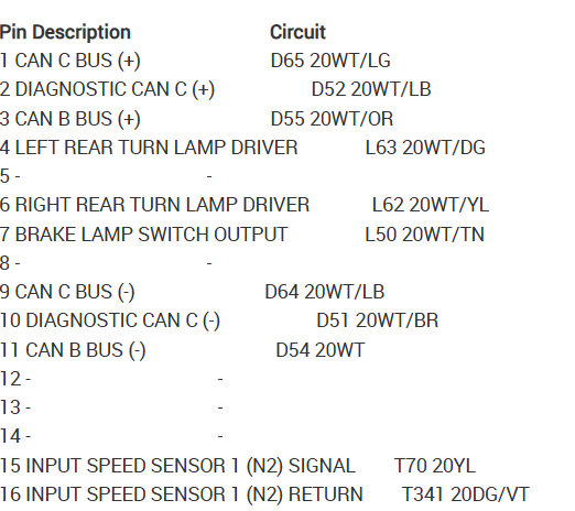

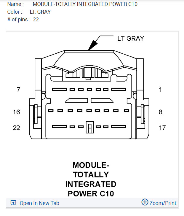

I would try ebay for a used part. I have had good luck with there used parts FYI. here are the TIPM electrical connector pin out diagrams as requested. Check out the images (below). Let us know if you need anything else.
May 19, 2025 at 5:07 AM
