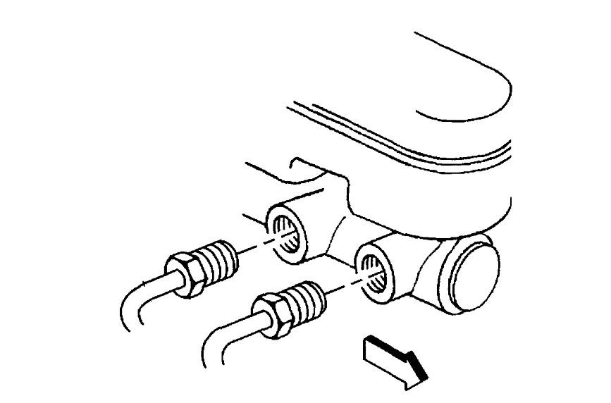

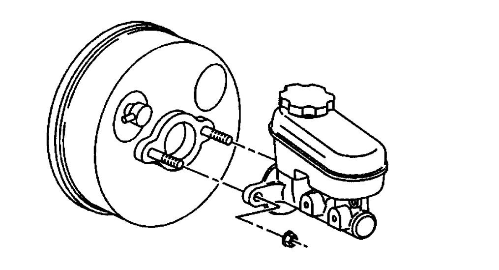

I just recently lost about half of my brake pedal in pressure. I checked lines, calipers, pads, the works. After having changed the front calipers (with OEM spec parts) but still haven't regain my pressure. Lines were properly bled.
Jun 9, 2019 at 10:46 AM
Good afternoon,
This sounds like you have a bad master cylinder.
https://www.2carpros.com/articles/how-to-replace-a-brake-master-cylinder
There are two sections in the master and one part may have failed.
