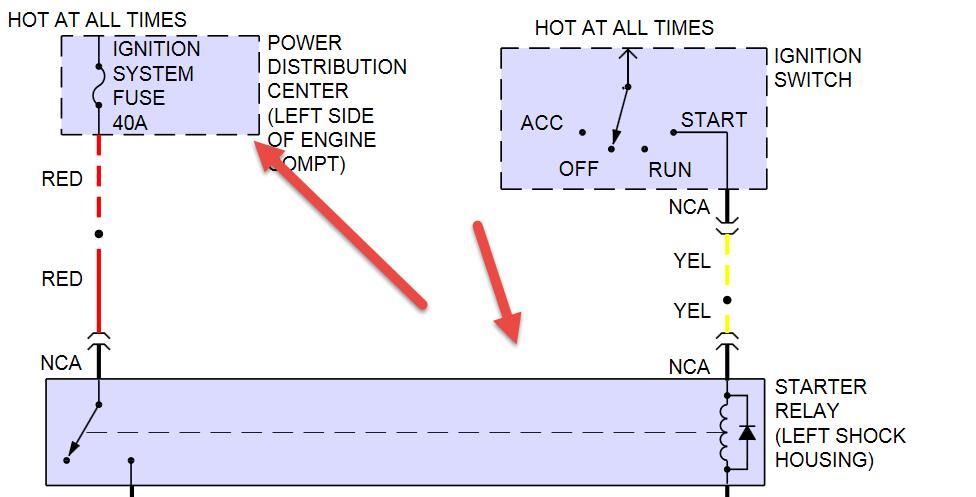

I have changed the ECM and now it will not crank at all. I checked to make sure if maybe it needed to be programmed but it says it is programmed before it ships. What now???????
Feb 1, 2015 at 1:20 PM
HMAC300
  • 48,601 POSTS
check items in pic then if it doesn't work have a local pro look at it
