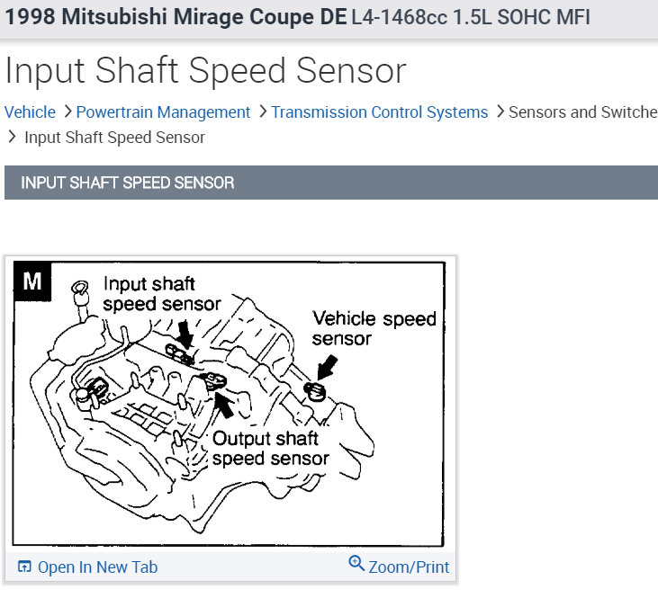

Does the speedometer work I think is the response Joe was looking for. It sounds like it could be the turbine speed sensor. Here is the location so you can check it out. Please run the codes as well.
