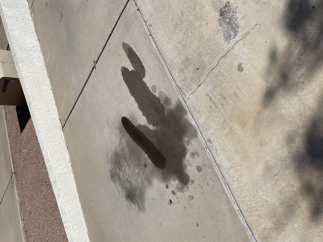

just changed my oil less than a week ago. i had to replace the oil pressure sensor. i noticed a lot of oil underneath the engine but only a few drops on the driveway. So, i know i’m losing more oil while driving the car. does that sound like the rear main seal? i don’t have any oil residue on top or around the car, just mainly underneath the vehicle.
Aug 5, 2022 at 2:08 PM
  • 110,240 POSTS

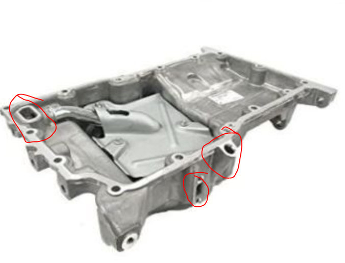

If this started since the oil changed, confirm the drain plug is tight and check around the oil filter to make sure it isn't leaking from there.
If it has been an ongoing issue and it is dry from the top, yes, it could be the rear or front main seal, or the oil pan itself.
Also, if I recall, the pan is aluminum, so check for cracks. The dipstick tube and level sensor can leak as well, so check that too.
Let me know what you find.
See pic below.

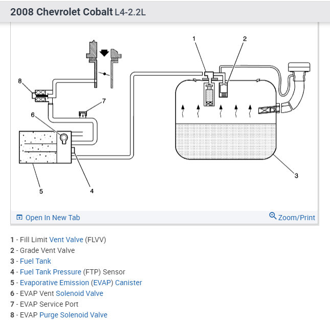

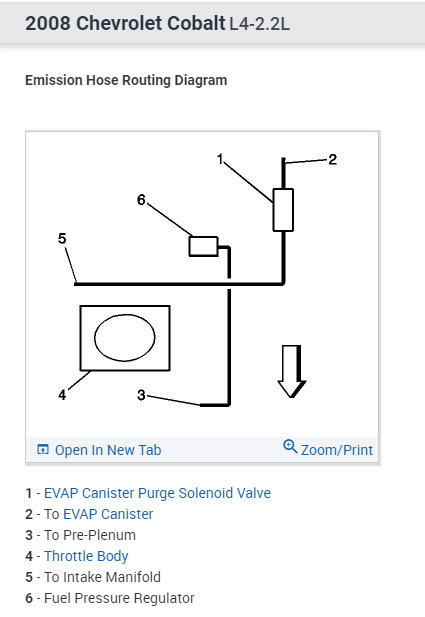

i have Wednesday and Thursday off. i noticed lately when I accelerate there’s a whistle like noise that I didn’t hear before. Didn’t know if you can send me the vacuum lines diagram for the 2008 Cobalt 2.2 LS manual coupe has over 130,000 miles on it. I will be able to remove the starter and look where the oil pressure sensor is and make sure it's on hand tighten snugged. I changed the oil about two weeks ago. I’ve been checking the oil and only had to add oil to it a couple of days ago. i checked around the engine for no buildup of the engine oil but I haven’t checked underneath the vehicle where the control arms underneath the crossmember bar. hopefully if its leaking from the seam between the engine and oil pan right by the oil pressure sensor. Will see Wednesday.
Aug 14, 2022 at 2:05 PM
  • 110,240 POSTS
I attached what I have for vacuum schematics. I hope they help. As far as the oil leak, has it gotten better?

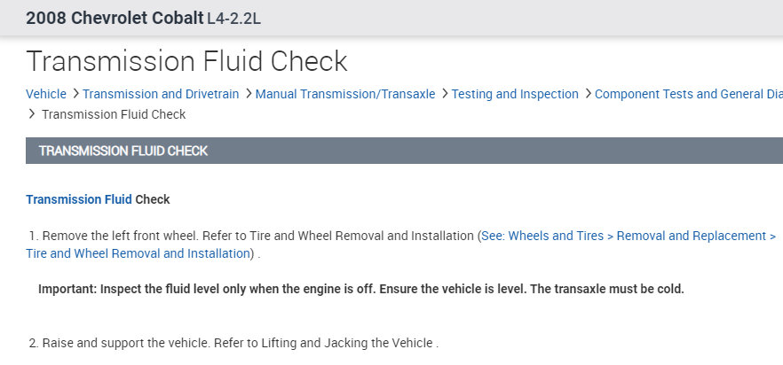

Well, I checked my oil levels lately and not losing anything but what else could i be having liquid dripping from? I bought some transmission fluid and how can I check if my transmission fluid is low? Since I don’t have a tranny fluid dipstick.
Sep 14, 2022 at 2:03 PM
  • 110,240 POSTS

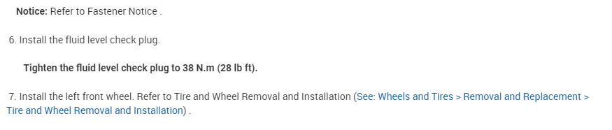

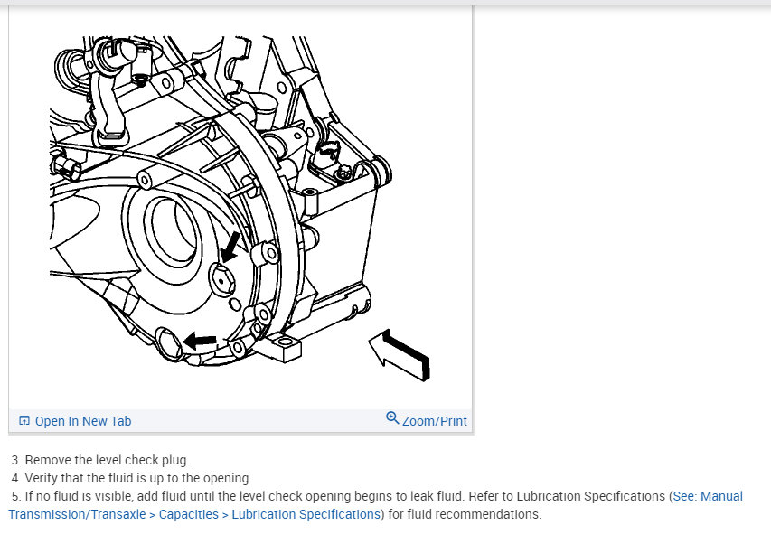

To check the fluid level, you need to remove the left front tire to access the fill plug. Do this with the engine cold and the vehicle has to be level.
I attached the directions below. Note: There are two plugs with arrows pointing to them. The upper plug is the fill and check. When you remove the plug, the fluid should be level with the lower part of the plug opening. If you want to drain the transmission, the lower plug is the drain.
Let me know if this helps or if you have questions.

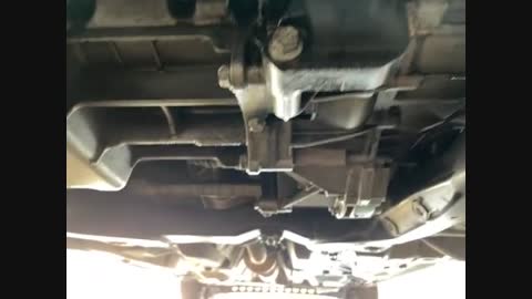

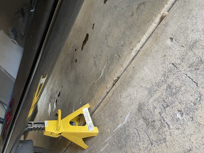

I noticed spots on the driver's side underneath the vehicle that it didn’t look like oil but more like brake fluid perhaps. As I was pulling it in the garage i gave it high RPMs as I was going the garage and I noticed the spots underneath but that was when I had highly accelerated. Now that i have the car jacked up and on jack stands going to see where exactly its coming from. Also, will be checking the brake fluid to see if it needs to be topped off.
Sep 16, 2022 at 8:28 AM
AZDANNO04
  • 363 POSTS
When I had pushed the acceleration pedal a bit much when going in the garage. As they say, things happen for a reason, that was how I was able to see the drips.
Sep 16, 2022 at 8:30 AM
AZDANNO04
  • 363 POSTS
Yes, it smells like transmission fluid.
Sep 16, 2022 at 8:36 AM
  • 110,240 POSTS
Is the leak from the transmission pan or is a plug leaking?
For some reason, I can't get the video to play so you may have already answered the aforementioned question.
Update, I got it to play. The dripping appears to be below where the axles are located. Check to see if there is fluid coming from the axle seals and running down.

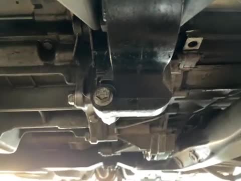

AZDANNO04
  • 363 POSTS

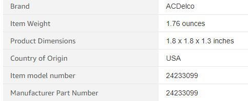

Don’t know how long that’s been missing but explains the loss of fluid i placed in the top for the transmission fluid. What’s plug size replacement?
Sep 20, 2022 at 4:46 AM
  • 110,240 POSTS

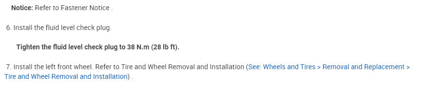

Is that the drain plug that is missing? As far as the part, I believe the OEM part number is 24233099. The specifications are listed below.
Let me know if this helps.
See pic below.

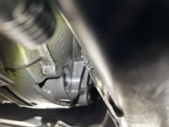

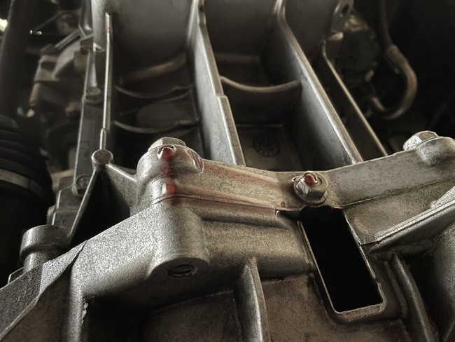

I place the drain plug in but i see where the other leak is coming from.
Sep 22, 2022 at 2:01 AM
AZDANNO04
  • 363 POSTS
From the bottom.
  • 110,240 POSTS
I'm having trouble orienting myself in the pic. I do see fluid; I just can't picture exactly what I am looking at. You indicated you can see where the other leak is coming from. What is leaking?
Sep 22, 2022 at 12:28 PM
AZDANNO04
  • 363 POSTS
The photo I sent was taken on the driver’s side front of the vehicle. Underneath the transmission there’s an opening where you can see the teeth on a gear and there’s a bolt in the center with a flange that's a 10mm bolt and next to it from Front and back of that bolt are two that are the same size that are 19mm or 18mm the heads are facing the passenger side wheel. The picture that you sent me of the transmission vent bolt and transmission drain plug photo of where the location. Just picture those on the opposite side of the transmission. Looks the inner bell housing inner seal is leaking in order for that to be coming from there and the rear seal. I did not want to go through that whole process when i had replaced the pressure plate, clutch disc, slave clutch. I don’t have a vehicle lift or engine hoist transmission jack. Those three things would help. I decided to take it to a transmission shop. Mechanic quoted under $750.00 and would have finished Friday but he called me Thursday early evening just left a message to call them back. It couldn’t be any more components? Just the seals need to be replaced. Also, I didn’t seize up the transmission and burn out the clutch. If anything, possibly have the clutch disc turned.
Sep 22, 2022 at 10:35 PM
  • 110,240 POSTS
The clutch disc really can't be turned. The flywheel could, but not the disc. Have you been able to get in contact with the shop? Also, if the clutch is saturated, it will likely need to be replaced. I hope that isn't why he is calling.

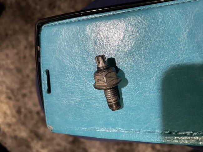

AZDANNO04
  • 363 POSTS
This is the bolt I found by the passenger side between the firewall, and I believe the A/C compressor tucked in an area. It does look similar to the ones that bolt the exhaust manifold.
Oct 5, 2022 at 11:26 PM
AZDANNO04
  • 363 POSTS
Yes, it looked like it came from the exhaust manifold, looked up the parts and looked very similar! Darn mechanic wouldn’t admit he snapped one of them off.
Oct 5, 2022 at 11:35 PM
  • 110,240 POSTS
That is what it appears to be. Was that on the exhaust manifold? Can you see one missing?
