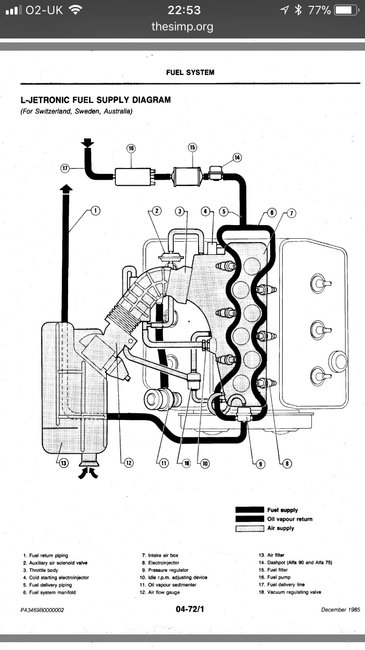

Check fuel return line. is fuel flow here increasing? is fuel dumping back into the tank? if a closed loop system, not a return line system. the problem will have to be at the pump still. i am trying to locate a schematic for this fuel system. it is a bit hard diagnosing with out knowing exactly how the system works.
Dec 5, 2017 at 5:25 AM
JACKOCOOPER
See attached image. I hope you can read that.
I understand. The pressure regulator may be sending too much fuel back to the tank? Why would this only happen occasionally? When the car has been running a few minutes?
Dec 5, 2017 at 7:02 AM
MHPAUTOS
  • 31,937 POSTS
There may be silt or fine rust in the fuel rail and it is getting stuck under the pressure regulator metering valve.
