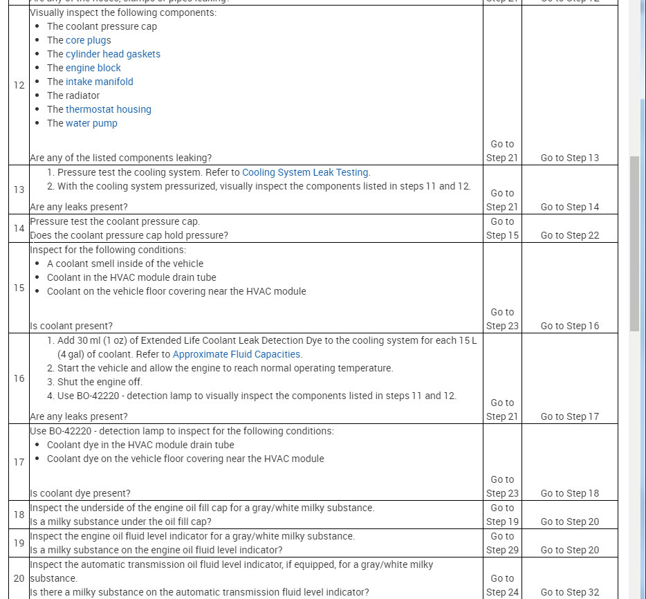

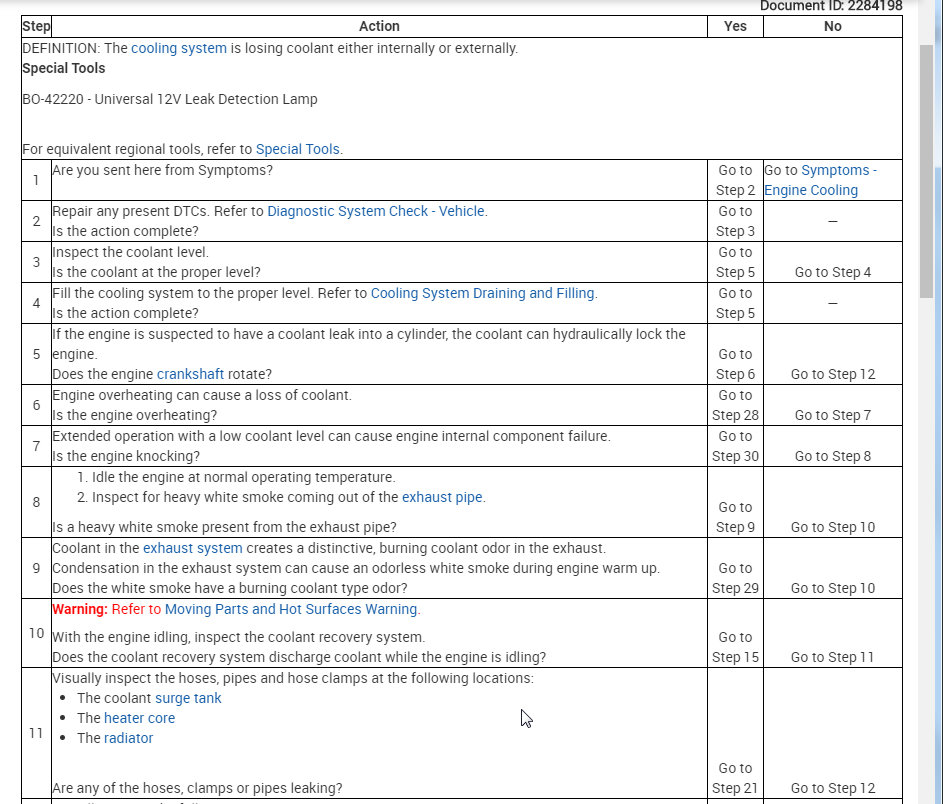

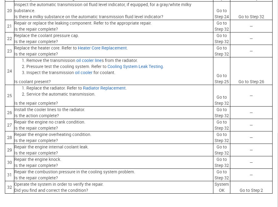

If you are loosing coolant that quickly then it can only be going one of three places. An external leak, leaking into the engine, or leaking into the HVAC system through the heater core in the housing.
I attached some steps that will run through some basics.
https://www.2carpros.com/articles/coolantantifreeze-in-the-engine-oil
If you do not find anything here then we need to pressure test the cooling system to see if we can find a leak.
https://youtu.be/W8kra65m15c
Let me know what you find with this info and we can go from there.
Jan 20, 2020 at 2:53 AM
TOUGHDIVER
  • 226 POSTS
Dan, it could also be leaking into the transmission at the transmission oil cooler located inside the radiator inspect the transmission for signs of antifreeze it will look pinkish milky color and stop driving it immediately and repair it and flush transmission. I know not everyone has a radiator pressure tester laying around but another good way of finding a coolant leak is to add antifreeze tracer dye it will show up bright neon color with tracer dye glasses on. Check the radiator, hoses, engine block, engine oil cap and motor oil, the exhaust at the first O2 sensor, heater core, transmission oil cap and fluid, and anywhere else it could leak antifreeze. I'm attaching repair guide for checking coolant leaks. Let us know if this information is helpful or if you need more info.
https://www.2carpros.com/articles/radiator-pressure-test
