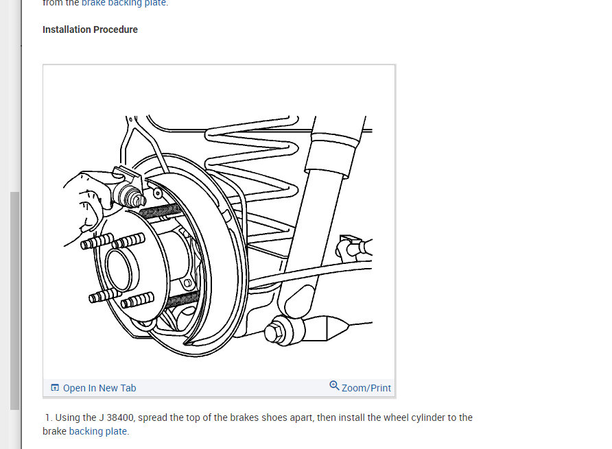

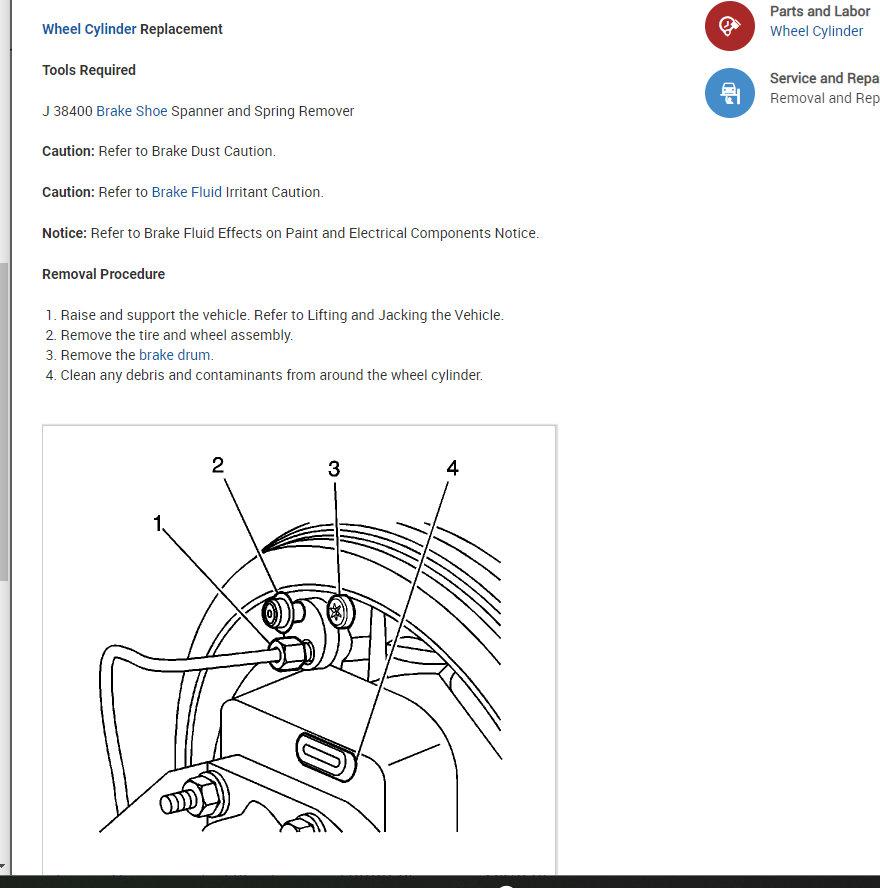

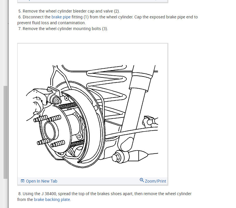

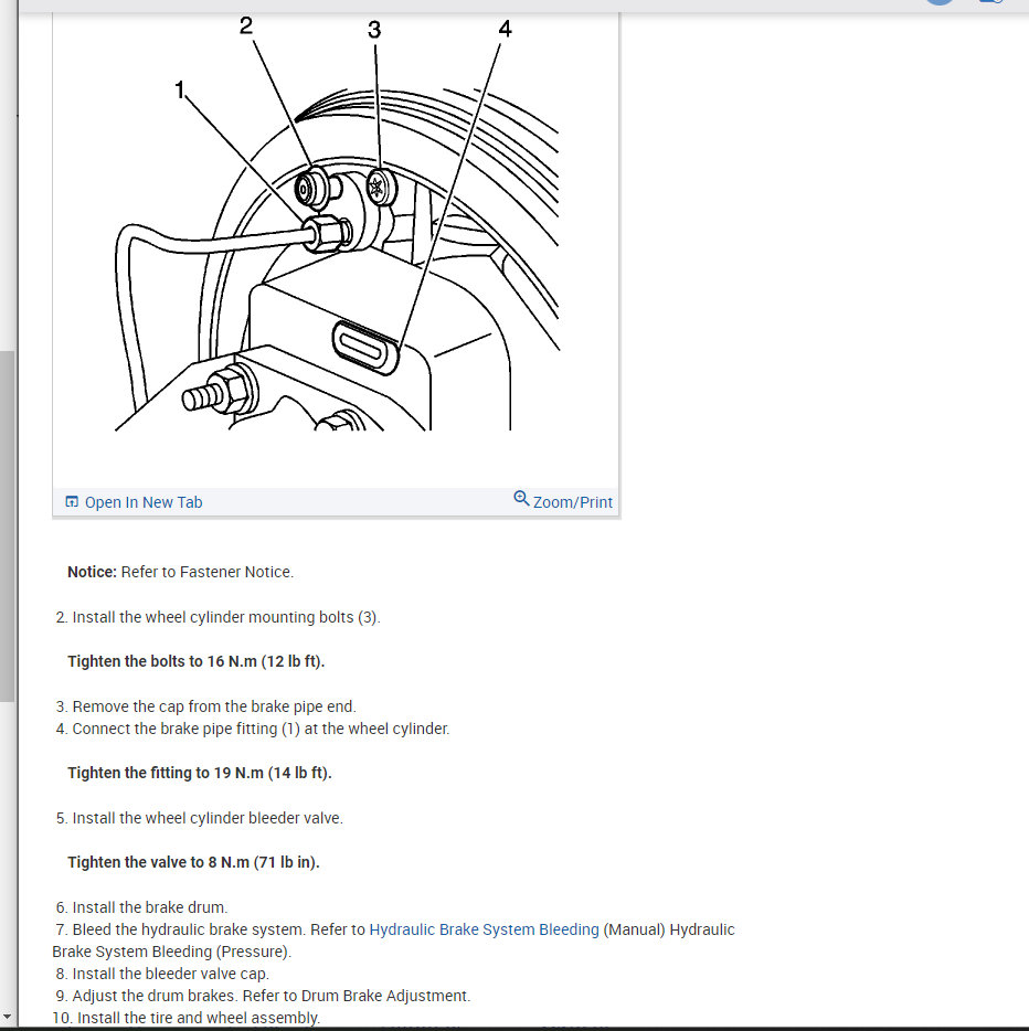

If you are adding an ounce of brake fluid, then that is the first issue that needs to be addressed. Clearly this is not a good thing because if that leak gets worse it could cause you to have no brakes one day while you are driving.
More than likely you have a wheel cylinder in the rear that is leaking so you may have to remove the drum to find the leak.
So, I attached the info below that will help with this.
