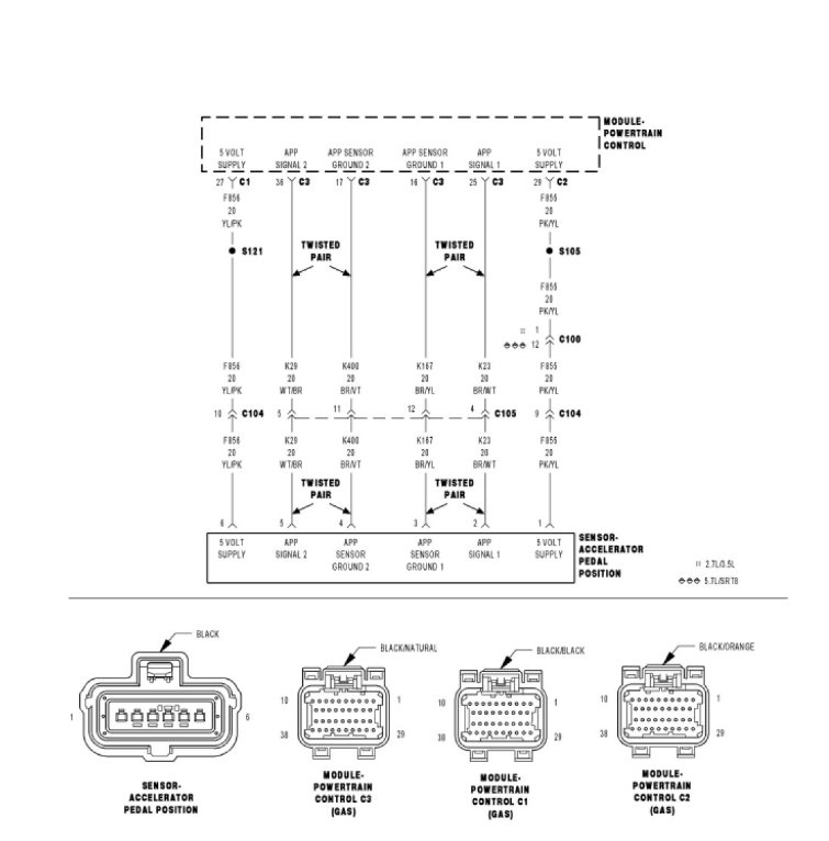

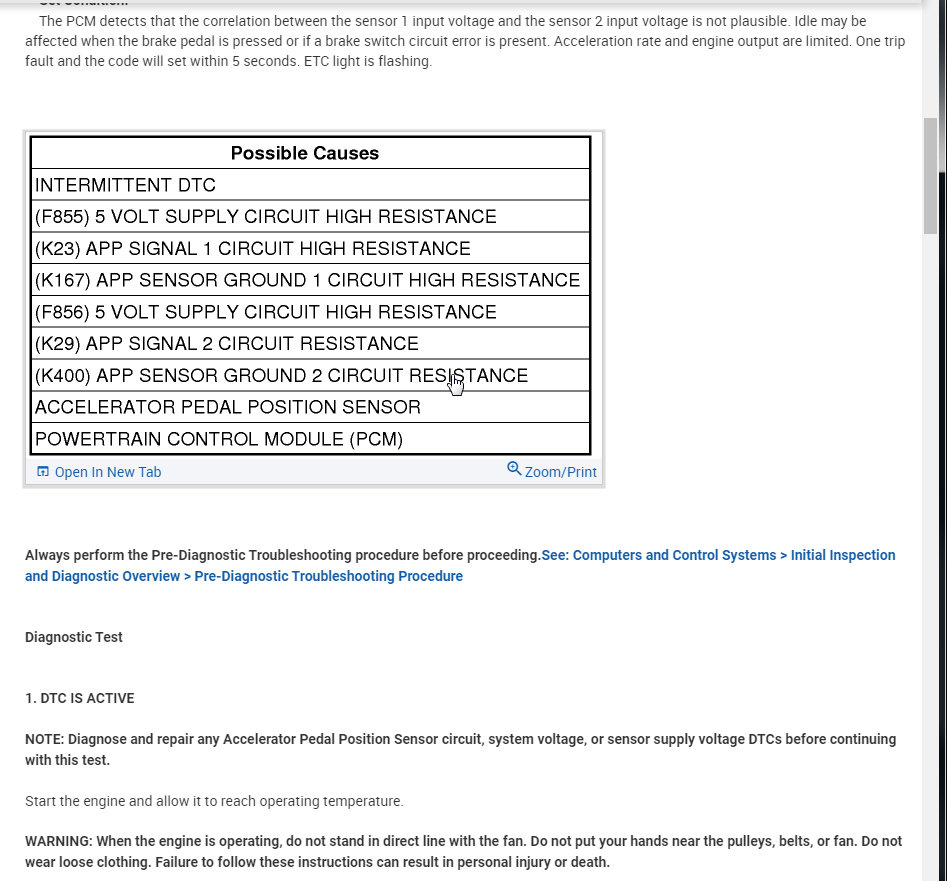

When I'm driving my cars throttle sometimes randomly shut down. The power in the car is fine when it does that it's just that. I replaced my pedal sensor throttle body and pcm. I cannot figure this out. Sometimes I have to hold my pedal down 3 seconds then it starts moving slowly and I can get to 60 moh in about 35 seconds.

Yes p2122, p2127, p2138.

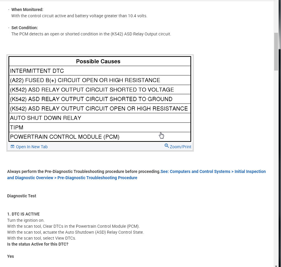

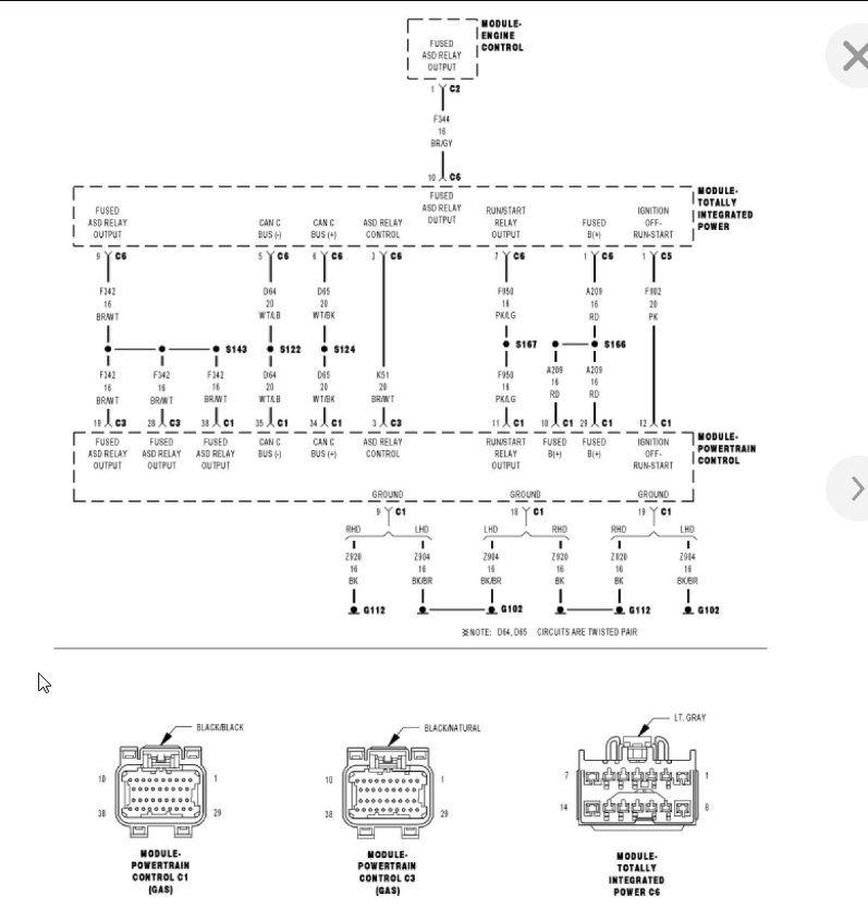

Also p0688. sorry

And I did replace the app sensor and whole pedal that was with it.

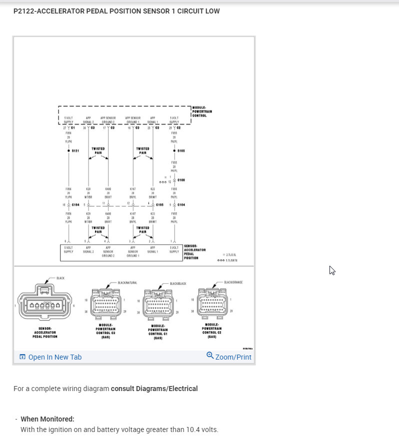

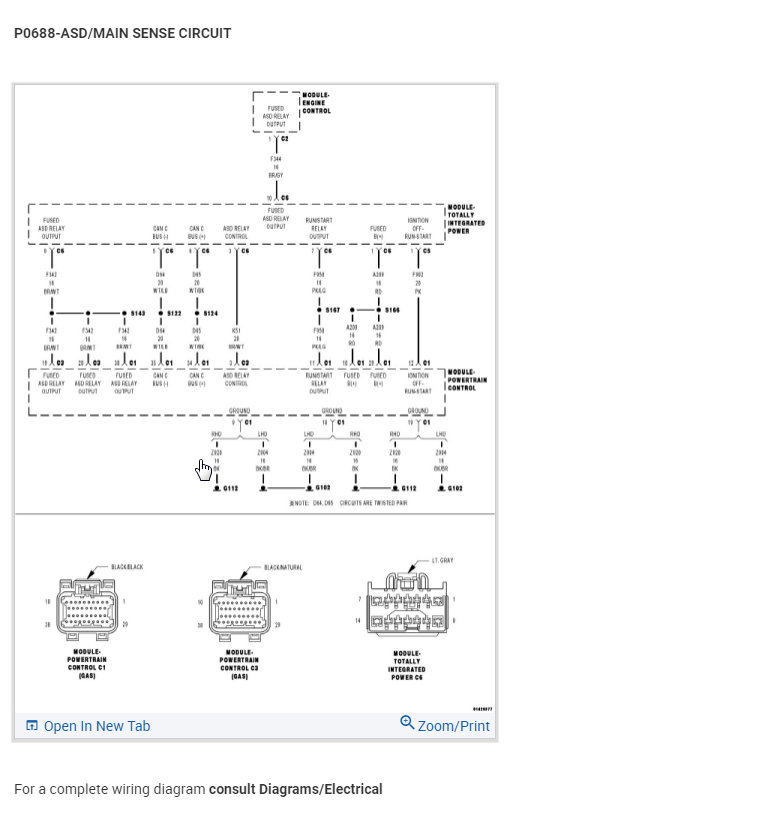

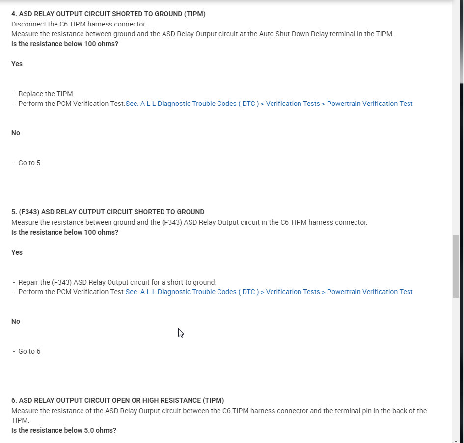

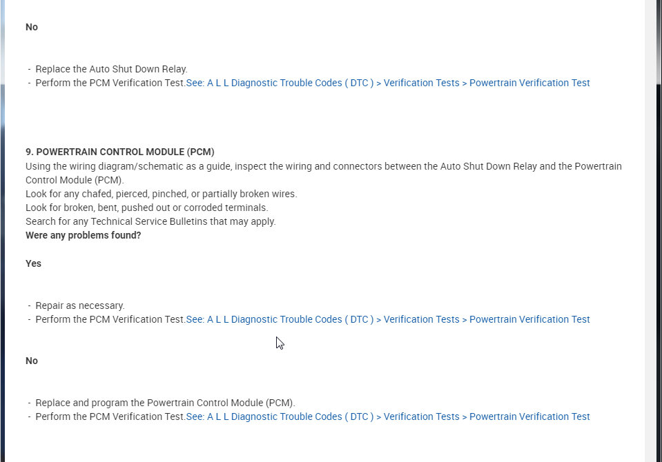

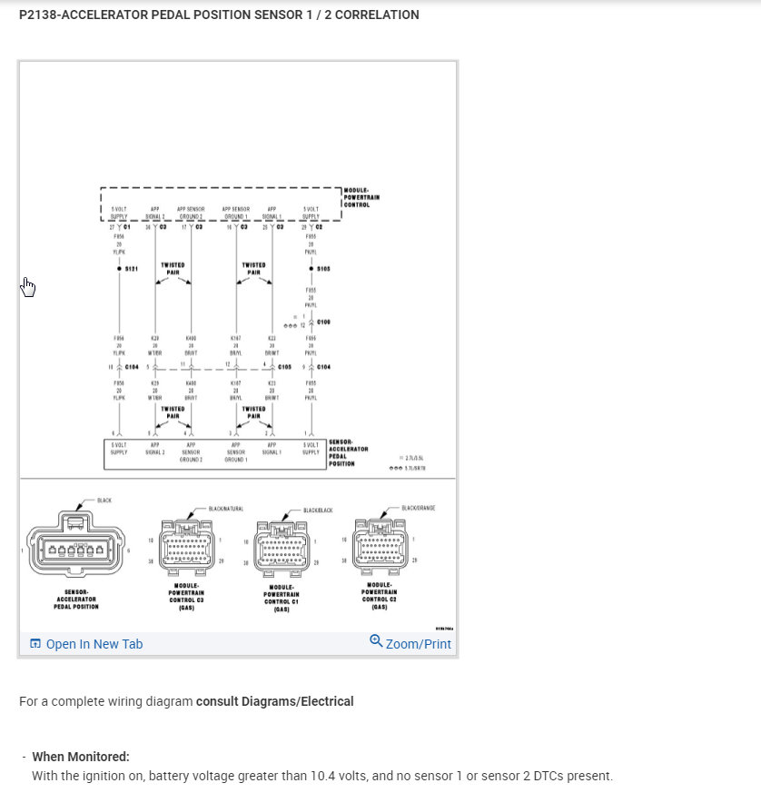

P0688 - ASD Main Sense circuit
P2122 - APP Sensor 1 circuit low
P2127 - APP Sensor 2 Circuit Low
P2138 - APP 1 and 2 Correlation

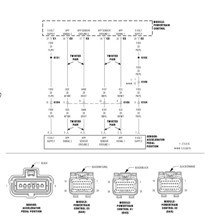

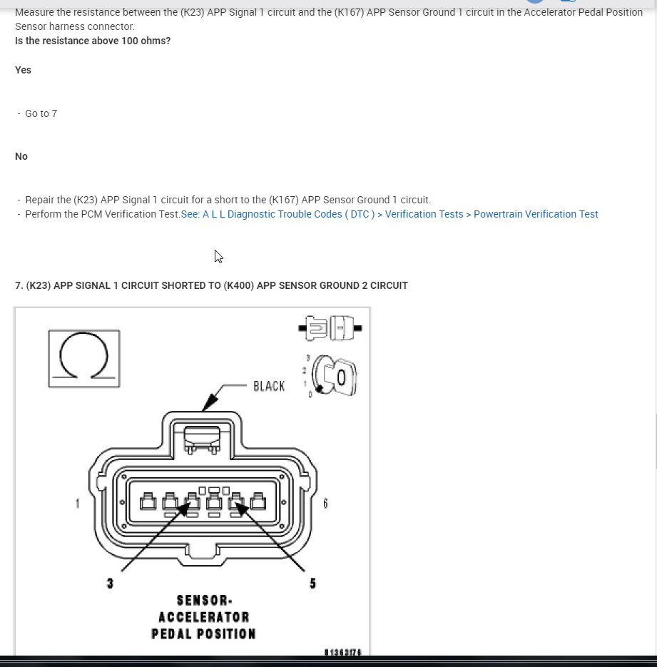

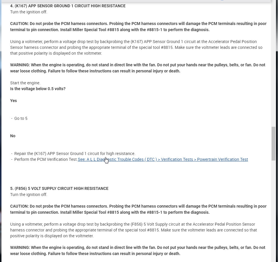

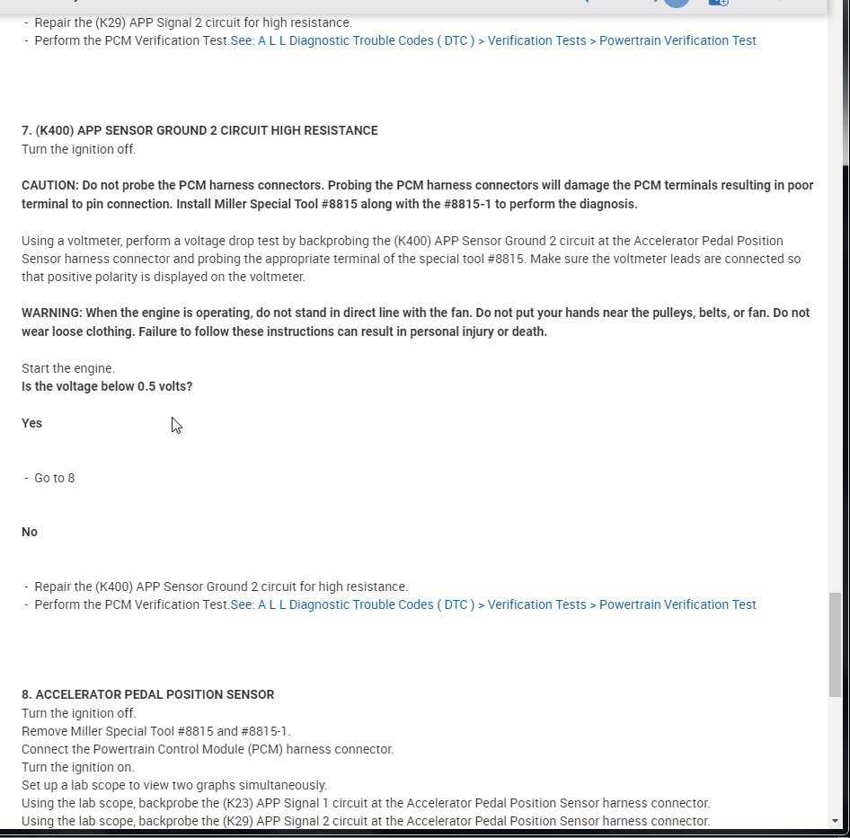

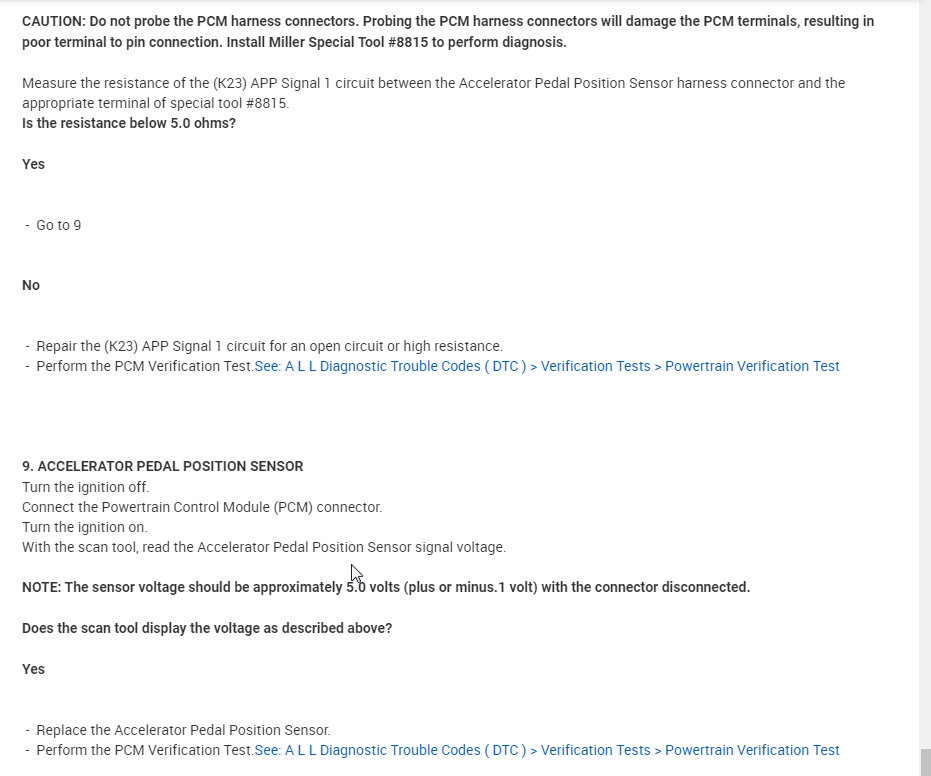

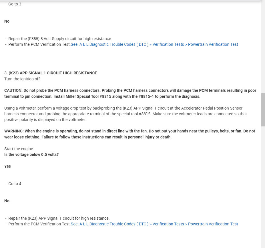

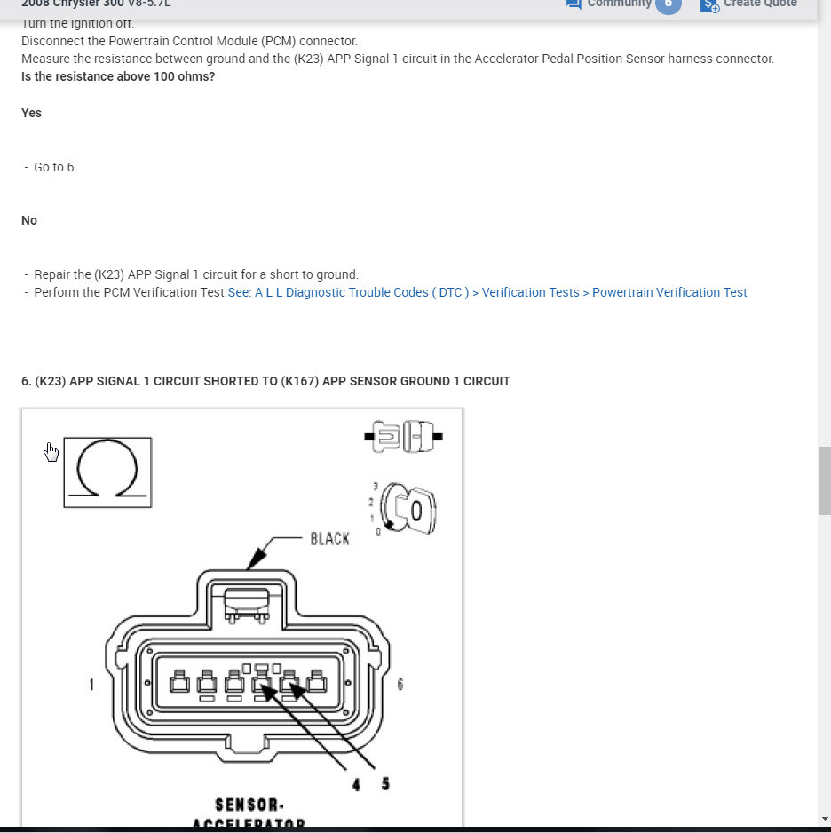

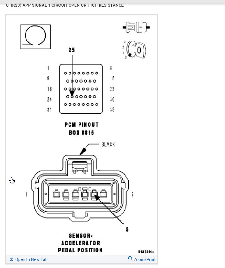

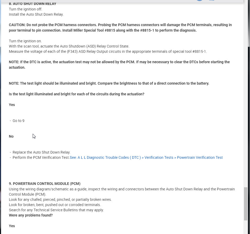

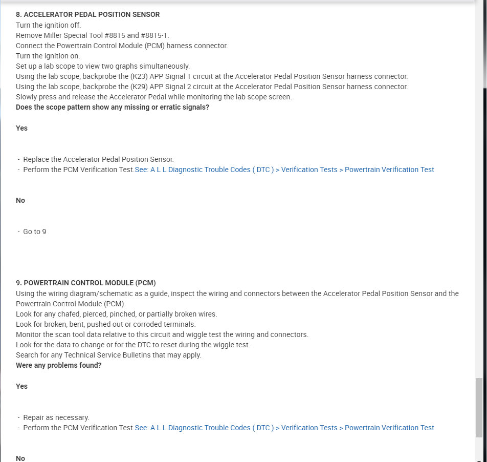

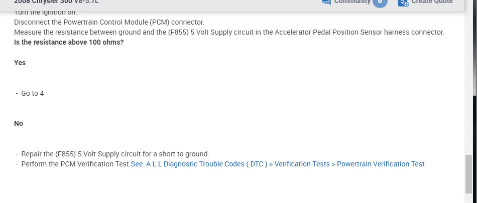

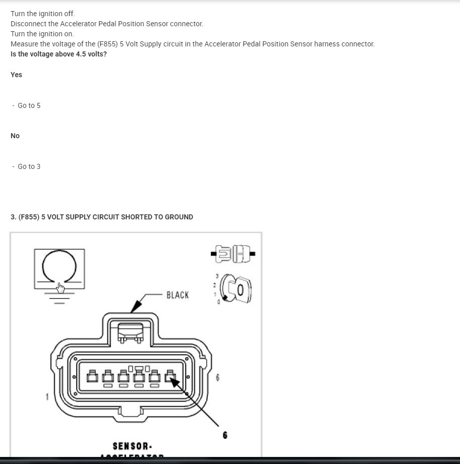

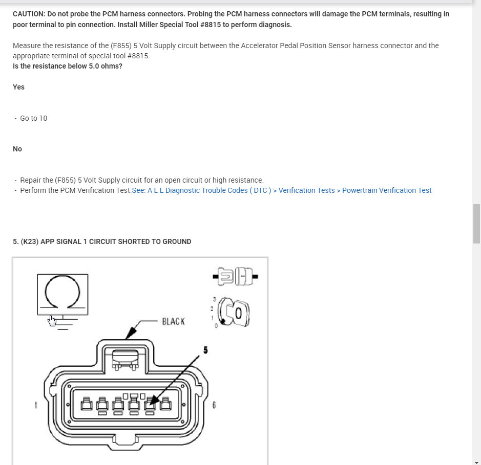

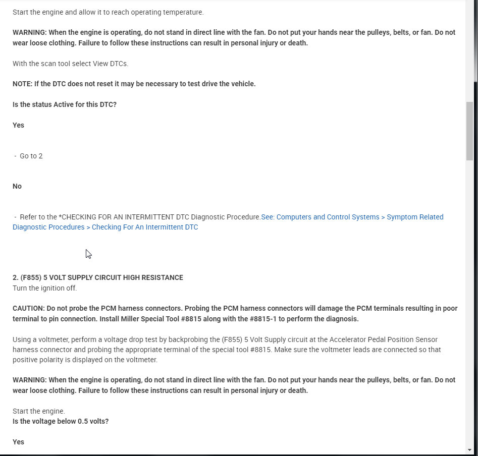

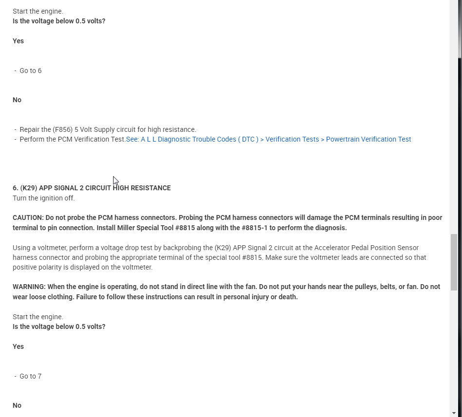

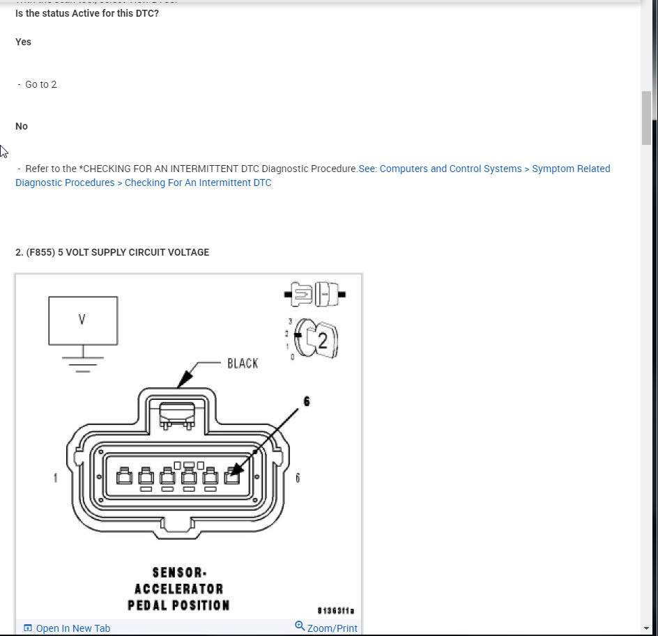

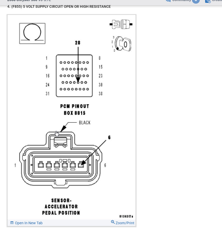

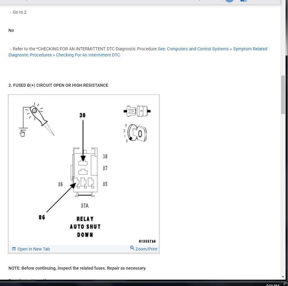

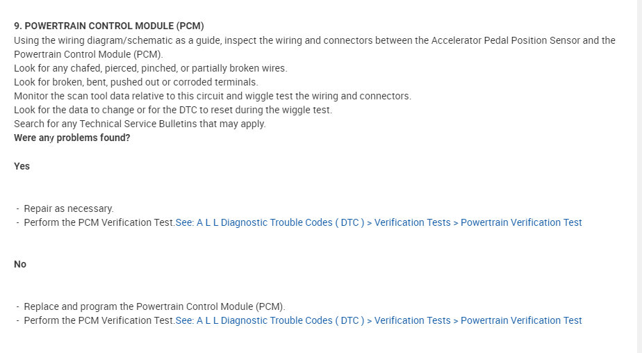

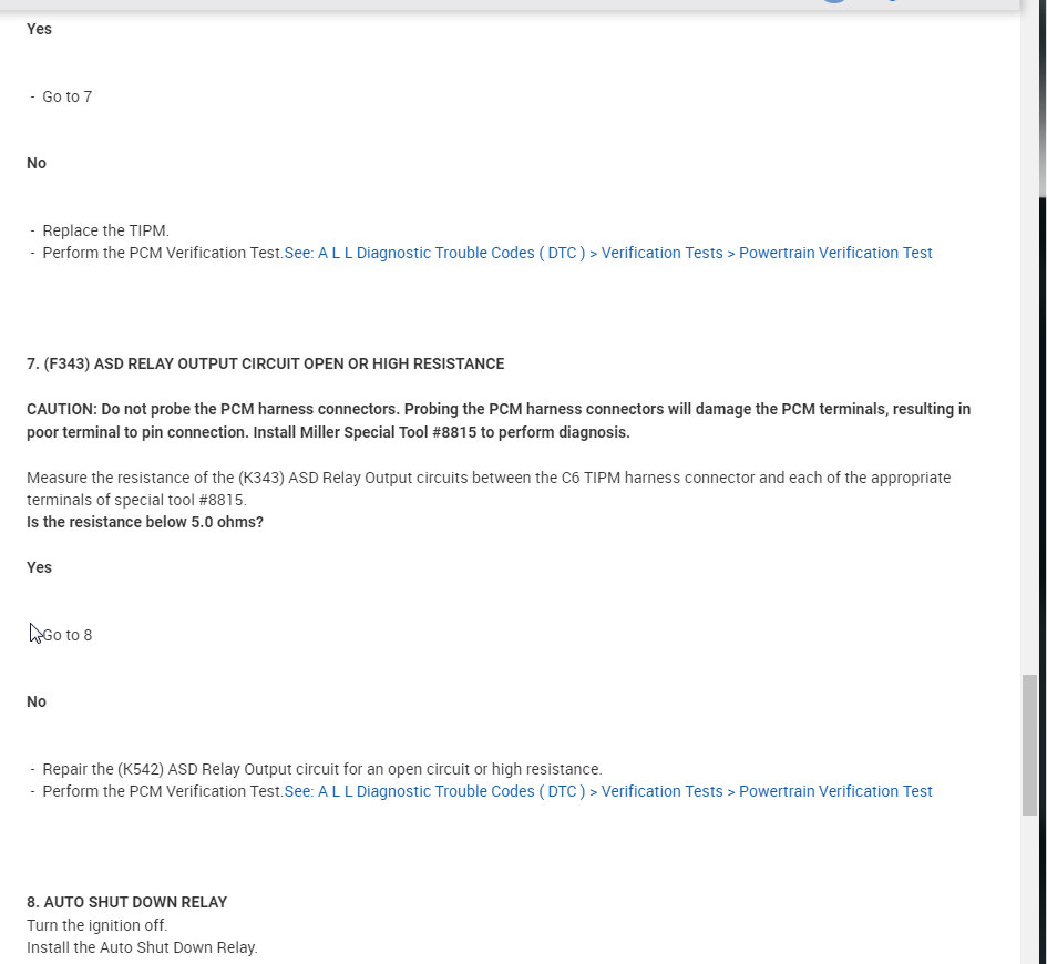

Okay. You more than likely have a wiring issue. I would take either the APP 1 code and run through it or the P2138 and I am sure you will find the issue. It could be the PCM but again, if it is wiring then you will not fix it with a PCM.

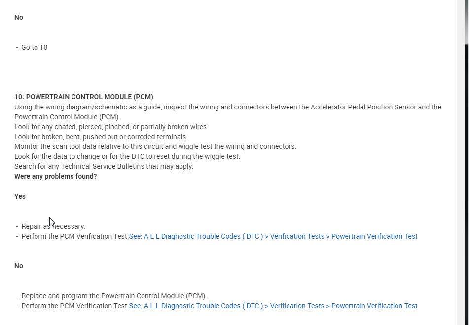

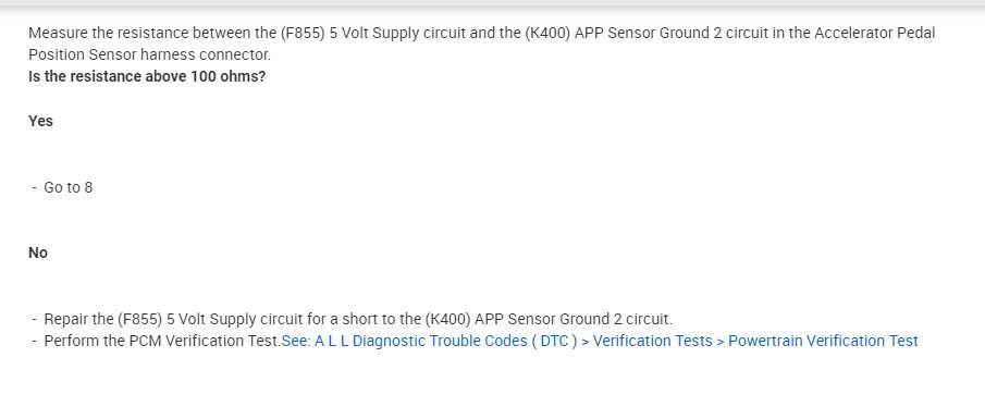

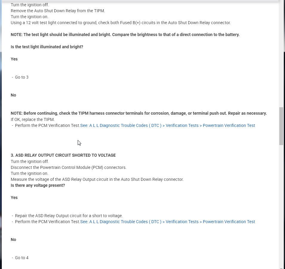

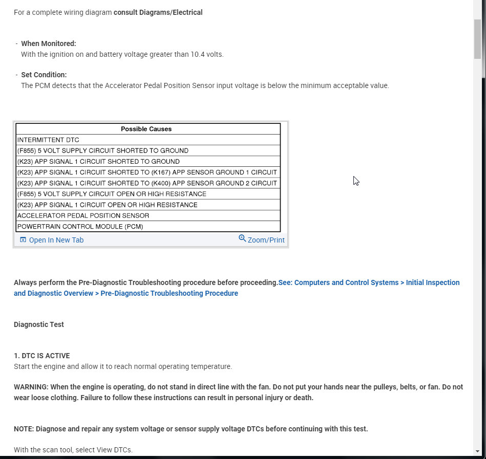

I attached the code detail for these codes. Again, run through the p2122 or the P2138 and I am sure you will find the issue for all of them except for possibly the P0688.
