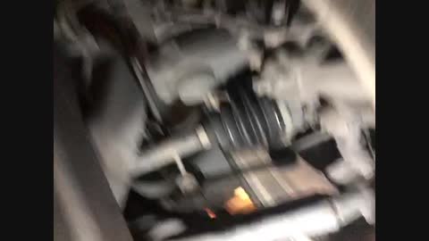

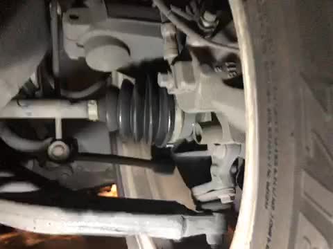

when jacking up both sides there is a movement on the 12 and 6 positions. I replaced inner and outer tie rods because i saw some play in them. now i am trying to figure out where this looseness is. only place i see it is in the wheel bearing. Does that make sense? And both front wheels are the sane way.

It can be wheel bearings, however most times it is related to ball joints. I can't see them in the video. Have you checked them as well?

I did but I don't see any ball joint movement at all, all the movement is around the axle when I move the wheel, for both sides, not even a little bit around the ball joints.

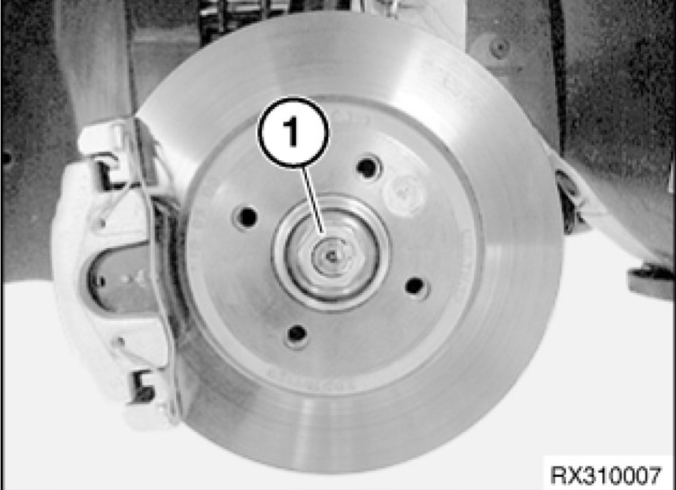

pic 1
Release collar nut (1), press brake pedal to floor for this purpose.
Installation:
Replace collar nut.
Tightening torque, 31 60 2AZ .
Important!
Secure collar nut after tightening down on flattened area of drive shaft by peening.
Necessary preliminary tasks:
- Remove brake disk
- Remove wheel speed sensor

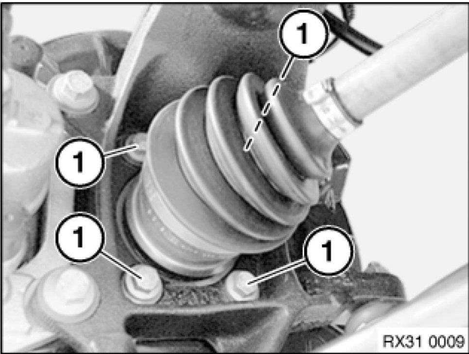

pic 2
Release screws (1) and remove bearings for front wheel.
Installation:
Tightening torque 31 21 2AZ .
Important!
