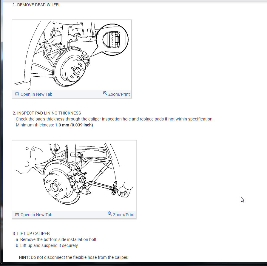

The problem is with rear brakes can I do it? Best regards.
Sep 19, 2017 at 5:13 PM

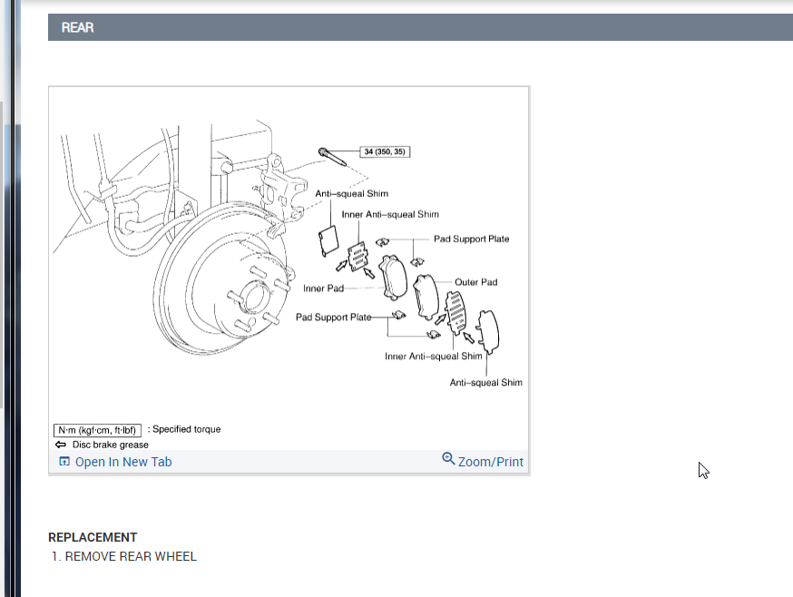

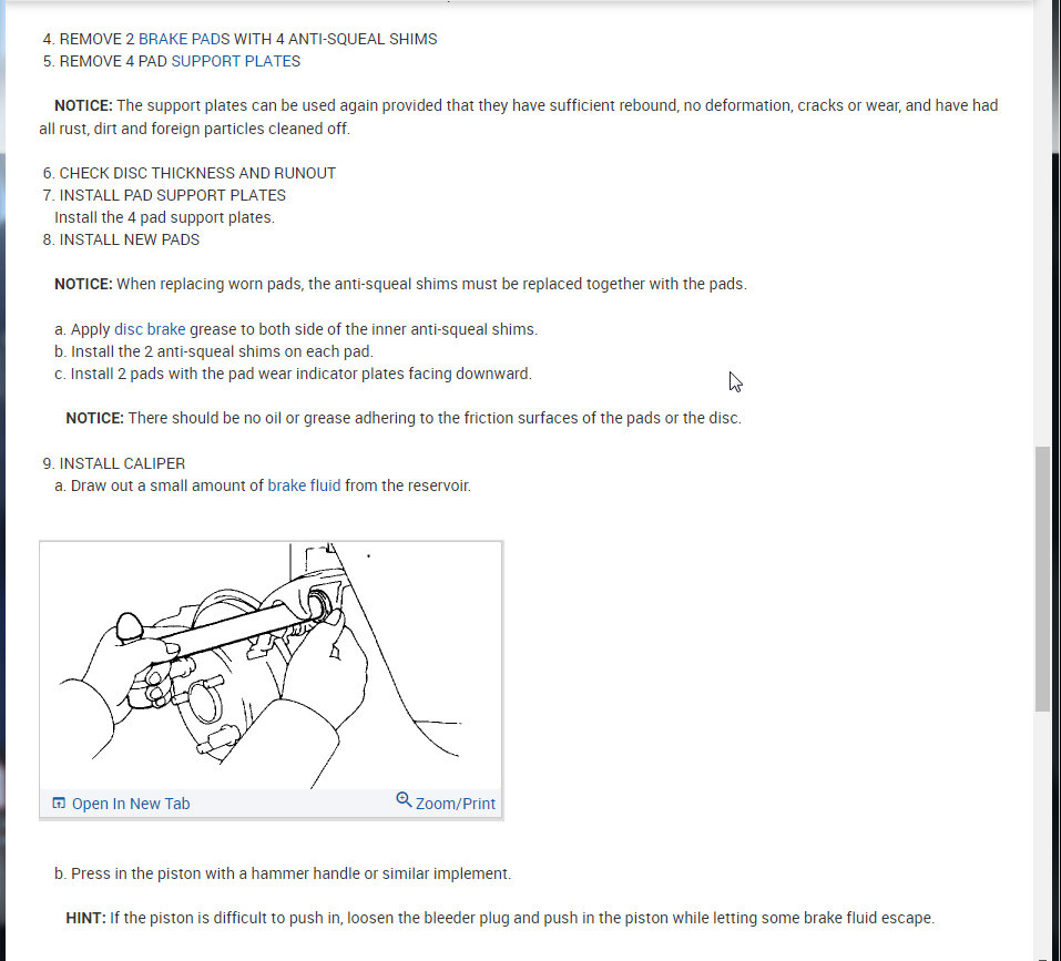

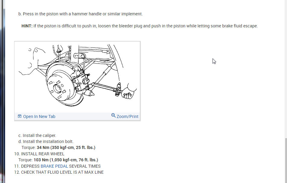

Here is a guide that will help with this:
https://www.2carpros.com/articles/how-to-replace-rear-brake-pads-and-rotors
Plus below is the material from the manual of a similar vehicle. We don't offer this vehicle here in the USA so we had to get a similar one to get the process. While this is a different vehicle the process is going to be the same.
Please let us know if you have questions. Thanks
