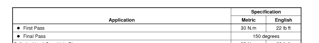

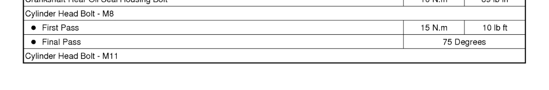

Sorry I have another question. I had to remove the head because of bent valves. Reading the Haynes manual it tells me to tighten to only 22ft.lb plus additional 150 degrees. Does this seem low?
Dec 7, 2019 at 6:29 AM
What is that? Spec for the head?
Dec 7, 2019 at 8:41 AM
Okay, I hope it was a typing error.
I attached the specs for the head below.
